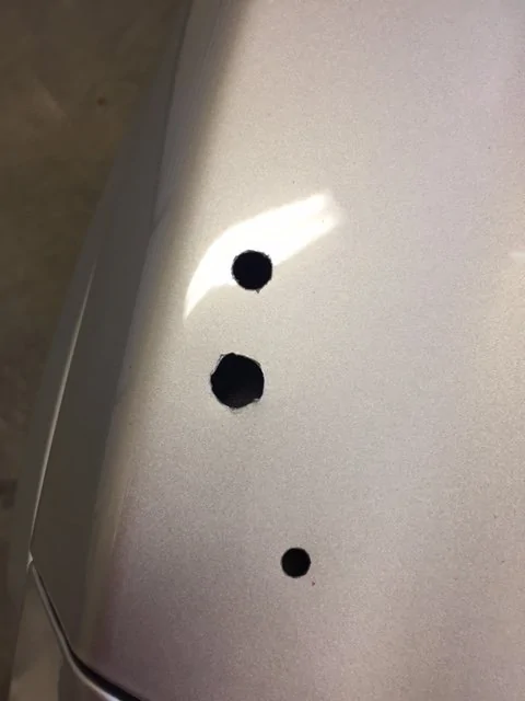

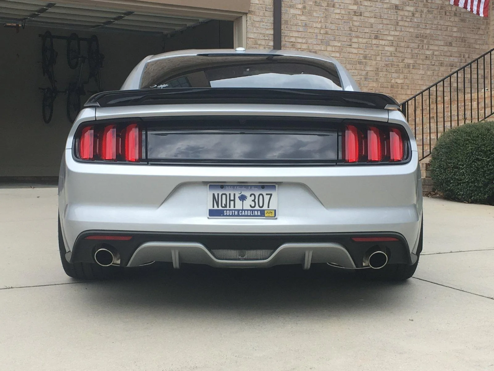

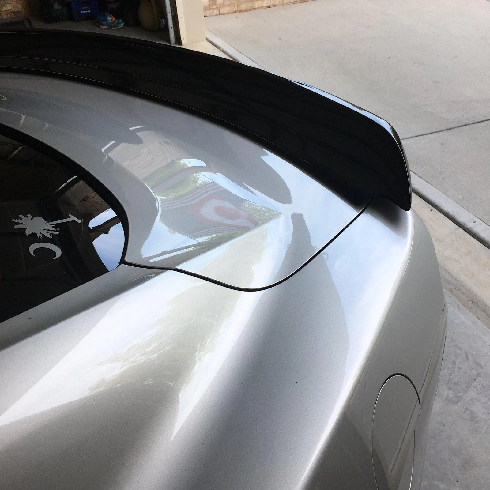

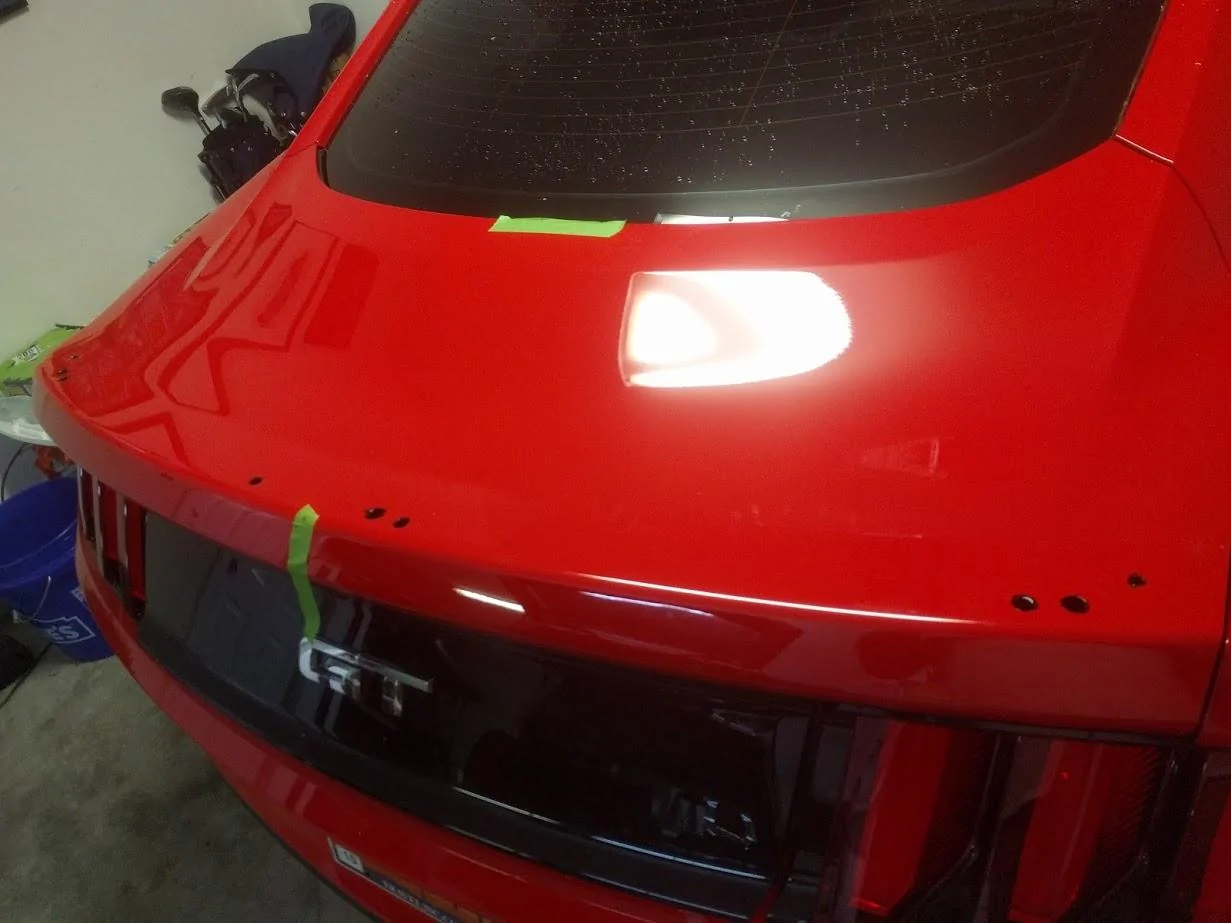

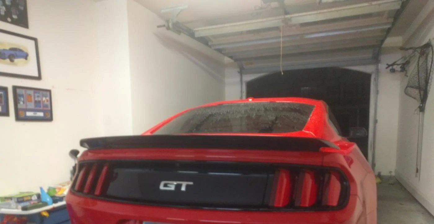

I installed my GT350 Track Pack spoiler last night (purchased from AutoNation White Bear Lake). Overall, install was pretty easy, though I still haven't unclenched my b-hole from drilling holes in a perfectly good trunk lid! I did find that a standard drill bit deformed the thin aluminum, and lead to the paint chipping. I switched to a step bit for all but two of the holes, and that worked much better.

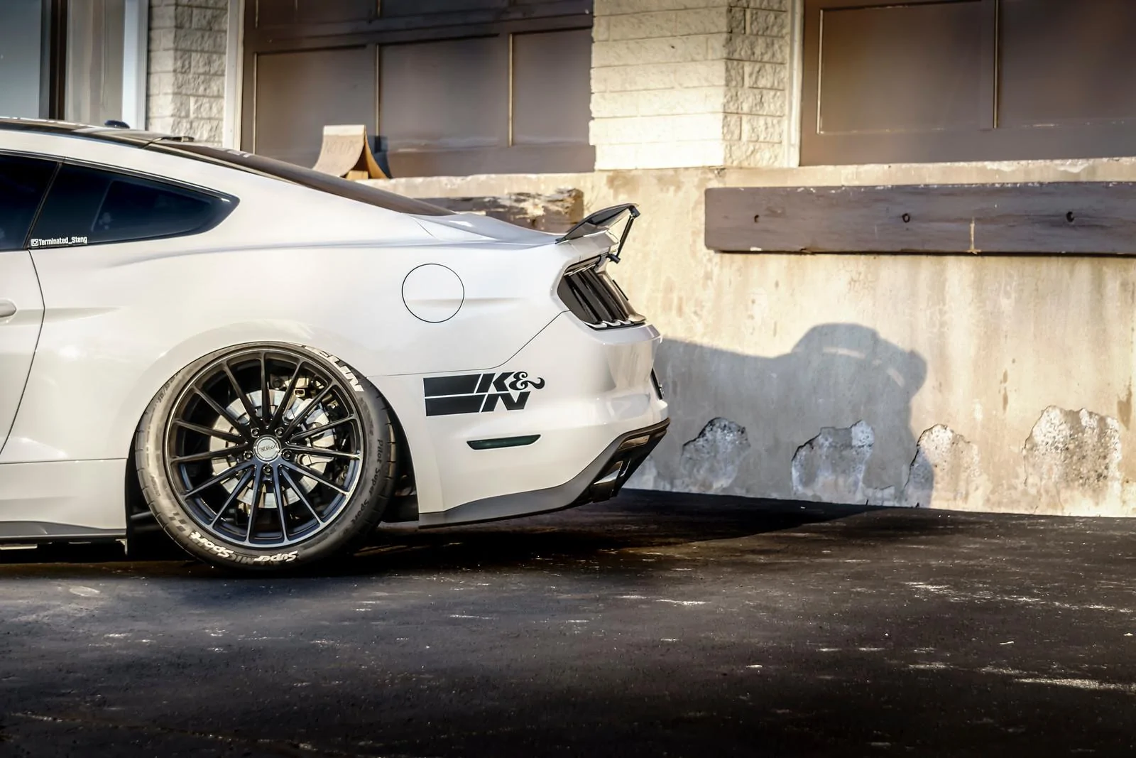

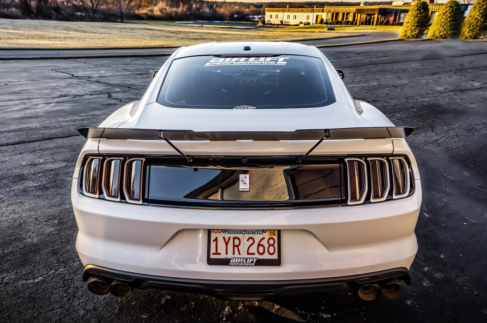

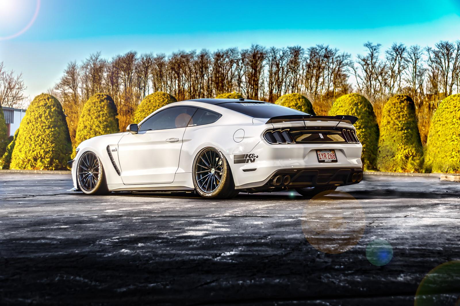

I finally get to post in this thread!
Spoiler is from 101Aero (@101blur on Instagram). Only change I plan to make is coating the support rods white.

:eyebulge: Pretty sic man:thumbsup:
101blur has got a sweet ride too.

Where can I find this wing, searched internet but I can't find who sells it Referring to the picture above, the 101 Aero

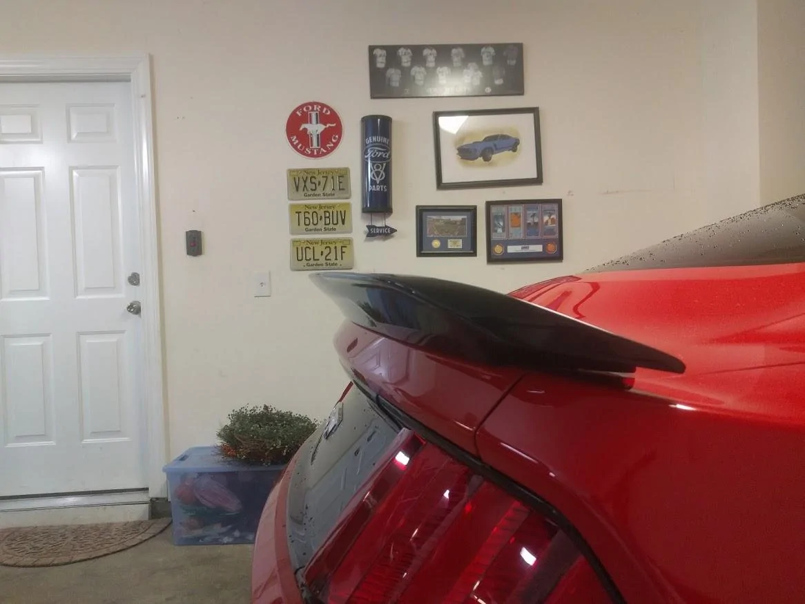

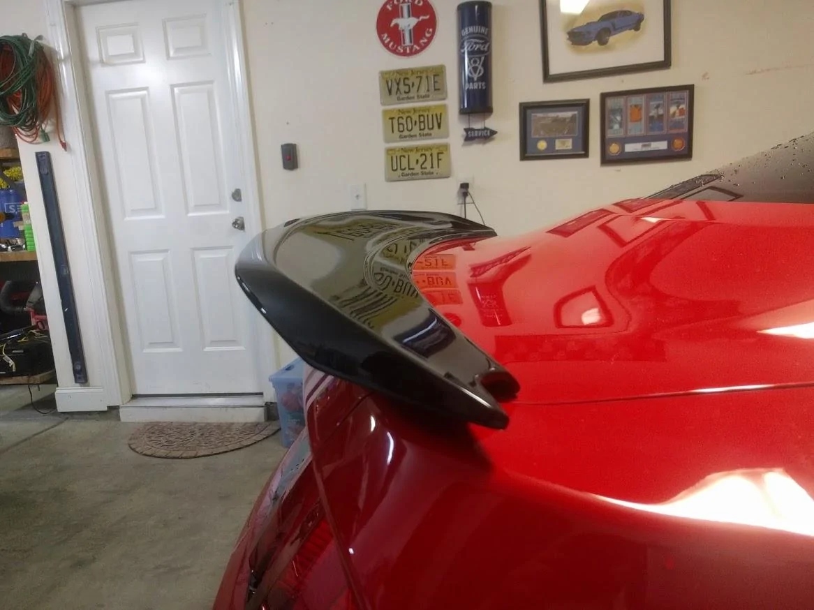

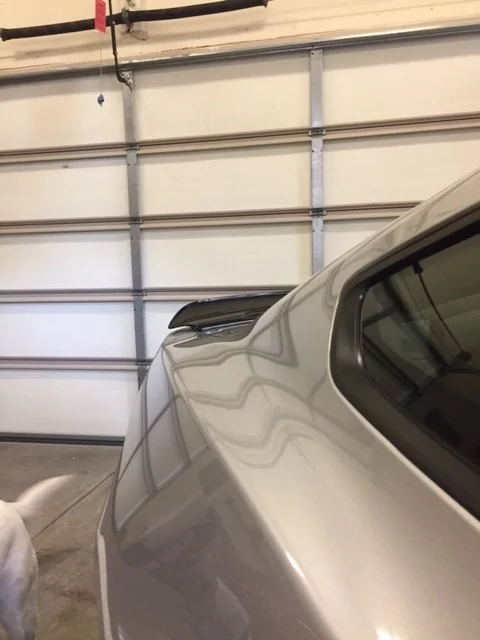

Well after looking forever, I finally decided on the Cervinis. To me, the body line are very important and I thought this complemented them best. Plus I've used Cervinis parts on my previous 2 Mustangs and the Fit and finish is always top quality.
I like the way that looks. I think I'll be adding this spoiler.

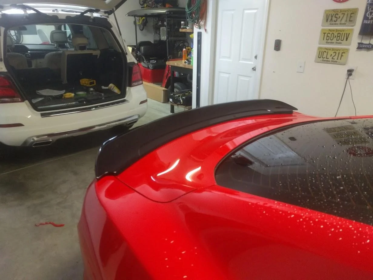

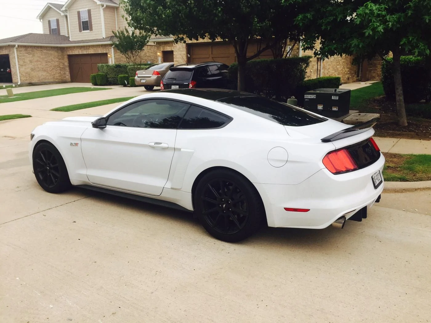

Nice pics everyone!!
Just installed the track pack spoiler on my 2015 EB over the weekend.
Took about 2 hours, and it wasn't bad at all!
What do you guys think??
(First pic I've posted on the forums)

I'm interested in getting the track pack spoiler, but didn't know if I would have to drill at all. I have an eco premium with the blade spoiler right now. It should be plug and play right? All the holes should mount up?

Yes, that's correct! It was a very simple install and a perfect fit. The most difficult part was removing the stock spoiler, but once that came off..it fit directly in the holes.

Thanks for confirmation! I think it looks like one of the best spoilers out there. :cheers:

looks good to me!
I am excited to find that spoiler fits without drilling, as I have an EB base that has the blade spoiler as well. thanks for sharing this info!

You're welcome! I had my stock spoiler wrapped in gloss black (it looked nice), but once I installed this one it completely changed the look!

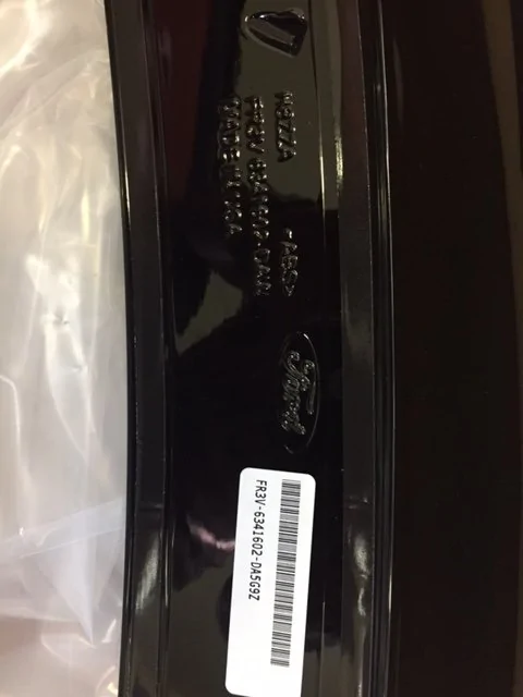

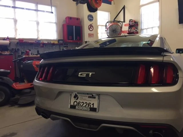

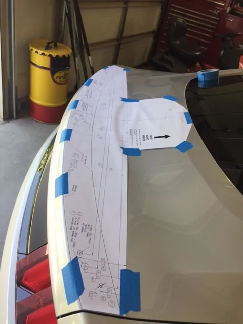

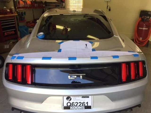

Received the GT350 Track Pack from Levittown Ford last night and nstalled it this afternoon. Instructions are pretty straightforward. Easy to install if you have basic skills. I think the GT PP looks pretty clean naked but looks equally good with the track pack on. It definitely changes the look of the car.
