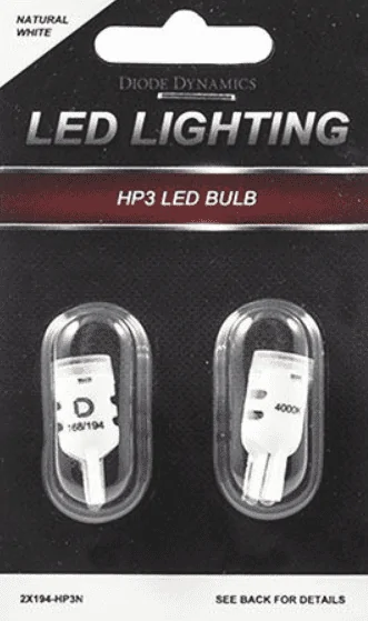

The interior lighting in this car is pathetic. I am considering the Diode Dynamics bulbs. I have heard that they are hard to install and many people have pushed the the socket into the housing. That in turn requires removing the overhead compartment. On the 2018 and up cars, this is very difficult to do thanks to a change Ford made to the mounting clips. Is it possible to install these bulbs without effing it up?

I did the ones in my 19, and I just took the whole thing down to do it. I don’t remember anything weird about it but I am used to the ones in BMWs and those are effing terrible to do. So it may just be my perspective.

CJ Pony Parts has a really good video, especially since they changed the map light housing for the 18+ cars

It's not a bad install with a decent set of plastic trim removal tools. Don't use metal tools on the map light. Here's my install notes: post #61

Ordered the whole Level2 cool-white kit off Amazon. Bright vanity lights be damned. The video that @MAGS1 posted clinched the deal. I ordered the 2017 version for a few bucks more but comes with a trunk bulb. But 2018 and up they started producing them with LED in the trunk. So I will have spare bulb if one goes out.

IMO it's not worth the risk of damaging the lens.. only to have a socket push into the housing.
Leave the lenses alone. Just drop the map light housing. Test the LEDs before reinstalling the housing.
Also, before reinstalling the map light housing:
Bend the 2 white mounting tabs back up towards the roof using the butt of a hammer. The map light will then seat nice and flush against the headliner.

I recall that I got mine installed without popping out the reflectors, probably by using gentle pressure because I already knew the risk. Maybe I wiggled the bulb back and forth during insertion. Perhaps you could retain downward pressure on the reflector at the bulb opening with a right angle pick.
If you do find up having to pull down the whole housing it helps to put on a headlight to light up inside while trying to get your head right up against the headliner.
I made a post some years back on this with photos. You could search for it under my username.

I think if you push hard enough on the socket (and you probably have to to seat the LED) there is the risk of the side tabs letting go. I saw how easy it was for Bill in CJ's video to pop the sockets out. I think a set of C ring pliers or maybe needle nose spread open to hold the tabs in place while the bulb is inserted could work. If not, I'll be taking your advice with the headlamp and bring down the housing. I'll post how it goes when I get them.
