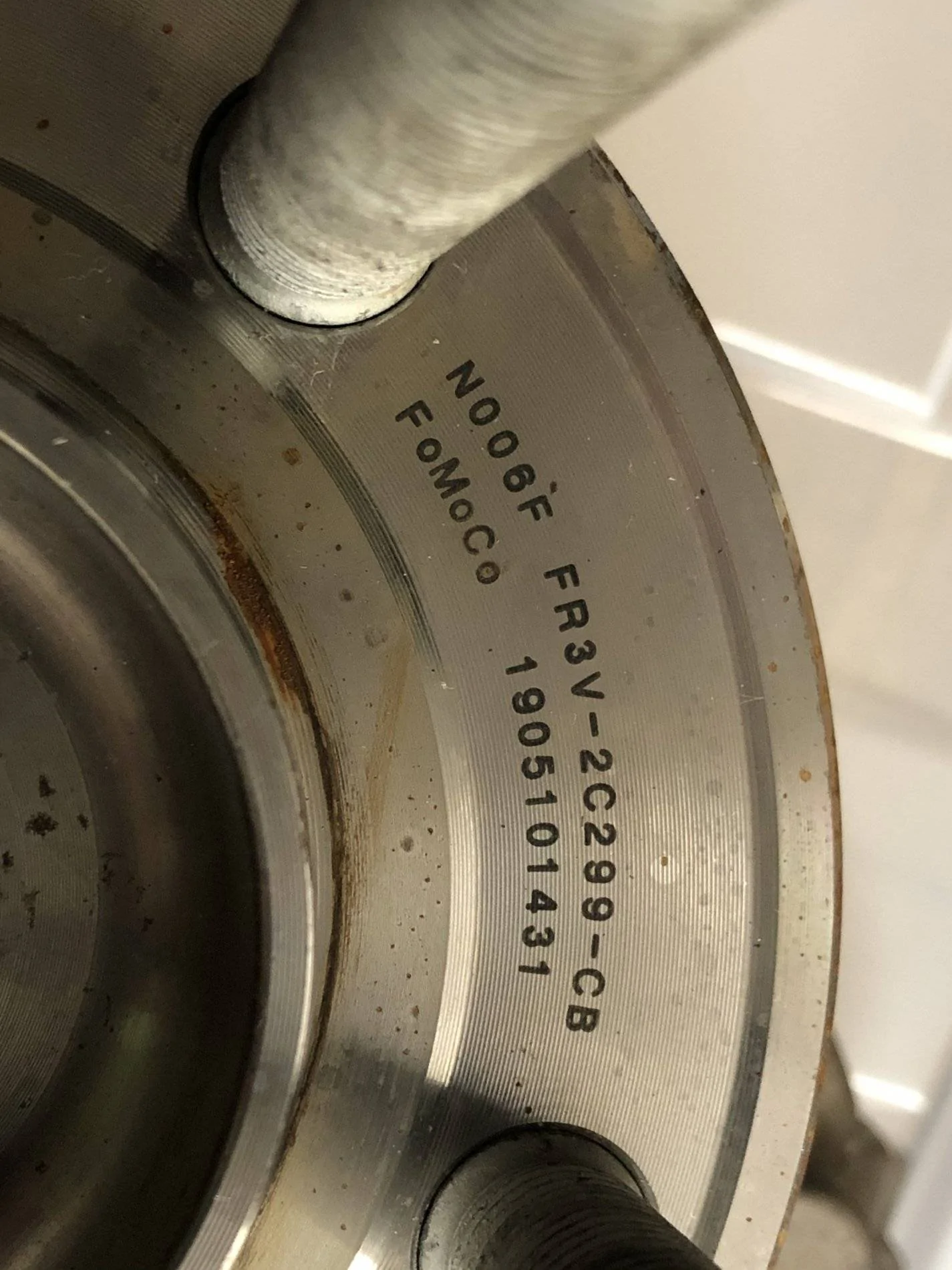

From a post by @lil'Zeus in "The Big Fat Track Car Cooling Thread", it looks like the PN for 2018 GT's with MR is FR3V-2C299-BC. My EBPP hubs are also splined, but I don't recall seeing a PN etched into them. I'll pull a wheel again to verify if EBPP's are the same as GTPP's and report back. Photo of the hub as taken by @lil'Zeus:

I think it must be the same as the Shelbys - enough that I bought a pair of '19 GT350R hubs off of eBay a month ago - I haven't taken them or my car apart yet, so no direct comparison, but the PN on the Shelby hubs is the same as the '18 MR photo above - except for the last two digits on the hub bearing. BC on the PP2, CB on the 350R. That may be a function of the 350R having super long studs already installed, though. Not sure.

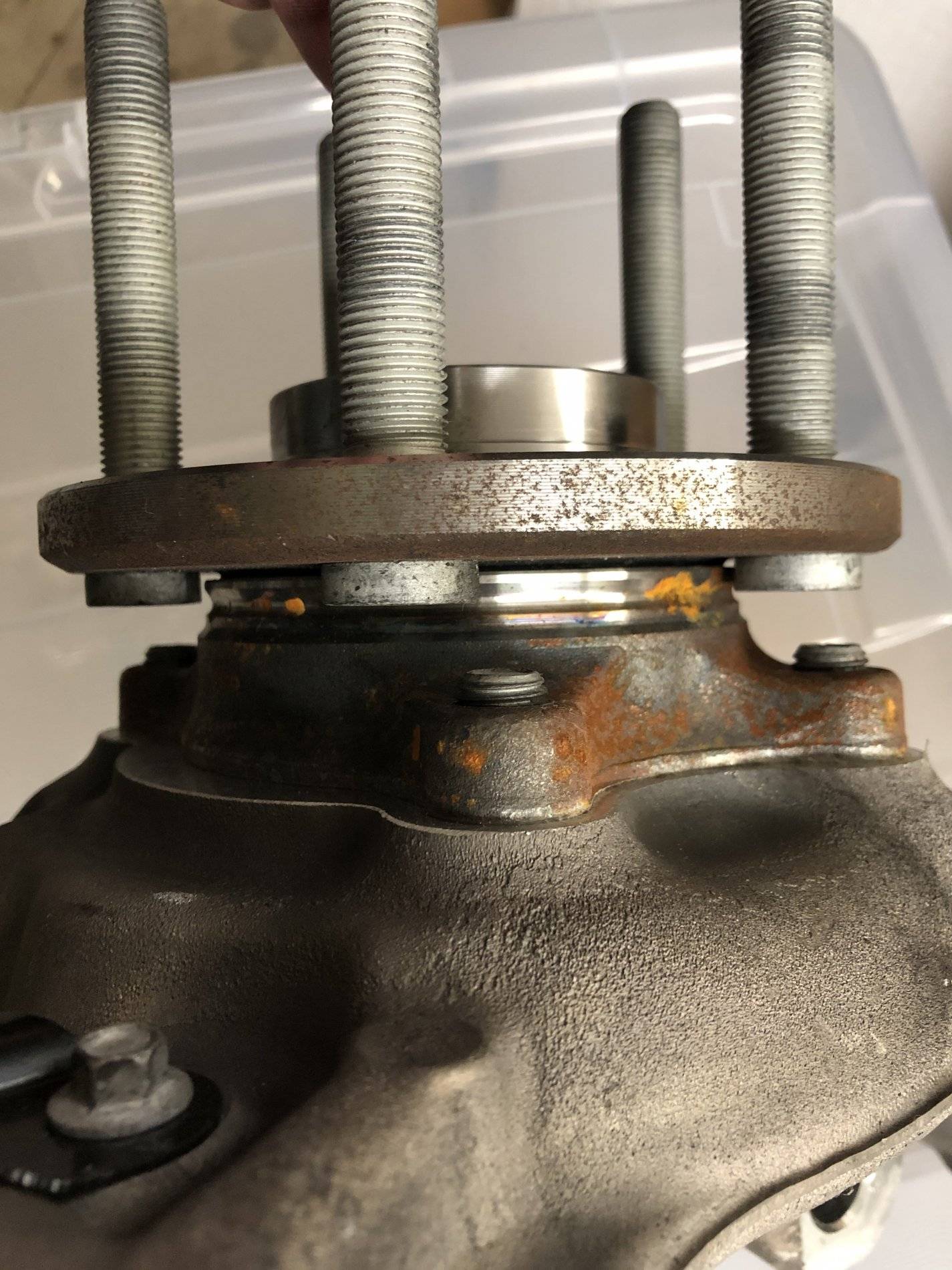

I finally got around to installing the '19 GT350R bearings in my '18 EBPP+MR spindles - everything fits like it was born that way.
Long Wheel Stud Conversion 02 by clair_davis, on Flickr

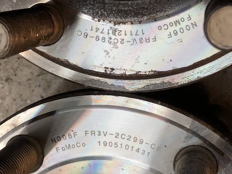

Other than the long studs, the only difference in the wheel bearings is the last two digits of the PN - "-BC" for EBPP on top, "-CB" for the GT350R on the bottom:
Long Wheel Stud Conversion 08 by clair_davis, on Flickr

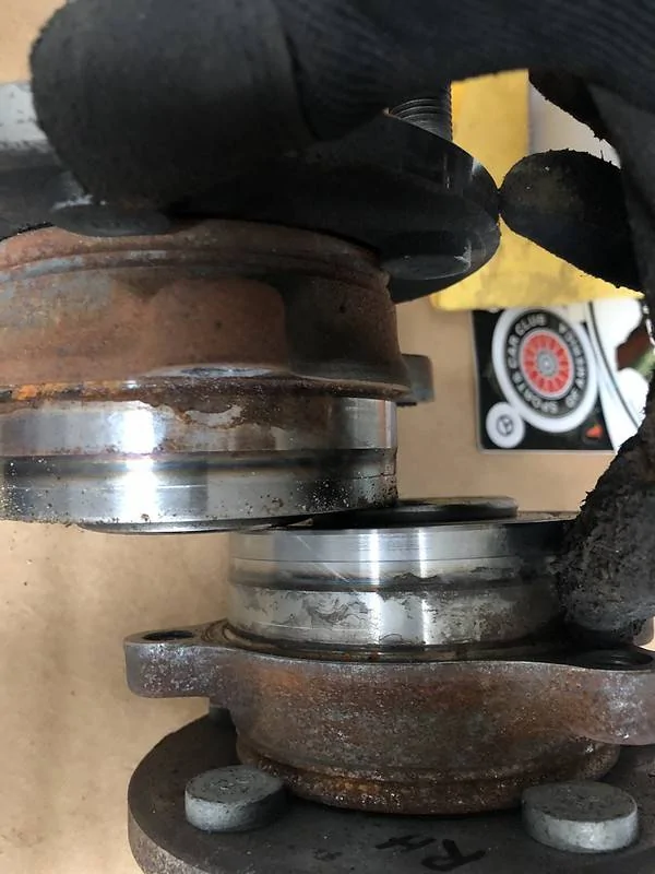

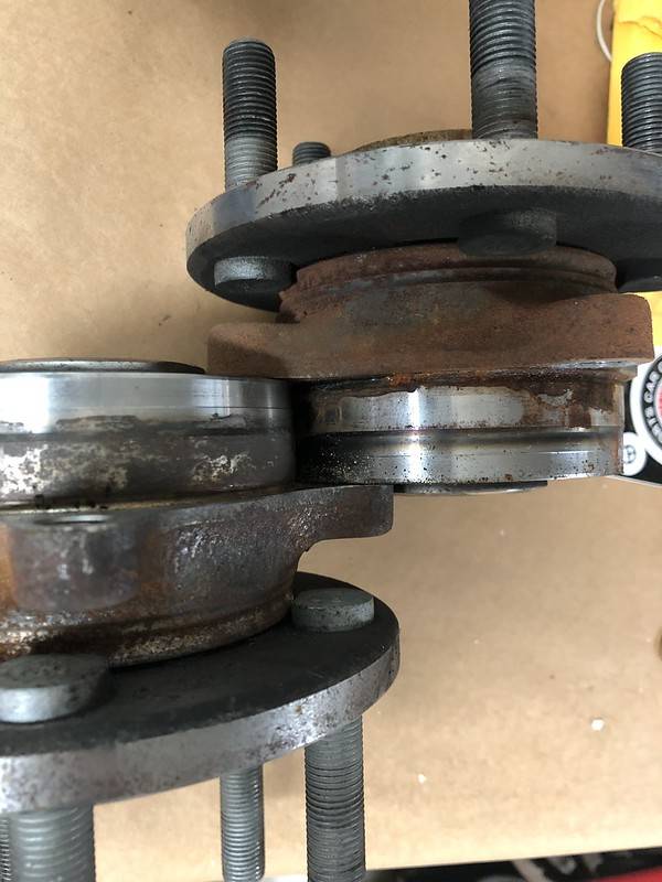

The bearing assemblies are the same, too - depth of the outer shell, as well as depth of the inner hub:
Long Wheel Stud Conversion 10 by clair_davis, on Flickr
Long Wheel Stud Conversion 11 by clair_davis, on Flickr

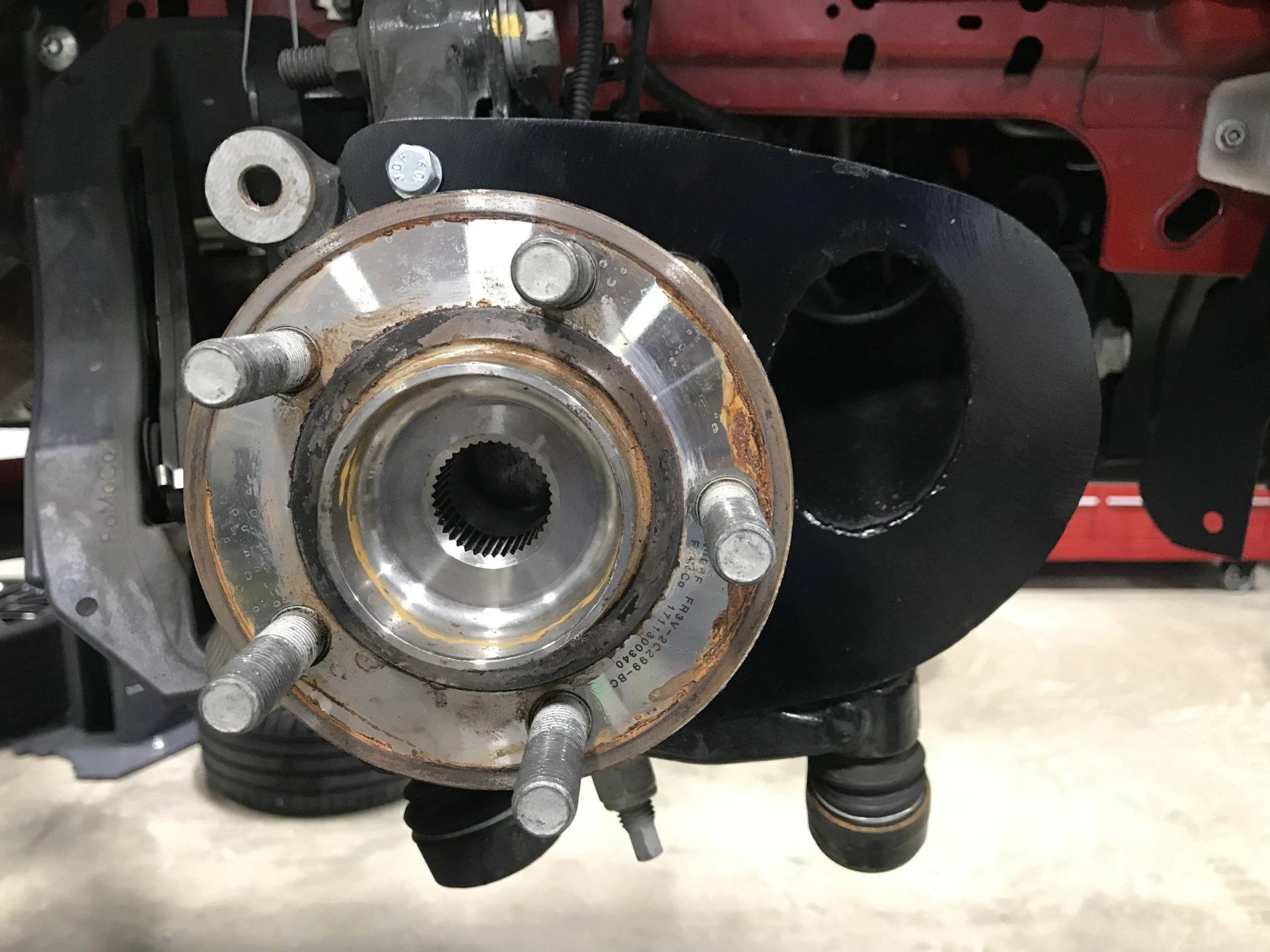

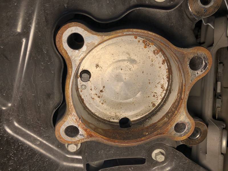

Inside the EB/GT steel spindle:
Long Wheel Stud Conversion 03 by clair_davis, on Flickr

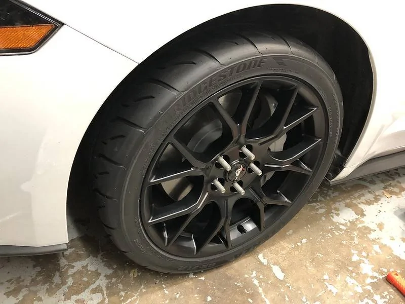

I've got some small diameter open ended lug nuts on the way that will fit my 11" wheels, so I'm running my original EBPP wheels with autoX stickies or now:
Long Wheel Stud Conversion 01 by clair_davis, on Flickr

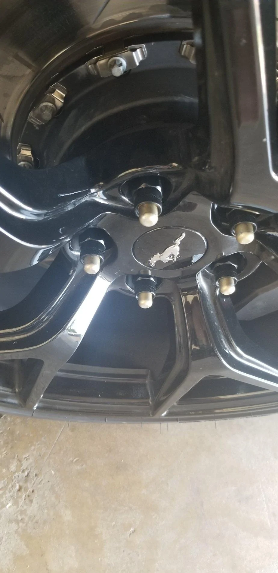

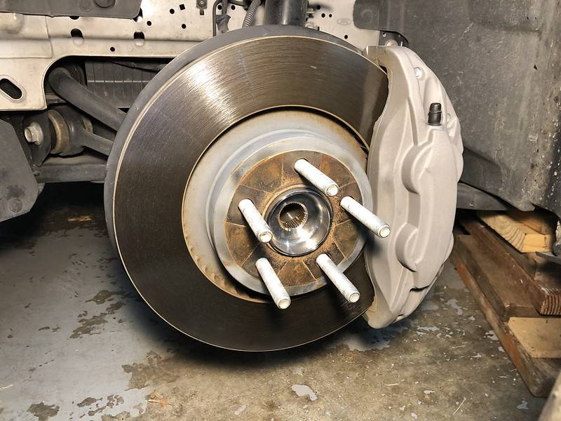

@TicTocTach I know this is an older thread but I found this in my research. I have a Bullitt with MagneRide and am looking to get away from the bolt-on spacers I currently use. I was wondering if there is enough length to these factory GT350R studs to accommodate a 1" spacer and stock wheels? Thanks!
TicTocTach
TicTocTach
Mar 15, 2018
983
1,010
DFWTX
Clair
2018 EBPP

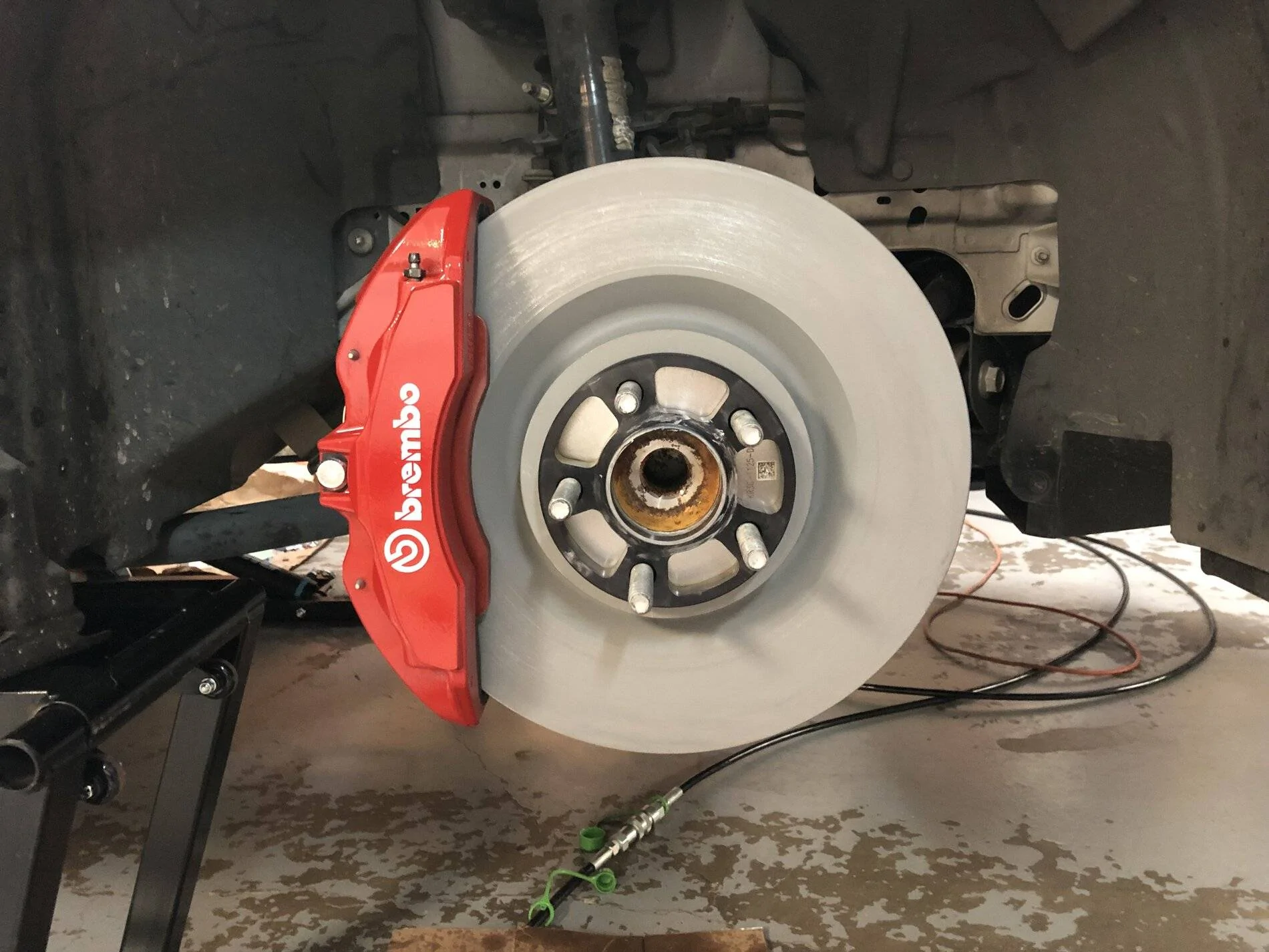

Totally… they’re like 4” long so you can go nuts if you want. Here’s a 20mm spacer on mine from the Brembo swap I did last week:
