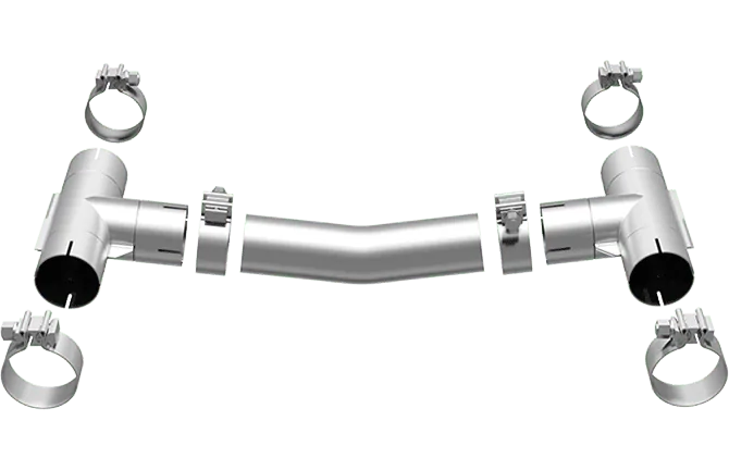

This is what you are looking for!...
This exhaust combo is offered on our site by following this link...
http://www.lethalperformance.com/sh...formance-2015-mustang-gt-exhaust-upgrade.html
If you have any questions about these parts, don't hesitate to contact us!
