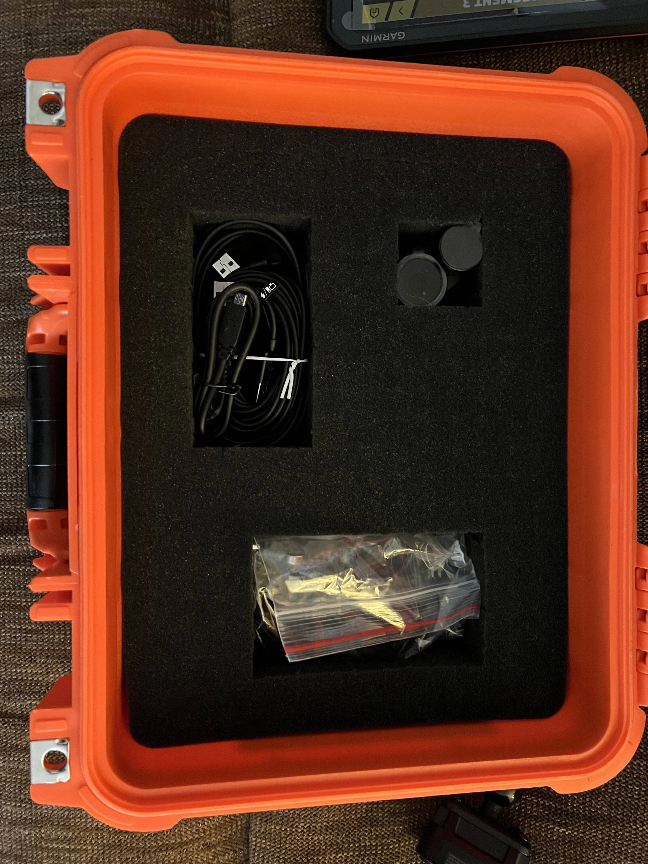

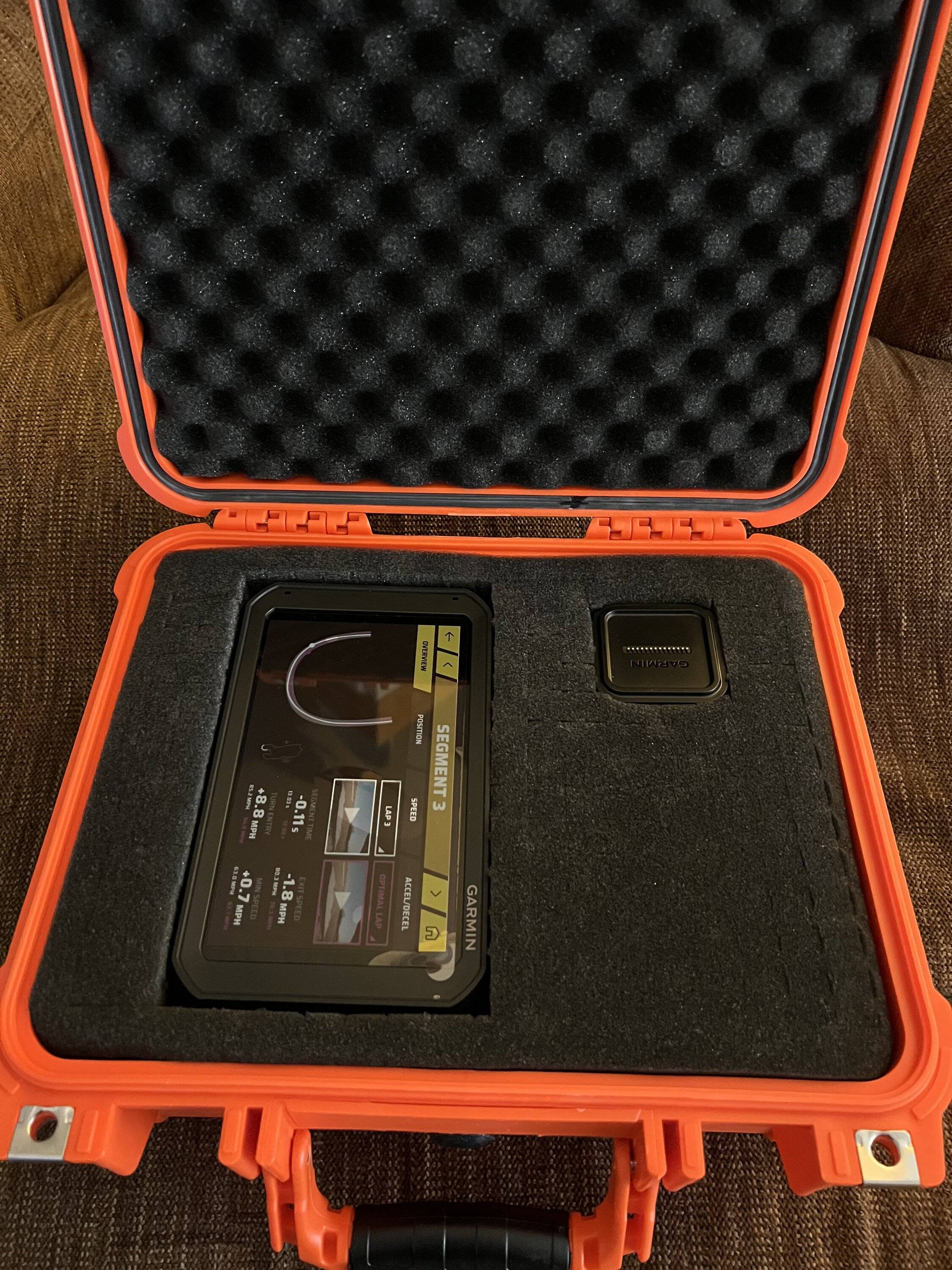

This arrived today……
Thank you @IanKar and @tosha.

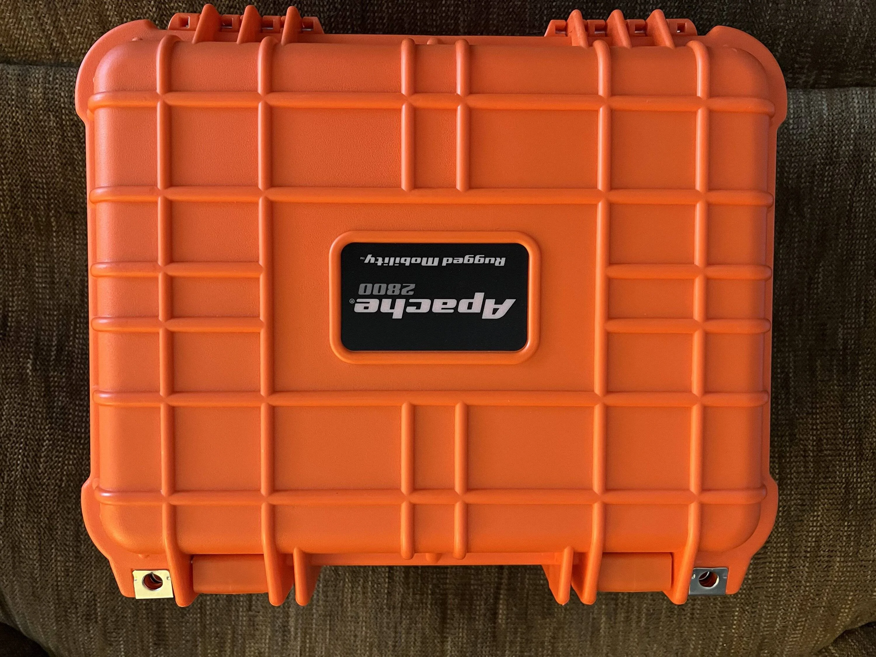

Harbor Freight is running a sale on jacks, so I’ll head over tomorrow to take a look. While I’m there I’m going to pick up an Apache (Pelican knock off) case, so I can copy this idea…..

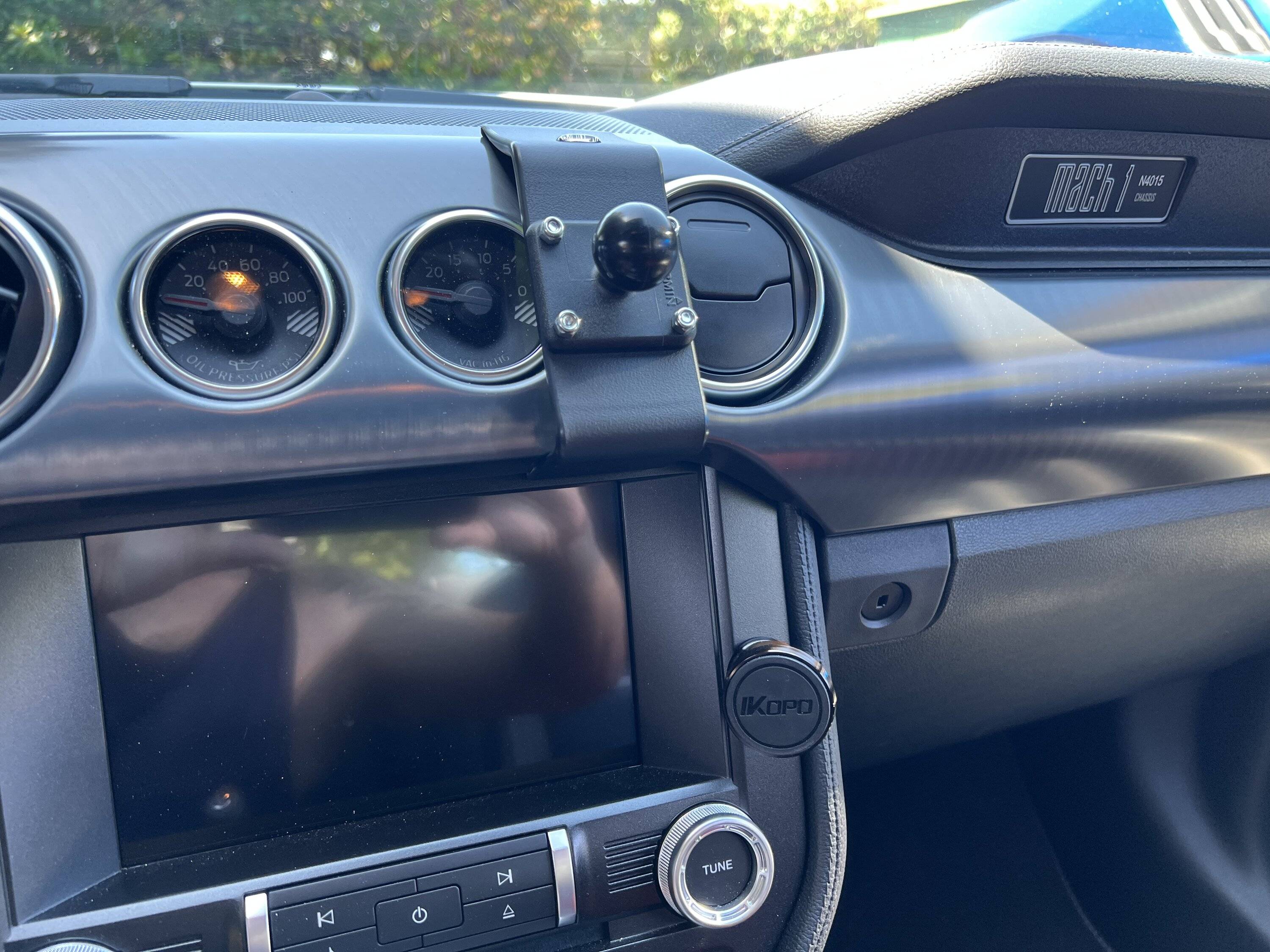

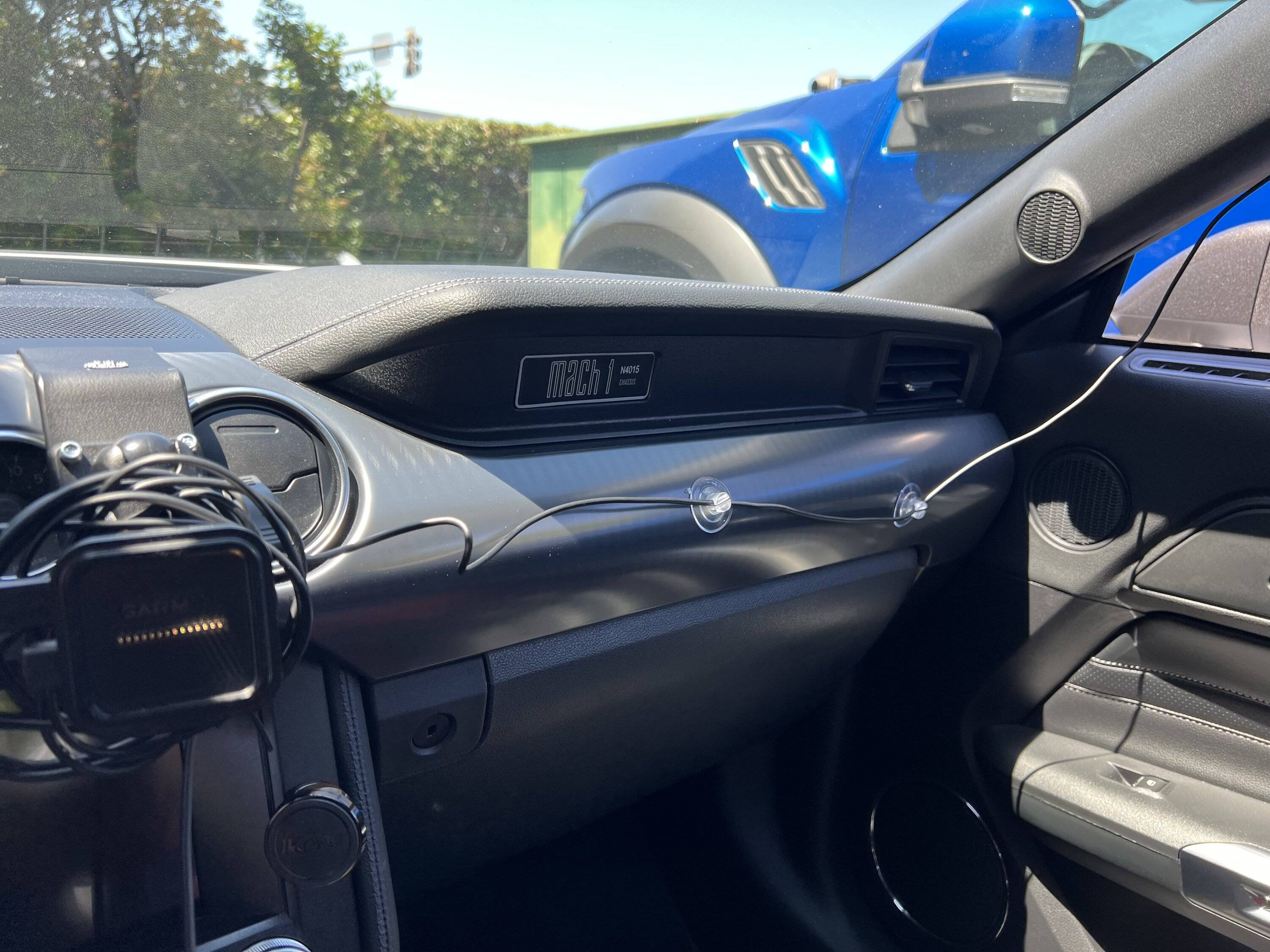

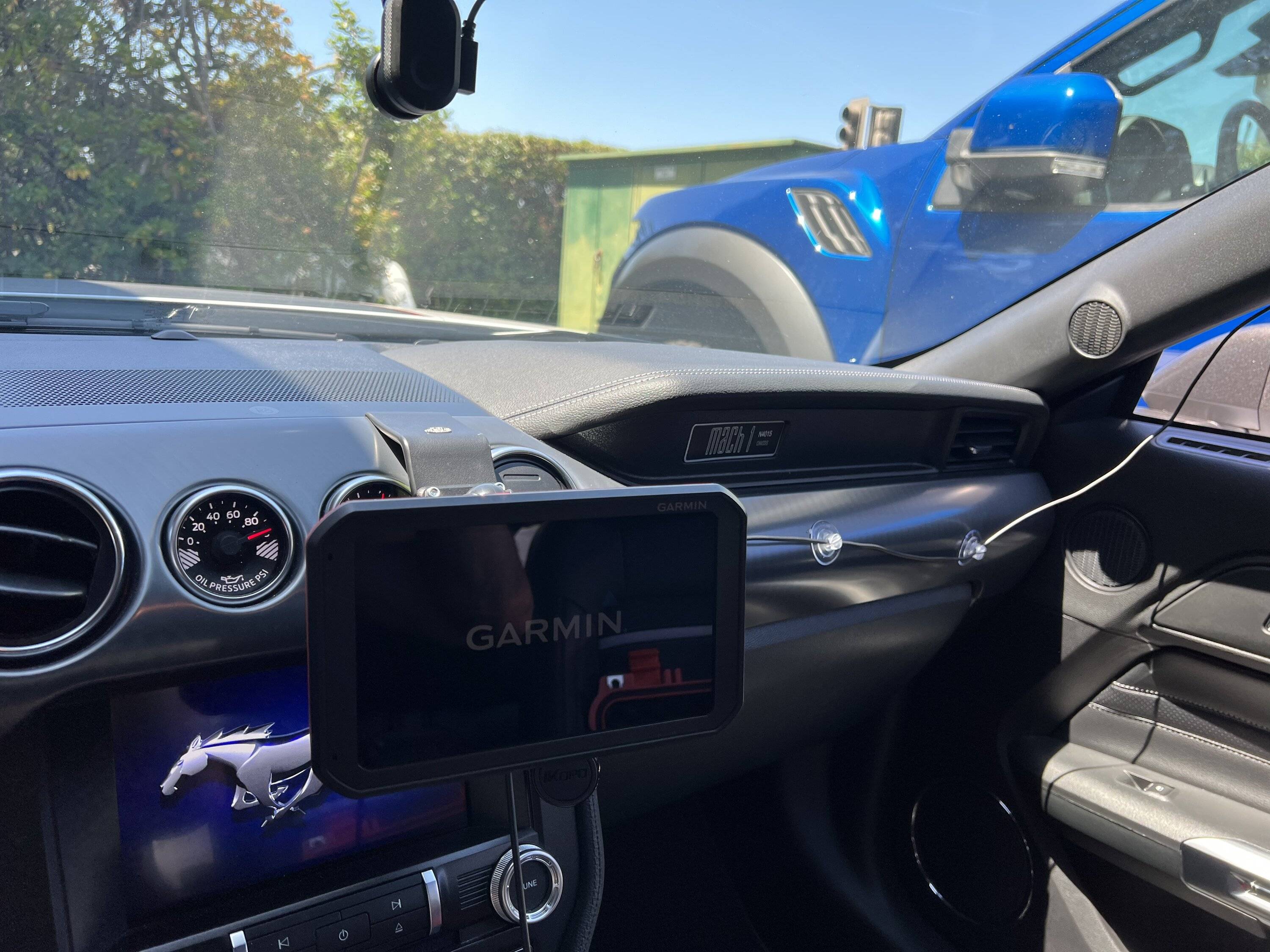

Test fit went well. ProClip suggested self tapers for their mount. No way that was happening. I reverse mounted some M4 screws counter sunk into the bracket and a small piece of cloth tape for extra protection.
When I mount for driving I’ll clean up the wire routing a bit, but this is the general idea.

That looks like a better mount. So the clip just snaps on? I think I'll do the same.

Yes sir. It actually snaps in so firmly it’s difficult to remove. I was worried about it hurting the dash, but ProClip has been selling this clip a long time and I can’t find any posts mentioning scratched or damaged trim, so figured I’d give it a shot.
https://www.proclipusa.com/products/855096-proclip-center-mount-ford-mustang-2015-20xx
You can use the base that came with your Garmin and M4 screws and nylocks.
Pro clip makes a Garmin specific mount to go with it, but it’s $35 and I didn’t see the point given 4 screws and nuts was $6.
https://www.proclipusa.com/products/216197-garmin-amps-adapter
And if you want to use the little suction cup wire holders for the cord (I didn’t want the sticky clips)…….
https://www.amazon.com/dp/B0BBLMC9C6?psc=1&ref=ppx_yo2ov_dt_b_product_details
and the Garmin suction cup for the camera…..
https://www.amazon.com/dp/B0C25XRPVB?psc=1&ref=ppx_yo2ov_dt_b_product_details
It took about 5 min to put it all in, and about 10 to put it all away.

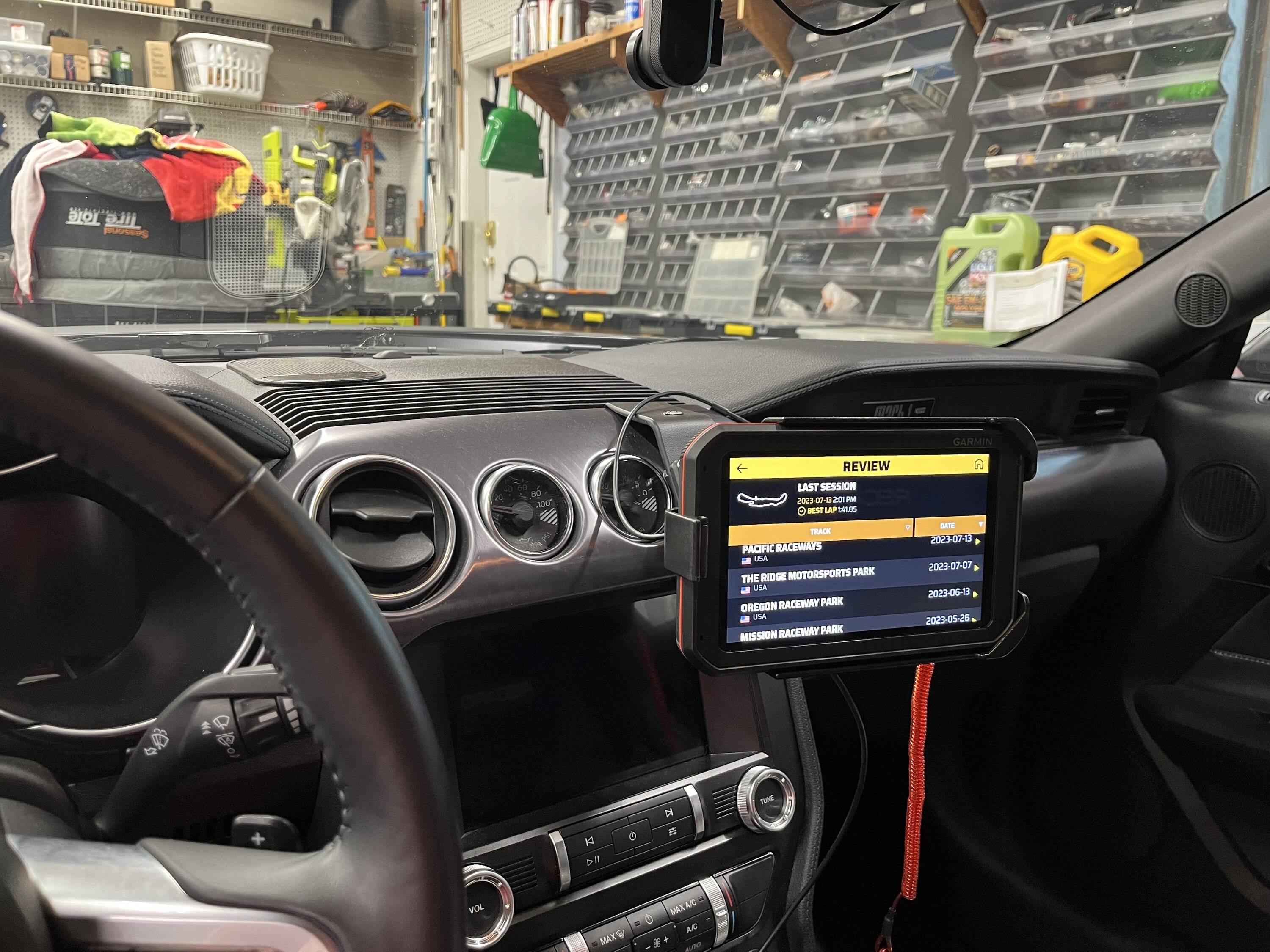

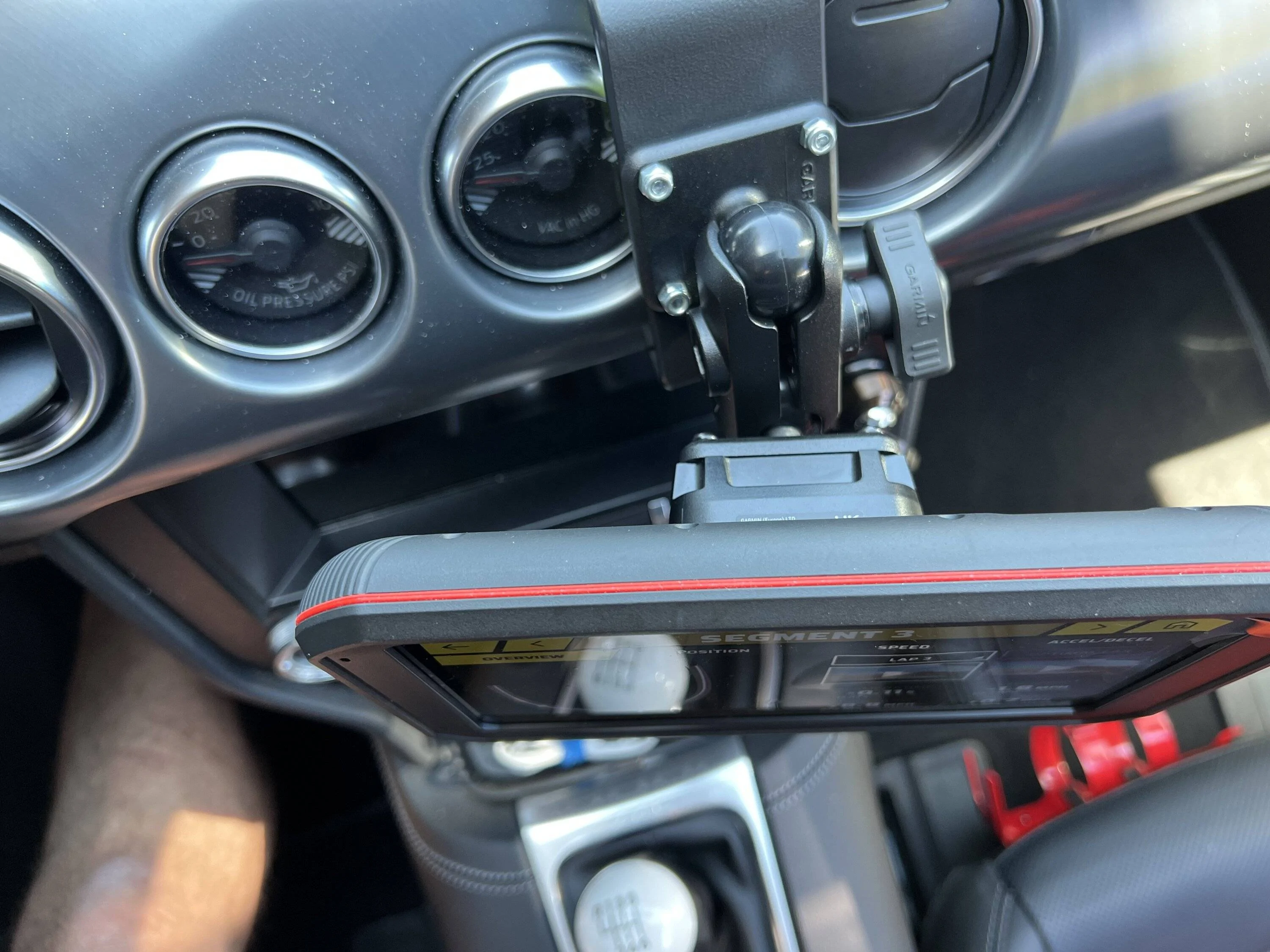

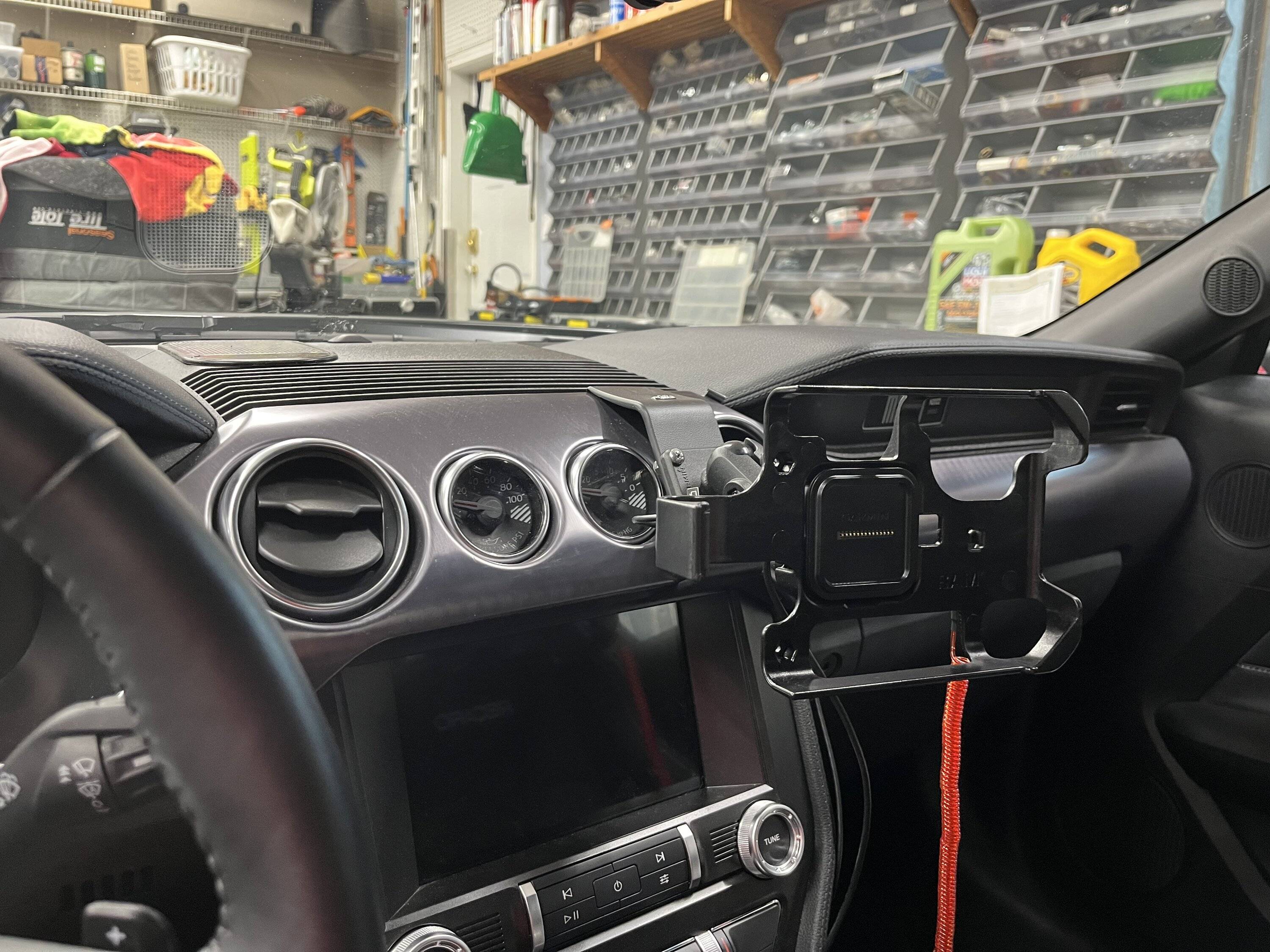

Proclip arrived and continued to us my cage. Now I have the full view out my windshield. Thanks Chuck!

That looks really good. No worries, appreciate all the help you gave me, so glad this met your expectations.
Be careful takin it off, that little sucker clips on super tight.
I see you were braver than me and did your screws the correct direction. 😂

Yeah, I shortened the bolt so that it wouldn't protrude too much. If ever they work loose (but shouldn't, as I used a nylock nut), this way I can still fit a spanner on the nut and star screwdriver from the front and tighten. I don't intend taking off the clip. I hope not.

Like the suction cup idea
