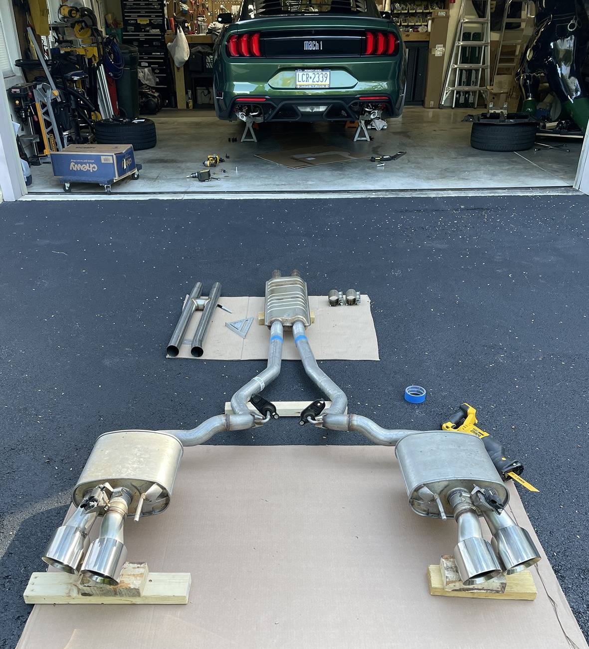

Here is a great video that compares the Steeda X and H pipes directly in each of the different exhaust modes. The sounds are pretty similar regardless of what brand you buy. (67) 2021 Mach 1: X-Pipe vs H-Pipe Resonator Delete Exhaust Sounds - YouTube . I did the H-Pipe install by myself in my garage using jack stands, basic hand tools and a reciprocating saw. I'm a big fan of removing the exhaust and doing the cuts off the car. If you look in the attached photo, the secret to my success was using a furniture dolly and a cardboard box to catch the exhaust when I pulled it free from the car, then I just wheeled the whole thing out to the driveway where I carefully made the cuts, then reinstalled everything in pieces on to the car.

Perfect. I drive in track mode most of the time and that’s what I’m looking for. Thanks for all the input guys.
