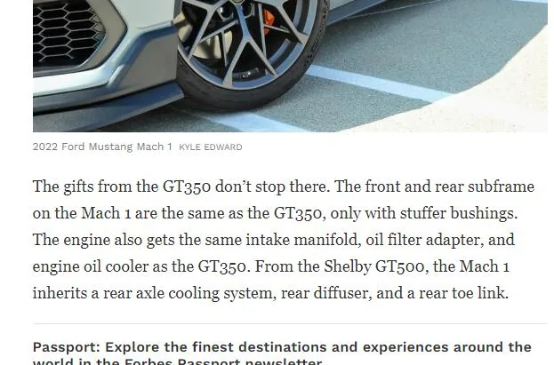

Where did the Mach 1 (21-23) get its subframe from? I have looked and I have found everything from the Mustang GT to the GT500 as possible.

Steeda lists the rear sub as the same as the GT 350. I believe the front is standard GT

Summary so far:
front is Mustang GT
rear is GT350 per steeda
rear is GT500 per Ford press release
Toe links is from GT500

Ok now for the really stupid question - what all encompasses a front and rear sub frame on these cars?
Front sub-frame is what all of the suspension bolts to, the steering rack, and the engine mounts to.
Rear subframe supports the rear differential, rear suspension.
Since these cars are unibody, sub-frame assemblies were developed to mount all of this stuff to. Any unibody vehicle has subframes, since the vehicle itself doesn't have a traditional frame capable of supporting the weight, torque etc. of all the drivetrain and suspension stuff
