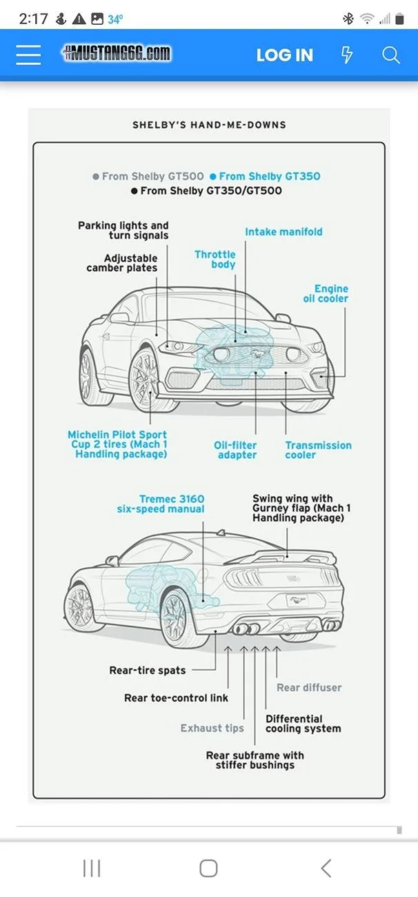

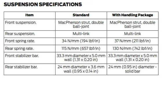

Some attachments, to compliment the existing discussion.
