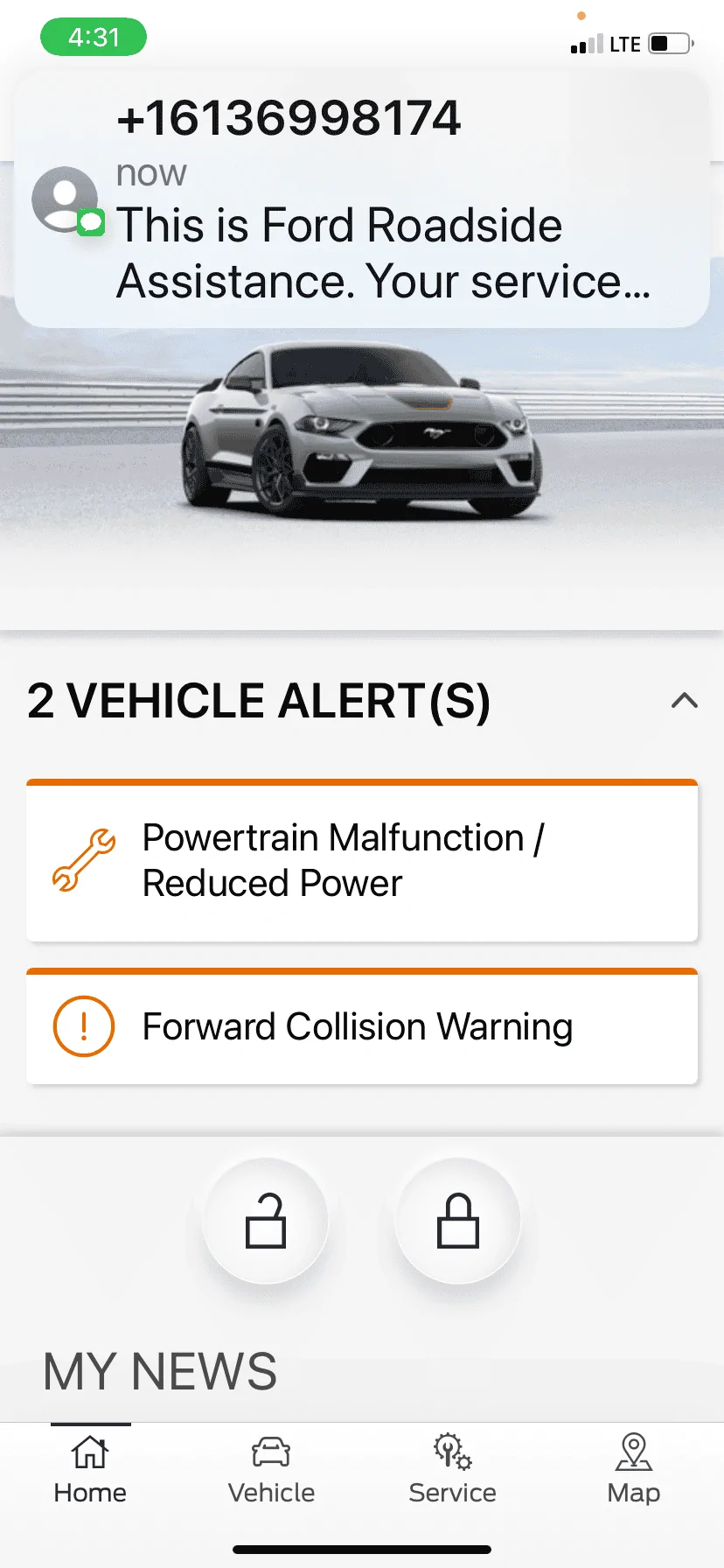

I just had my '21 Mach 1 go into Limp Mode with powertrain and forward collision warnings... Called Roadside Assistance and waited for the tow when a friend called me and told me to try restarting the car 3 times and after the 3rd try, bingo it started with no warnings and the car was able to drive home normally. I will contact my dealer and see what's what... Are there any recalls that I am not aware of? Anyone have the same experience?

I just got the car back from the dealer and here's the scoop. They found no other fault codes other than the original issues that were logged. They connected a VCMII and FDRS to the car and updated the PCM with the latest calibration... They clear the fault codes and road tested it... Should be good to go, so they say... I am supposed to monitor it but how I am not sure other than going into limp mode at the side of the road!

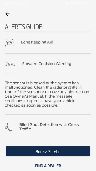

@ACMEguy The thing in the log about the forward collision is it really just a record of the warning which happened to you during driving, or is it about some problem with "forward collision warning" system?
I can apparently answer my own question. The log entry in the mobile app means that there is a problem with "Forward collision warning" system. This is what the app says about it.
It does not sound like the shop did anything of that.
