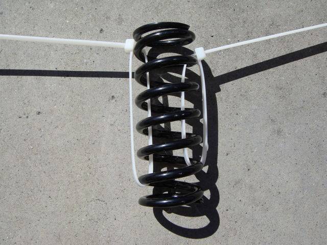

lol, if you haven’t tried this at least once before you acquiesce and buy a dam strut/spring compressor…we cannot be friends 😂
If that’s you, you’re ballsier than I!
We’ve got other economy cars in the family that I’ve got springs onto just pressing it all together with the strut towers and LCAs LOL.
