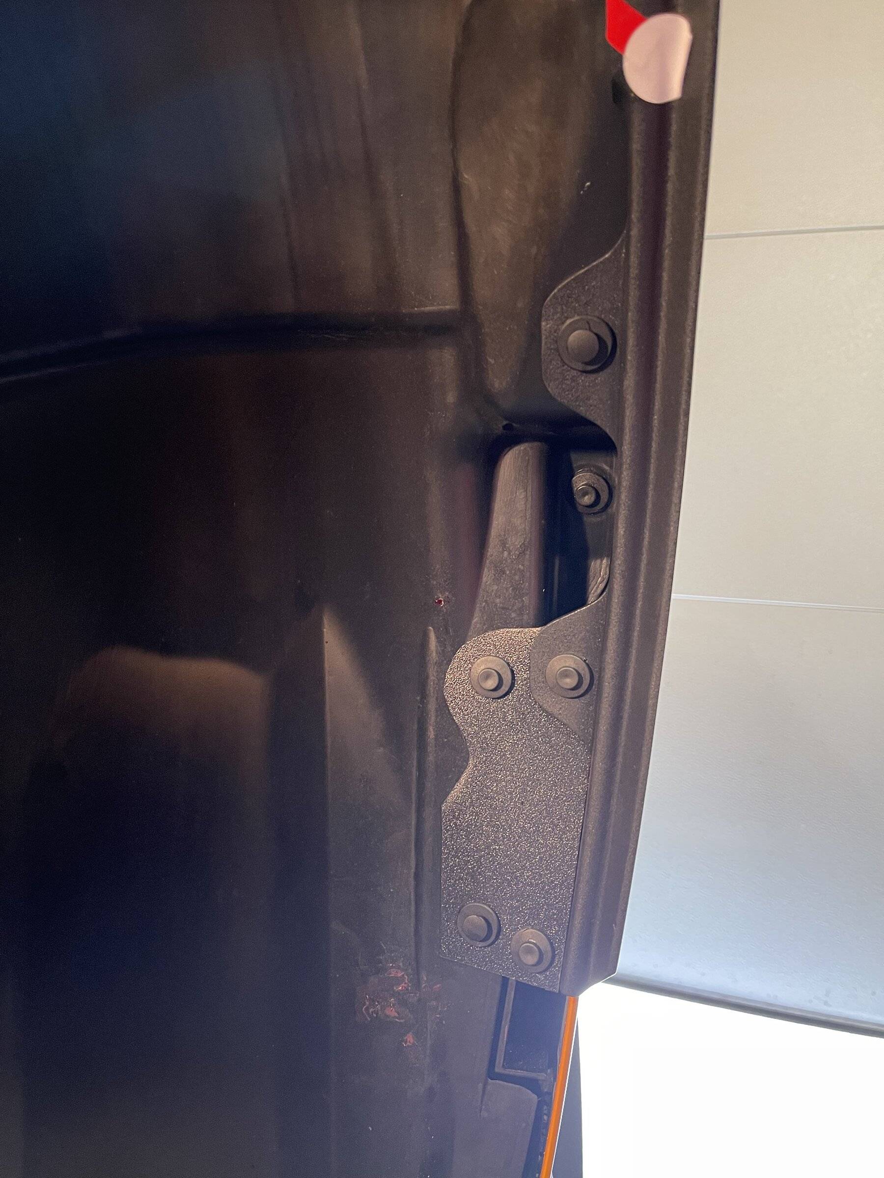

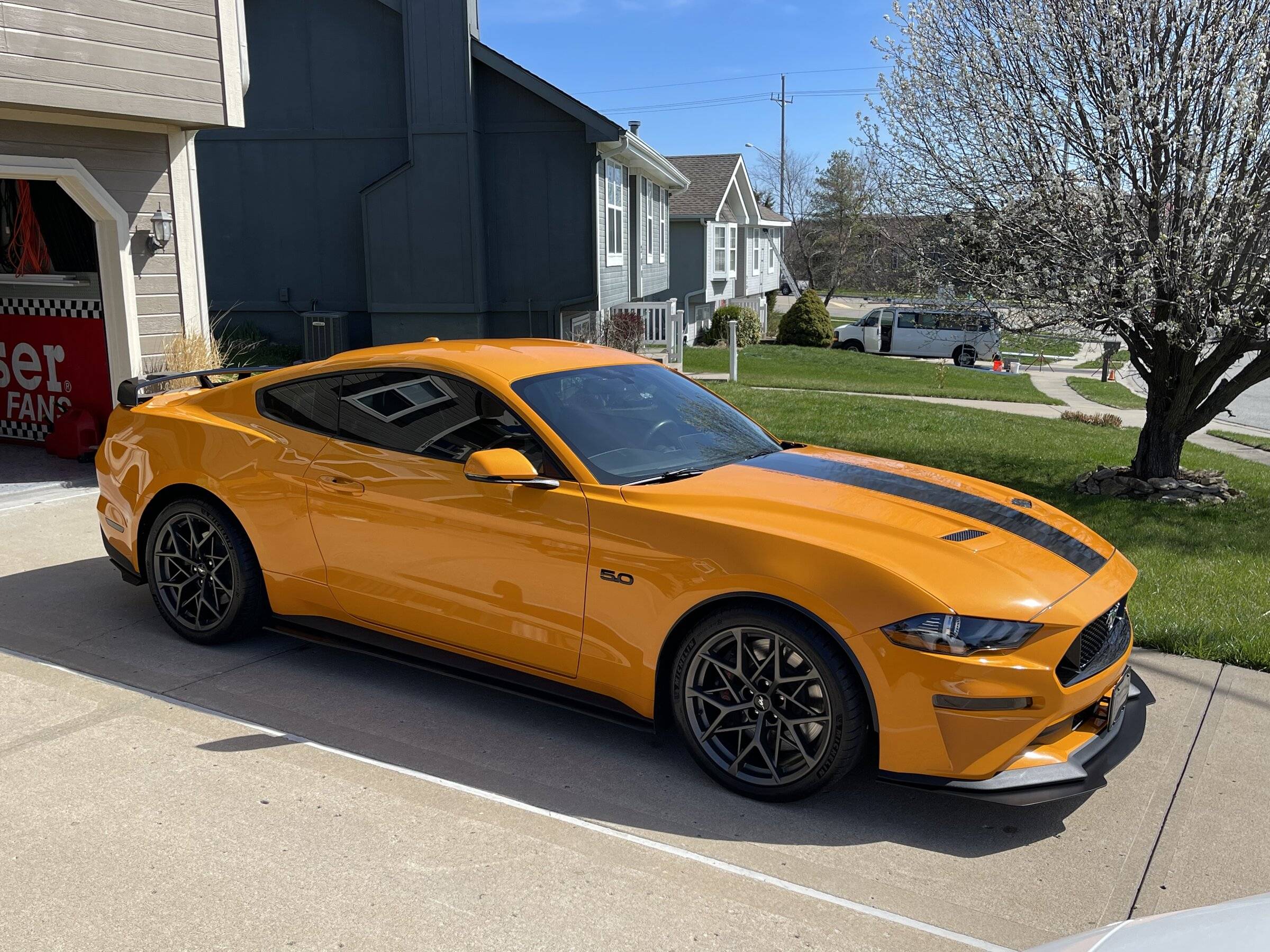

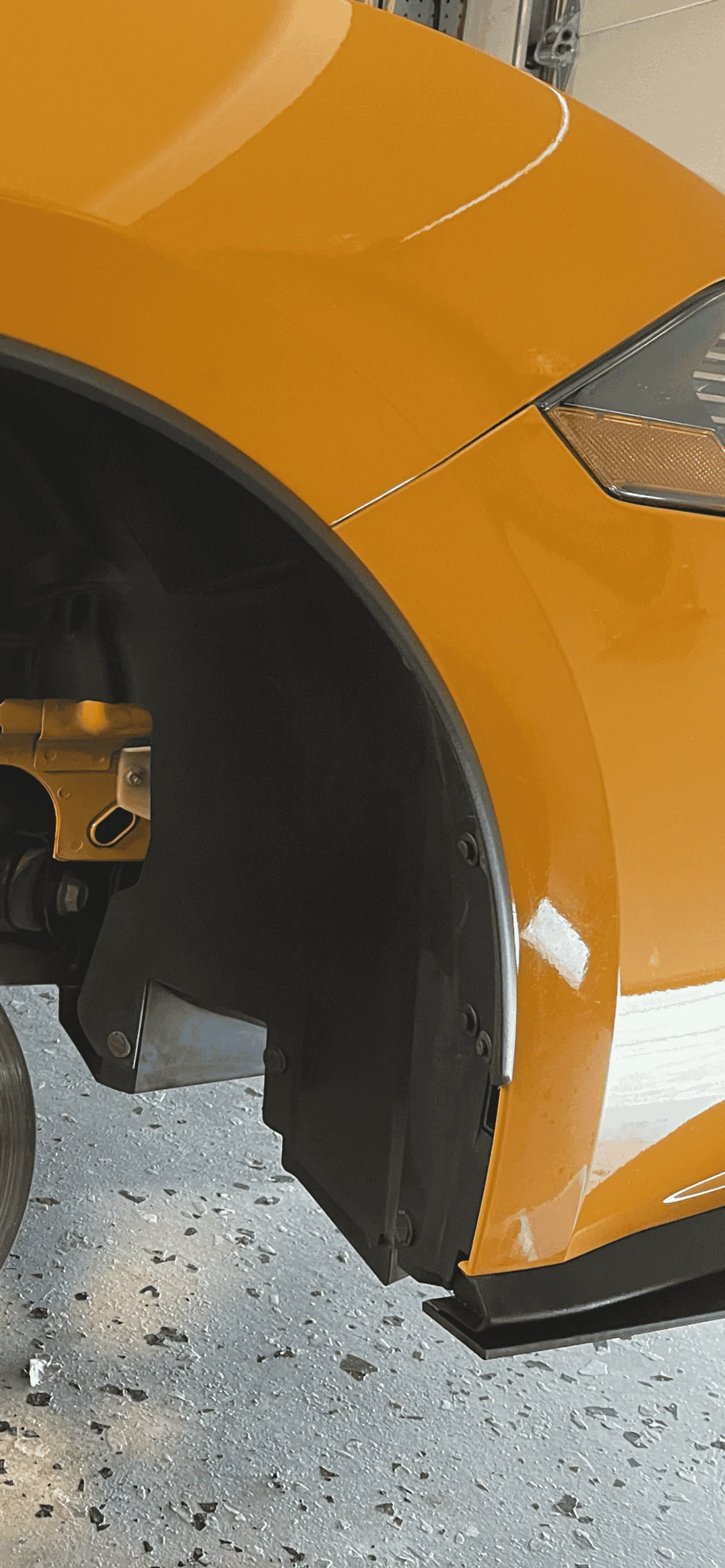

Ended up making a temporary “bracket” out of textured ABS plastic until I can get a set of Mach 1 wheel inner fender liners.
That’s clean. Love your wheels and your color. And your car! How hard was it to make those?

Thanks. A little bit of measuring and getting the holes to line up properly. Used cardboard templates to get to the final piece. Then transferred it over to the plastic. Used similar push pins as factory trying to make it look as OEM as possible.

Very nice! You did a good job. What did you use to punch the holes?

Thanks I cut it to contour the inner fender as best as possible. I used a drill bit with tape a 1/4” up from the tip so I wouldn’t go in too far. Pretty sure nothing is behind there but didn’t want to take a chance. Not even noticeable one the wheel and tire is on.

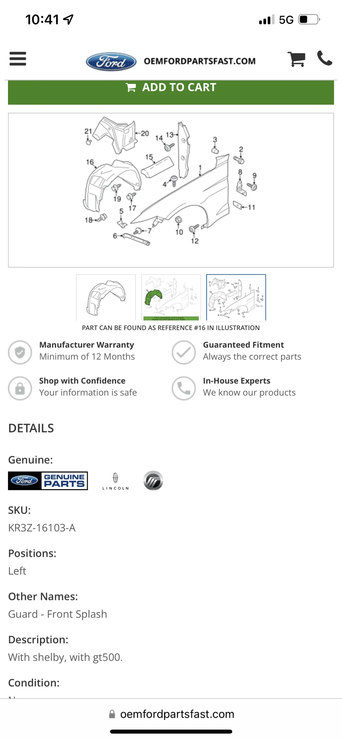

I bought my wheel liners from fordpartsgiant. shipping was cheap. but they may have gotten wise to that after they handled my order.

Nicely done. You only notice because you know it’s there. Otherwise no one would be the wiser once you’re on the ground. Good job man.

If you don’t mind me asking how much were the liners? I haven’t had a chance to look em up yet.

45 I think. each unfortunately.

Thank you. Didn’t see em on their website. Need to find the part numbers I guess. These say Shelby/GT500…?

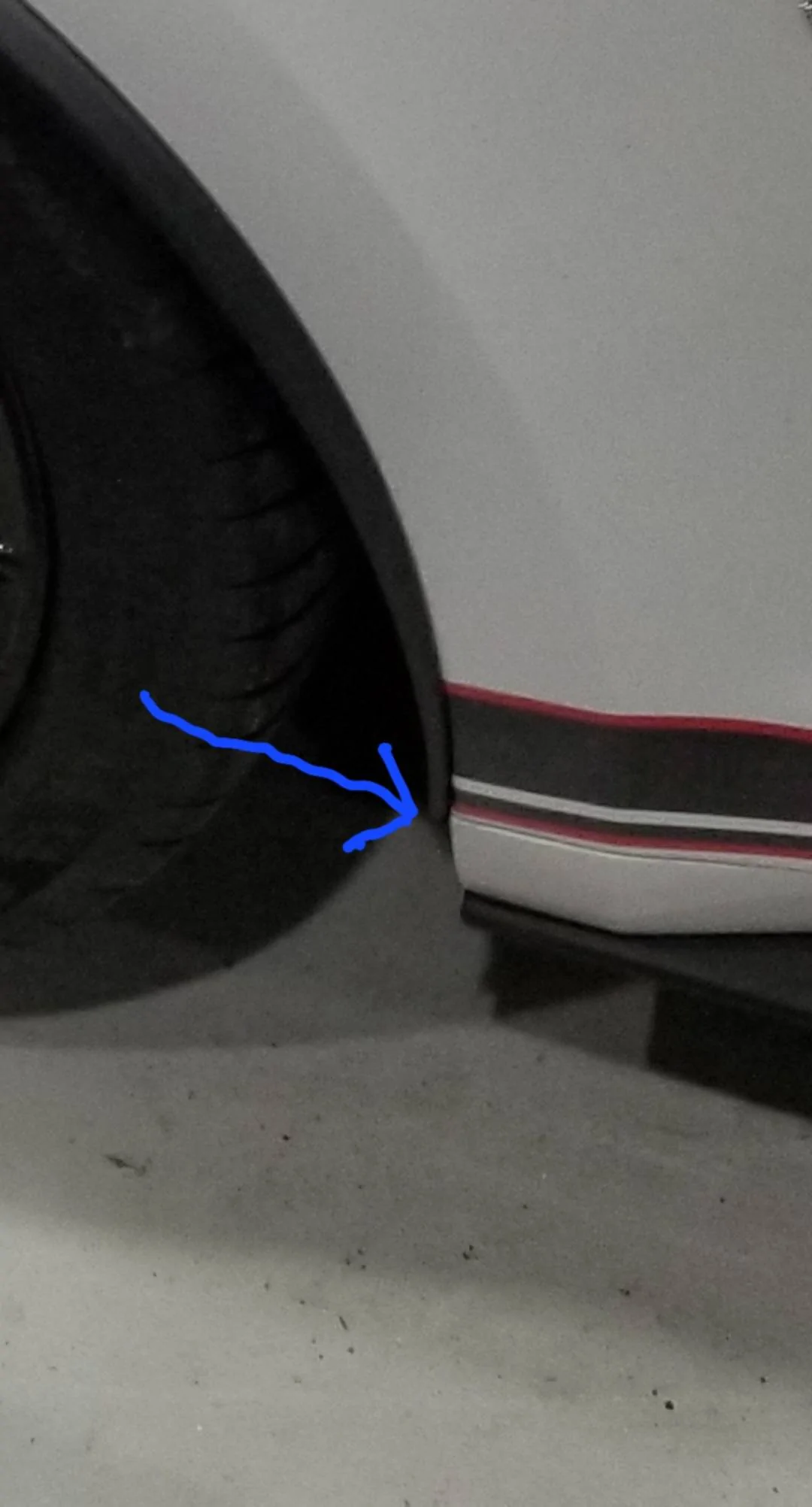

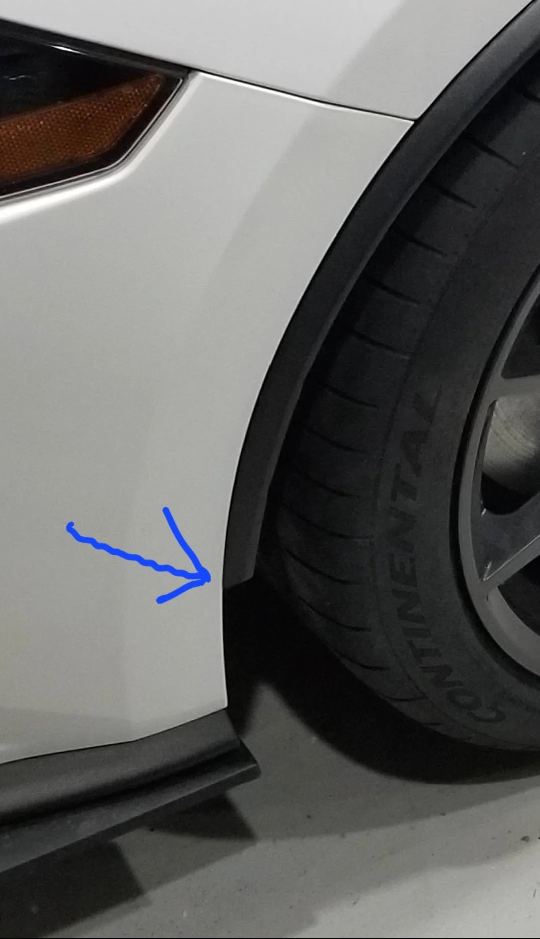

Yup I got them. Oem Mach 1 fender flares. Took a month to get them in from my Ford dealer. Shout out to Zach @Peoria Ford here in Az for hooking me up.
I have a 15’ with a roush kit, gt500 rockers, and gt350 rear valance. So we will see what needs to be done for fitment. Bare with me as I will have to wait a few days to install them. My car has bowed out front fenders from the previous owner bagging the car with the wheels turned to one side (bastard) Im waiting on paintless dent removal to be completed. Until then I took some pics of the flares.
I installed on my 2020 PP2. These are not designed to fit the GT. The fitment issue is at the front. There are no mounting points for r he push pins at the front bottom and as you can see in posted photo the do not reach the splitter as they are designed for the Mach 1 splitter. I will post some photos of my car when I return from Europe next week.
