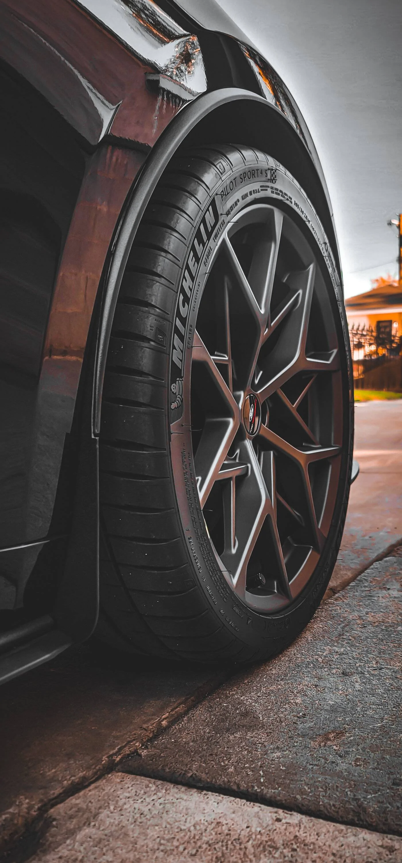

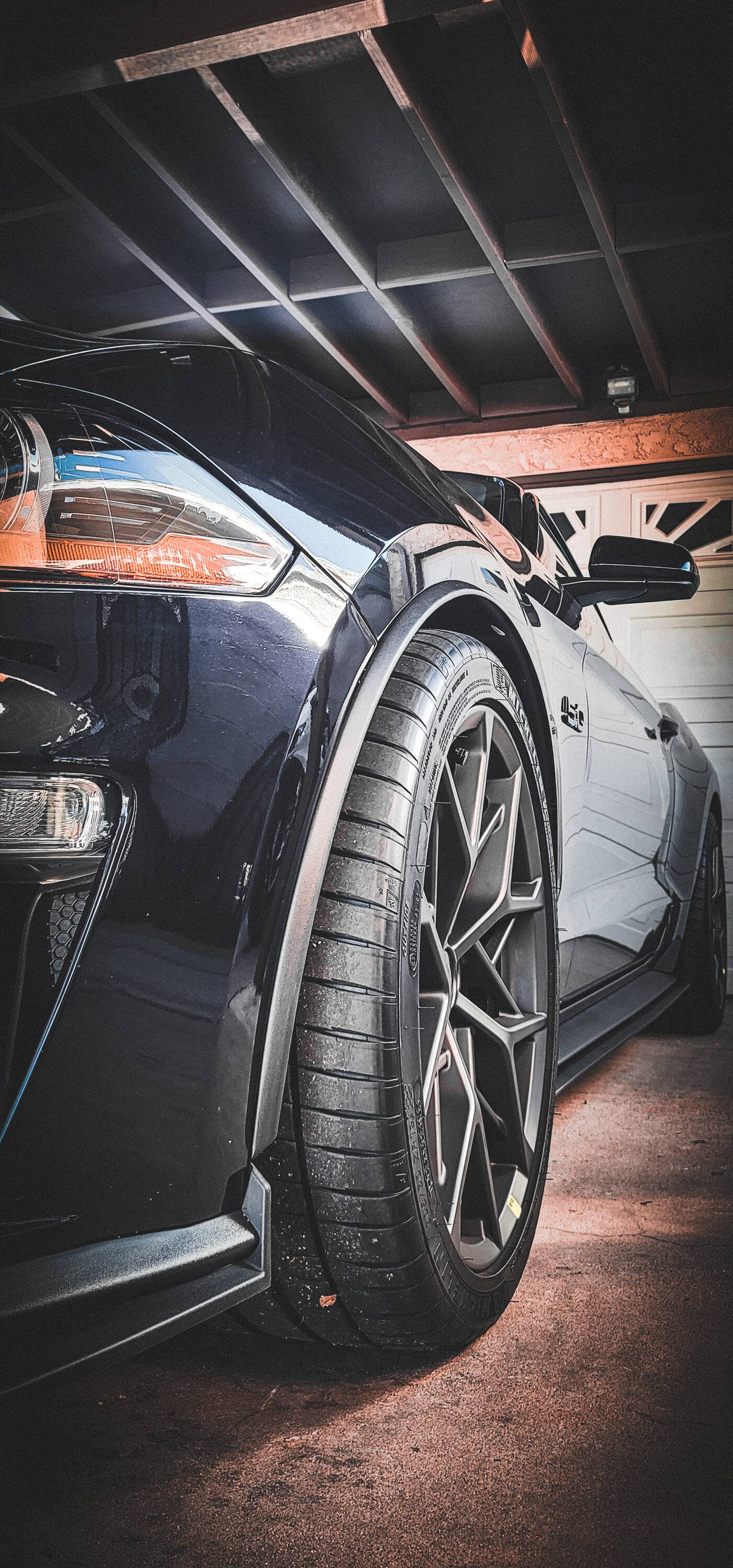

You did a really nice job on this. Did you reverse the direction of the piece by switching the passenger side and driver's side? Or did you slide it forward?
I installed a set too on a PP1 but they don't reach that far on the front edge, but are further back on the rear edge?
Regardless, you did it really well.

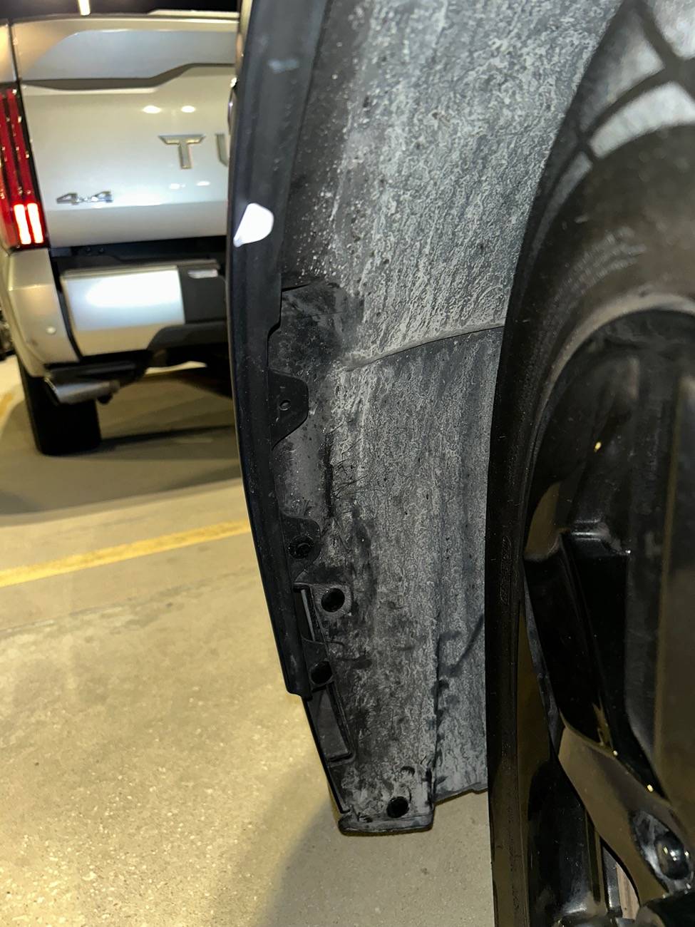

Thanks! So... I didn't reverse the rock gaurds, I installed those last year. I pretty much left them in place and started the mounting of wheel trim as far forward as possible.
Then I had to create a mounting bracket. So I cut a small 6x4 inch piece out of same material that I had laying around.
So, as I worked my way from front bumper to rear of wheel arch, I left the rock gaurds in place and marked where I needed to cut. Then removed rg and used a thin blade usually used for wood work. Important* I didn't cut all the way to my lines, I cut close to my line and then sanded the rest as needed! After a couple of back & forth, test fitting/Sanding a bit more I'm very pleased with final look!
Going to do the same with the rear soon!

Same set up, only I have a pp1
ZL1 addon rock guards with mach 1 hp wheel trim. However since I do not have a mach 1 front bumper I had to slightly alter the positioning so it looks as oem as possible.

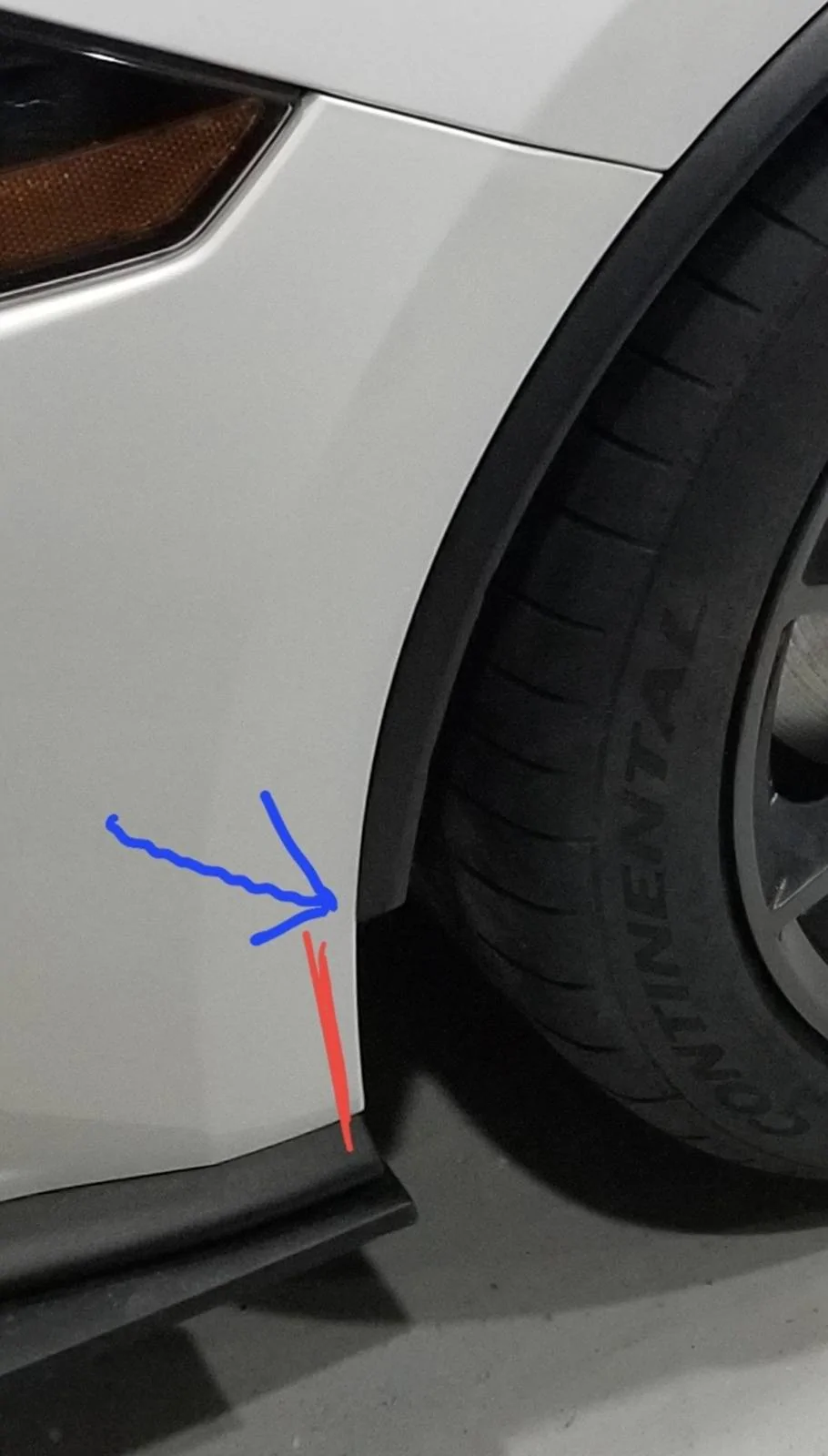

KR3Z16103A So if i install these Mach 1 fender liners, the Mach 1 fender lip molding will line up correctly? I read this old entire thread and doesn't seem clear.
No. The front bumper splitter doesn't rise up high enough to meet the front edge of the lip molding. You'll be able to attach the lip moldings, but they'll be empty space toward the front.
The red area will be empty but it's not terrible.

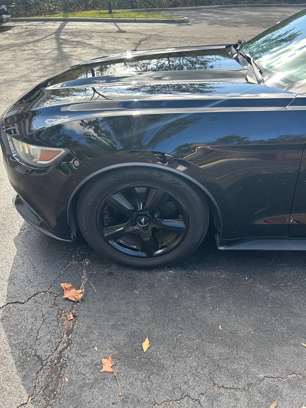

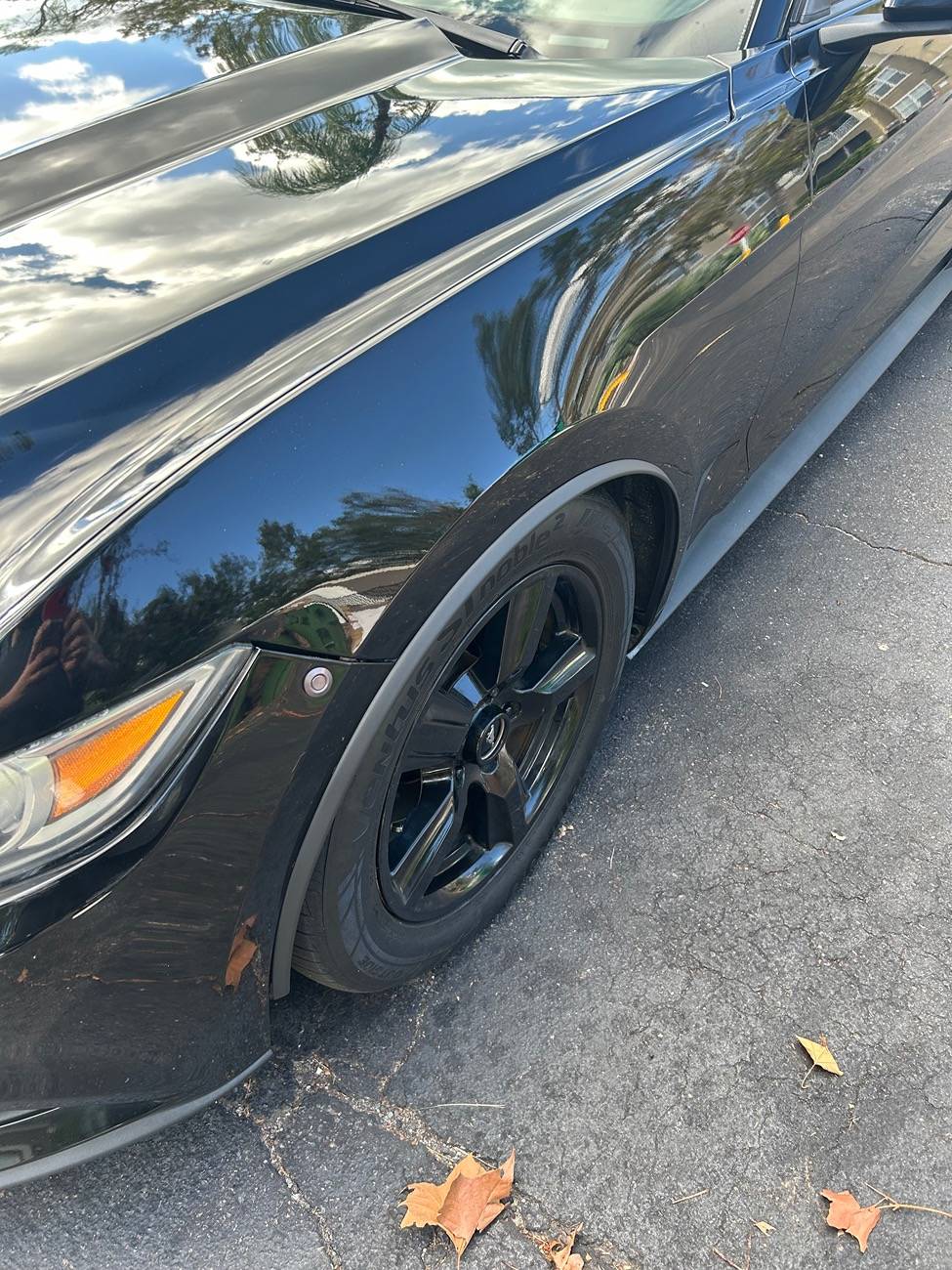

Just installed today.
I was concerned about the plastic gap, but on a black car it looks great and doesn’t make the gap as noticeable

Could you show how you installed it? I just bought a set of flares, but I’m not sure how to install on my 17.
On the beginning of this thread , someone showed how to install it by cutting out plastic brackets, that is the best to go.
I got a sheet of 1/8 abs plastic to cut the same, just didn’t get around yet. Right now 3 out of 5 holes are holding it fine, but it is better to use all.
Thanks man! I did something similar and it’s not perfect, but I got the plastic to make brackets later.
