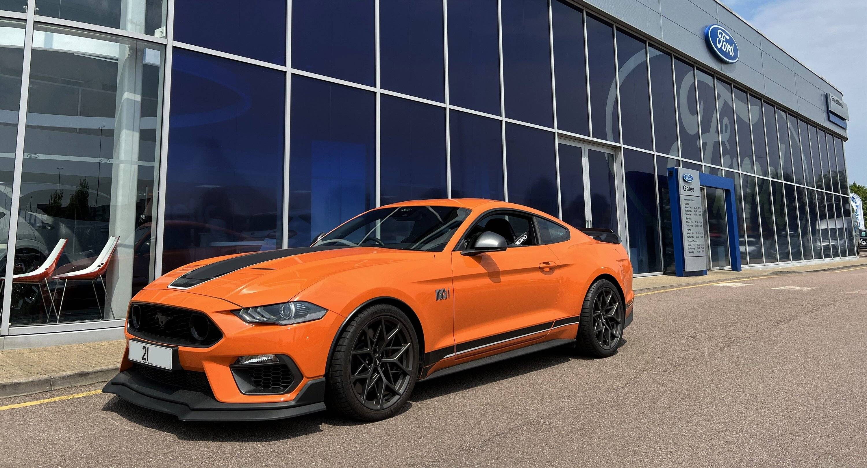

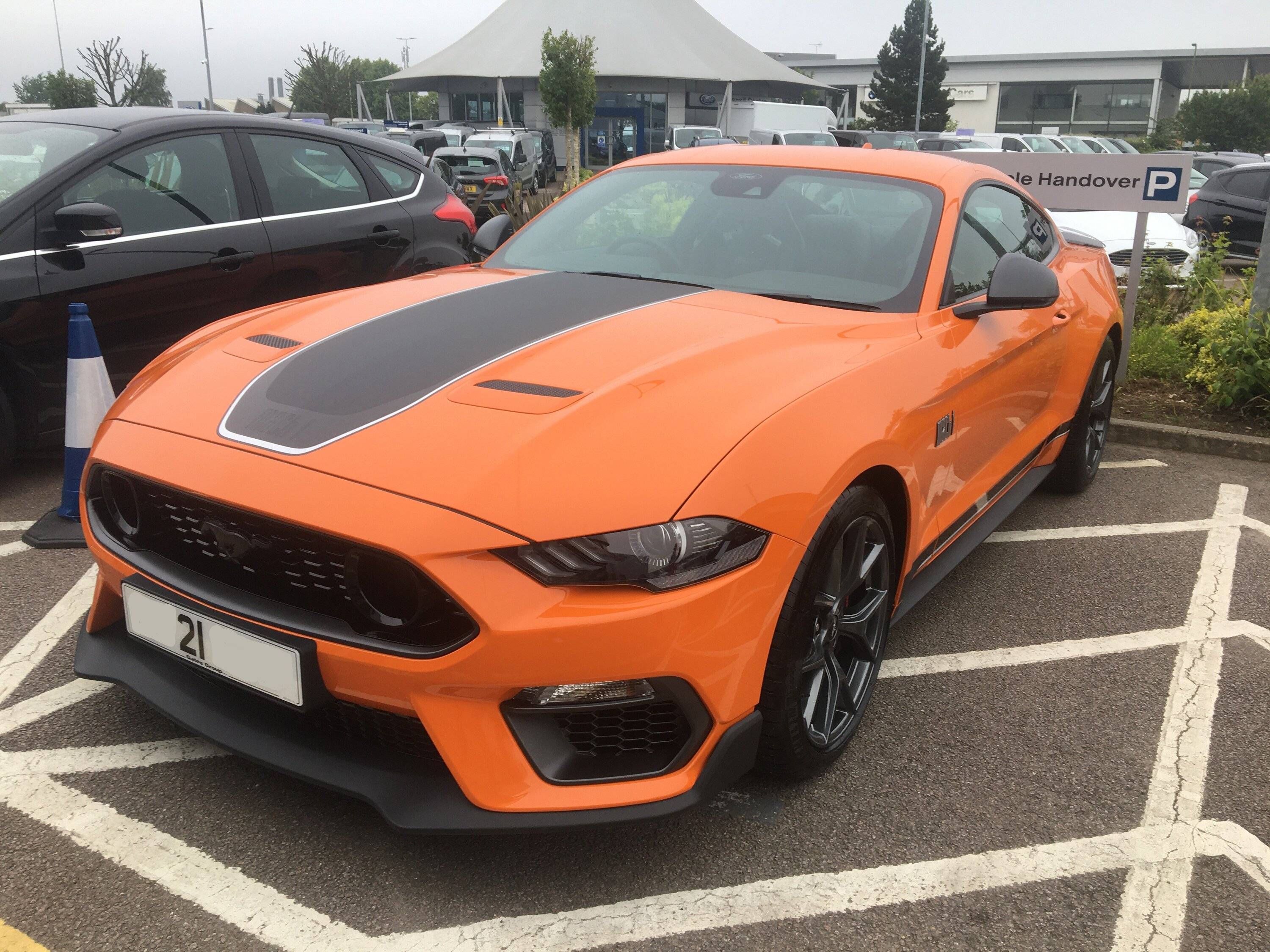

I did mine in phases so have some photos from day of collection - right away I added a Steeda Stop the Hop full kit, strut tower brace as we don't get those, Mach 1 rear rock guards.
Then I did shocks, springs, camber plates, wheels & tyres, front wheel arch extensions.
Final round was splitter / wing etc.

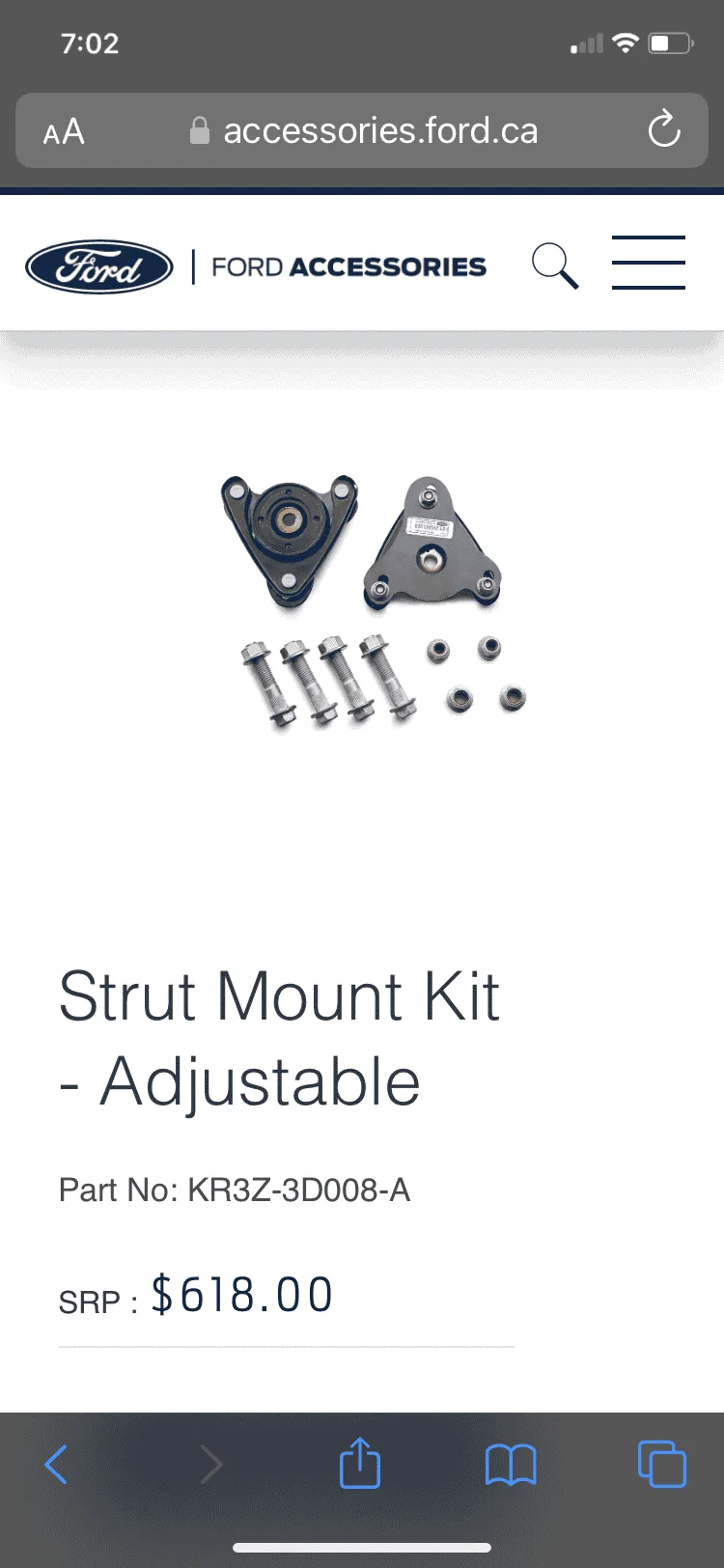

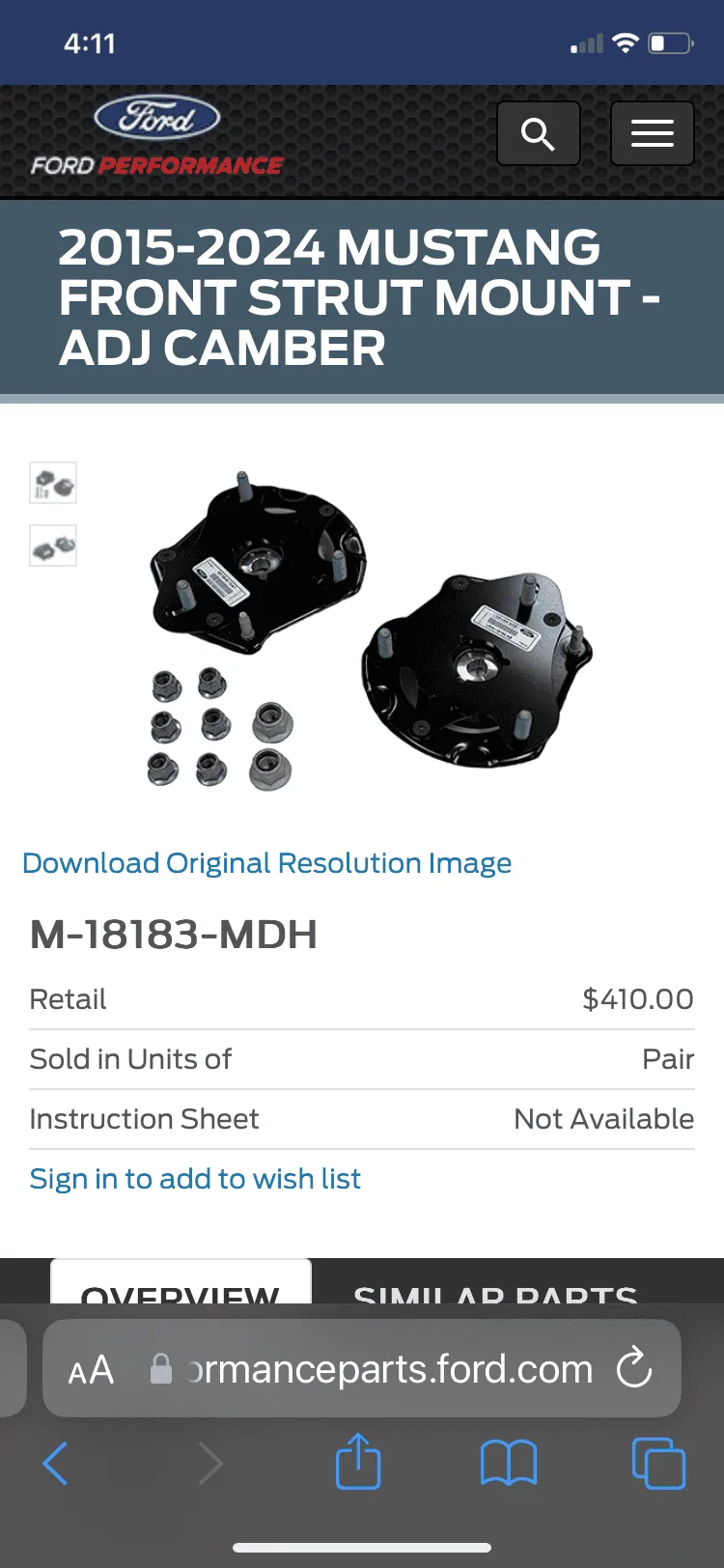

Would these be the adjustable strut top mounts/ camber plates you installed?
I’ve seen these aswell.
Yes - I've got the first type (KR3Z-3D008-A) , which I got in 2022 but I'm now concerned I've got the 'wrong' type and the M-18183-MDH might be better, I was looking at this today as the other thread got me worried!
I've just asked Levittown Ford Parts - who I've used for a lot of the HP bits we can't get in the UK - which would be the 'better' set. Can let you know what they say if that's helpful!
-0.
Yes please let me know what Leviton reply,
Are yours not adjustable the ones you installed? Why are you worried,

Well that part number clearly says that they are adjustable strut top mounts so I’m sure you’re OK,
the set that you have on are original Ford strut top mounts from I believe 2015 to 2020 S550 models, they there after I think in 2021 changed the style and look as you can see in the second picture I sent you, they serve the same purpose, that pin that sticks out it is just an added feature that locks it into the strut tower, the original did not have that,
Don’t quote me on this I just like to do a lot of reading and research

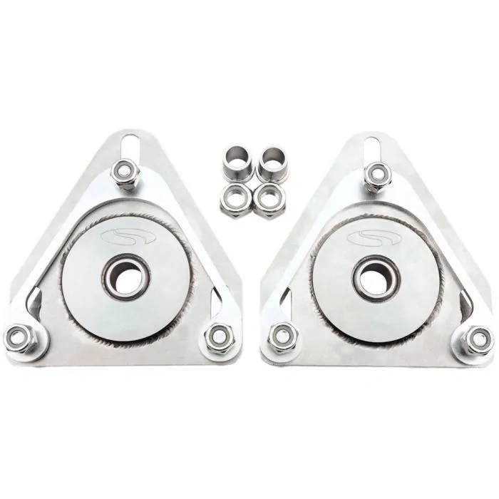

If you look at the Steeda camber plates for the S550 mustang, you’ll notice that there’s no pin on these and these are clearly adjustable camber plates

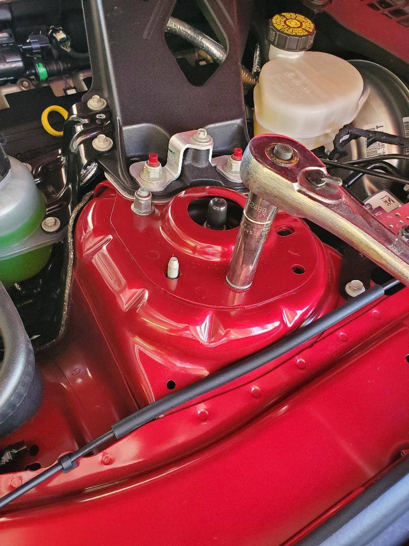

Just for reference, here is the post I made mentioned above :
I know you have already had the confirmation you were looking for, but for future reference, or for others reading this :
The easiest way to identify the factory Ford camber plates, is by the pin that protrudes through the strut tower hole (that hole is normally vacant) :
WD :like:
It came from this thread :
https://www.mustang6g.com/forums/threads/2022-factory-hp-adjustable-camber-plates.187723/
I will also attach this photo, shamelessly stolen from @Tomster ‘s post based on his 2020 500 CFTP :
So I don’t know if Ford used any other type of camber plates direct from Flat Rock, but both the 2020 500 CFTP and 2023 M1 HP I have seen have had that pin :like:
WD :like:
