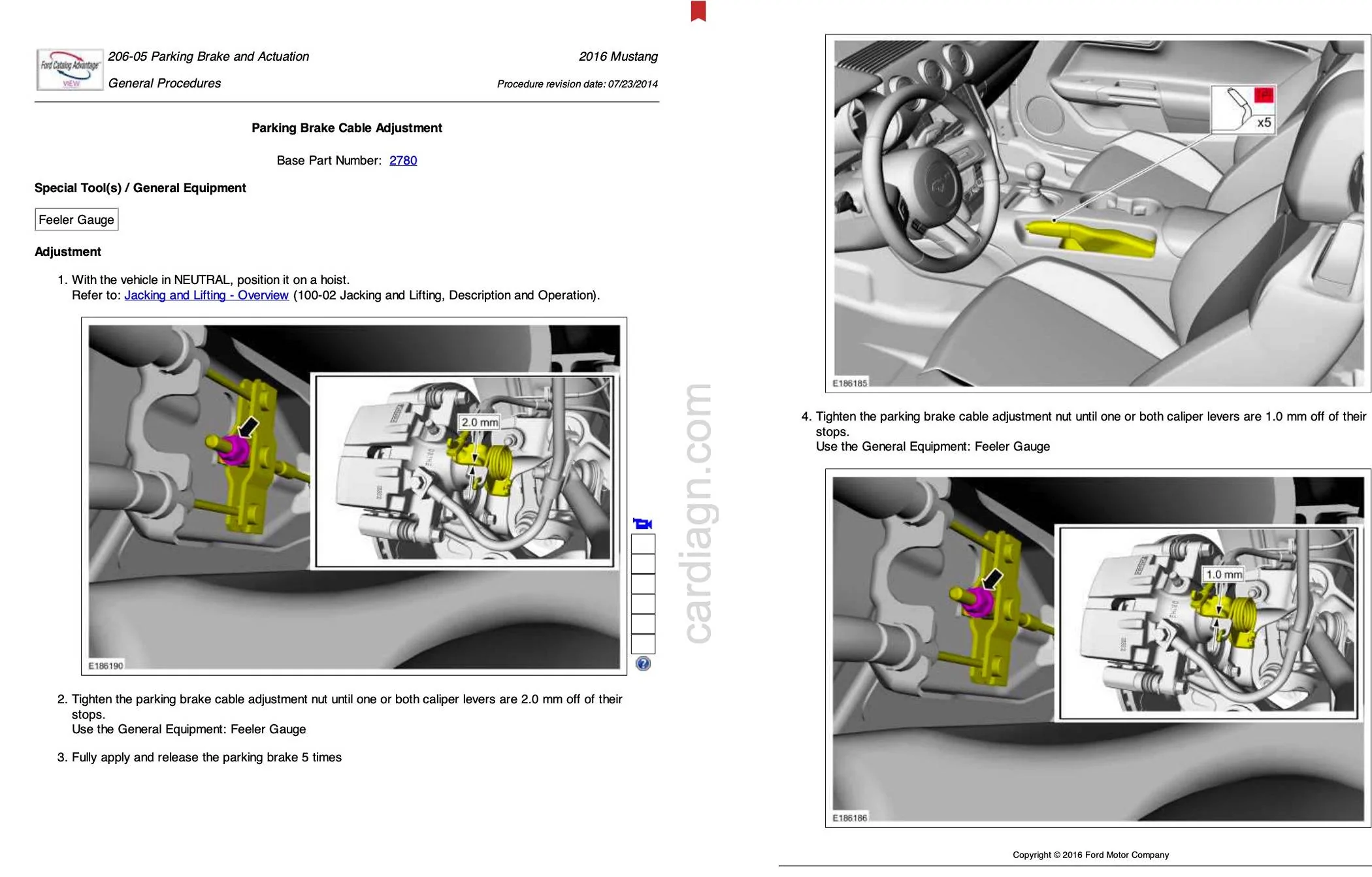

Make sure you follow the steps in the shop manual for the e-brake when replacing the rear calipers. You will need to loosen the cable a lot before removing the old ones. It took me way more than 5 pulls on Step 3 here, and it was more like 2mm>1.5mm>1mm for me to get the feel of the handle and the application of the e-brake perfect.

Thanks brother
