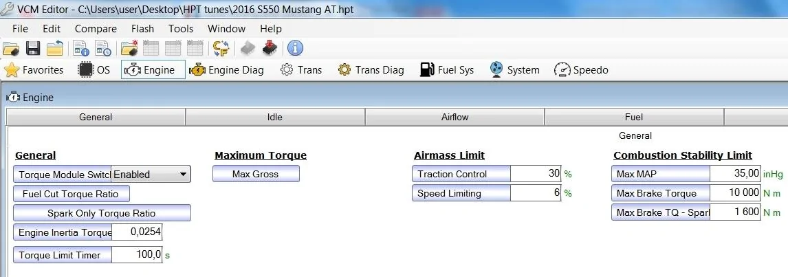

So LUND claims that you can't turn the TC off in S550 PCM? It's super easy actually, you can send this pic to Dasan - just increase the AIRMASS for TC.
Advance Trac is a different story - it's not even a function of PCM anymore.
Over and out.

you talk a good game, and clearly know enough to make it seem the bad info youre spreading is fact, but it remains that several of us have stated our traction and stability control are 100% intact.........with Lund tunes
