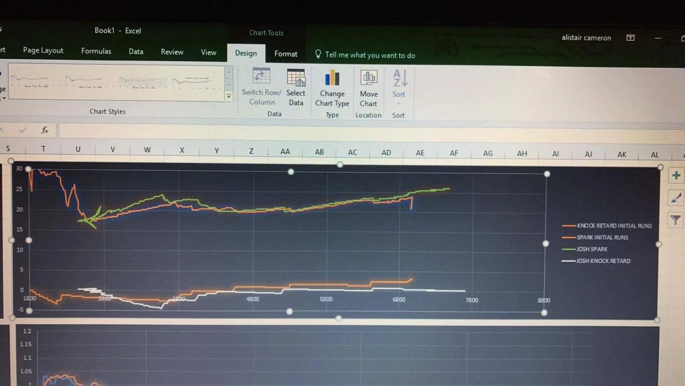

Just completed my first log and sent it off to Lund. Car pulled well all the way to the 7500rpm rev limiter. I had quite a loud pop with the limiter, not a bang lime burkey describes however I have stock headers and cats so I would imagine his would be considerably amplified.
I've included some data from my log below.
Also had a bit of a race (on a private road, big driveways in the bush) with a stock mustang (catback only). My tuned car was convincingly faster.

BOOM: My car has never boomed or banged ever on Lund tune, however I am on stock headers and stock cats with a Corsa Sport catback, I've never had a bang and I've being upto 8000rpm.
nGauge & Tacho: They should not be out! RPM on tacho should match rpm on nGauge, when datalogging the ngauge shows RPM, rev to 2500rpm on tacho and hold steady, ngauge should also read 2500rpm. :)
Limiter: DO NOT HIT THE LIMITER! Seriously one of the major causes of OPG failure is hitting the limiter hard repeatably, the harmonics will eventially crack/shatter the OPG causing fatal engine failure. Stay out of the limiter. I change gear around 7500rpm, my soft limiter is set at 7700rpm (massive timing reduction) and hard limiter is 7900rpm, some set soft at 7900 and hard as high as 8300rpm, not because they rev this high it just guarantees not bumping the limiter as hitting the limiter hard causes more harm than revving beyond 8000rpm.
Timing: Is Australian Vpower only RON 98? Do you not have 99/100 RON fuel?
