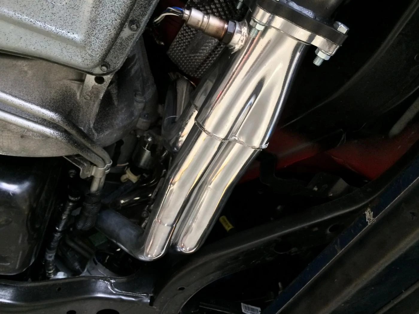

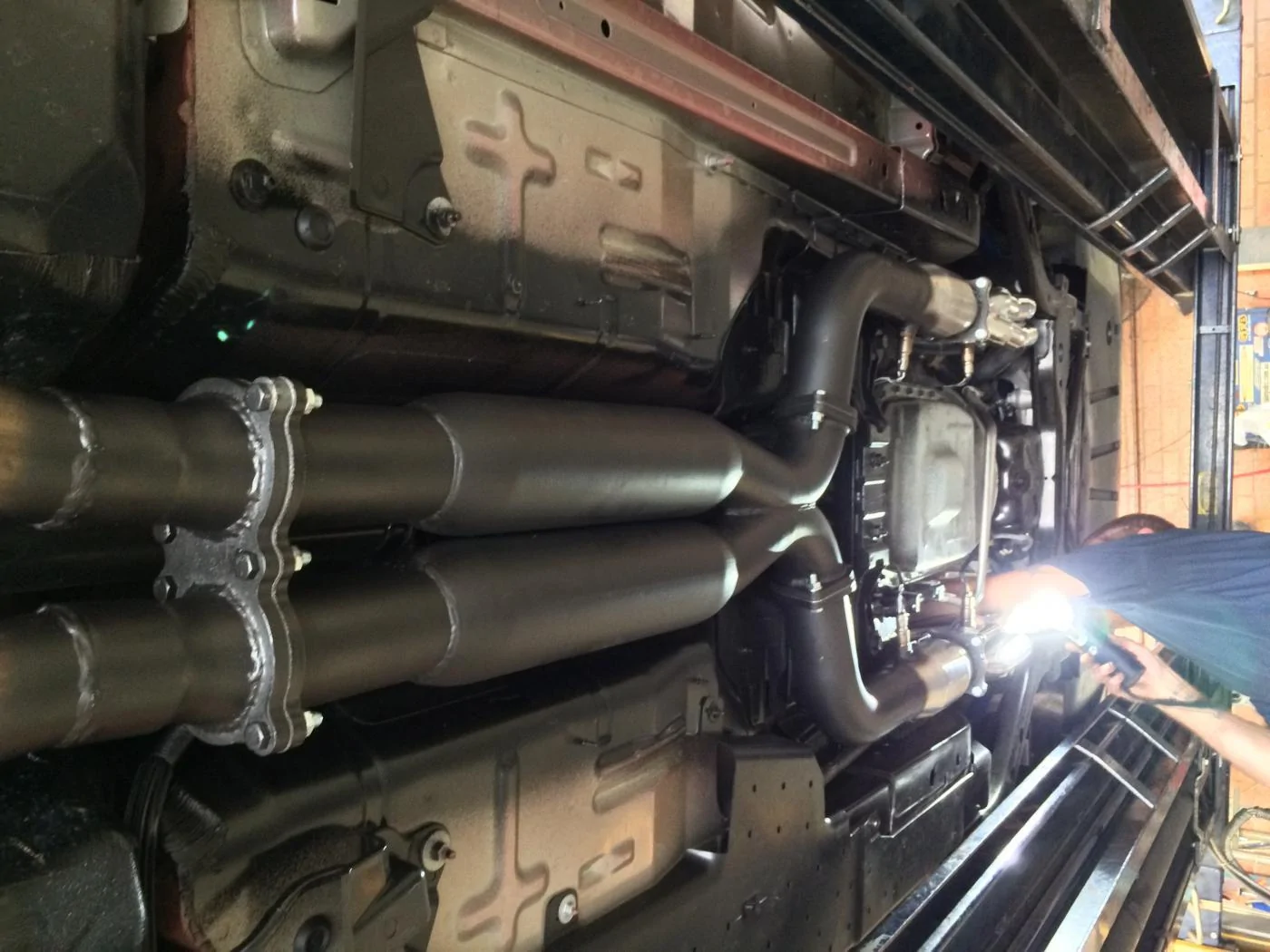

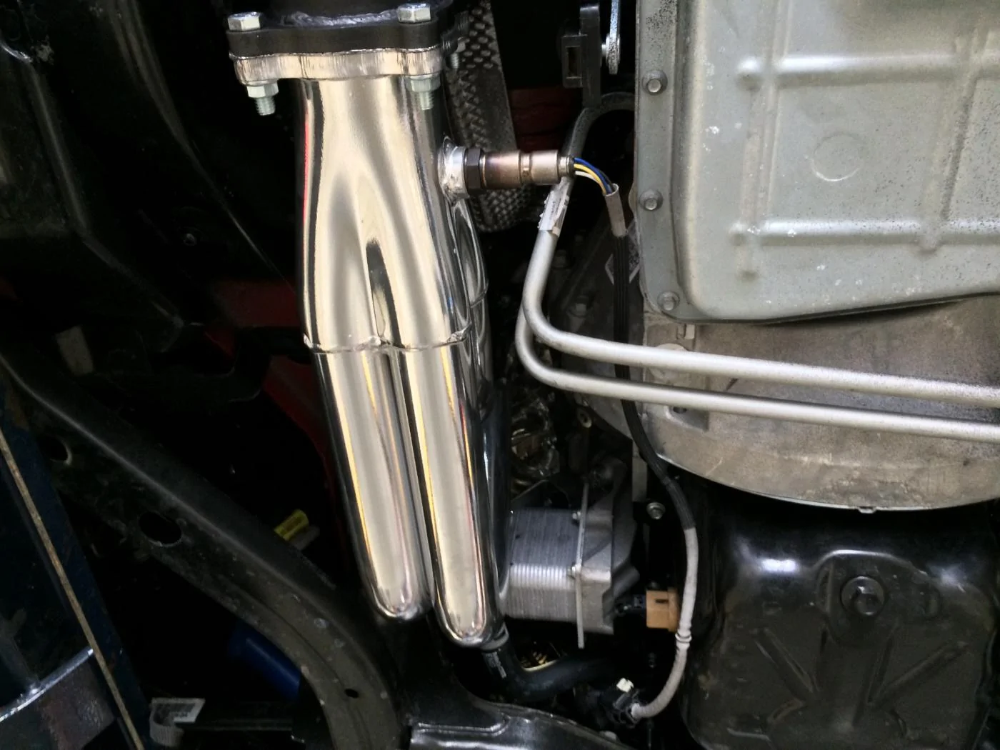

Quote for install from the workshop (they manufacture the headers) was extremely reasonable, 2500 installed (on an auto..) this included ceramic coated headers/cats/hot dog mufflers, and custom work to make my FRPP catback join up with their headers to catback system!
V's all the other local options in Australia, the rest were significantly more expensive, and I couldnt justify the price difference.
After researching some peoples experience installing headers on a manual car and the fact that auto is more difficult, I was happy to have the shop install for me, they have the process down pretty well now, and for the install price.... it just wasnt worth the trouble learning the install myself for the first time and possibly damaging something on the difficult install side.
I could not get really good pictures of fitment, as they were working on the car and i didnt want to get in the way, ill add a couple pictures here which might help a little. ill take some better photos, next time its on a lift.
