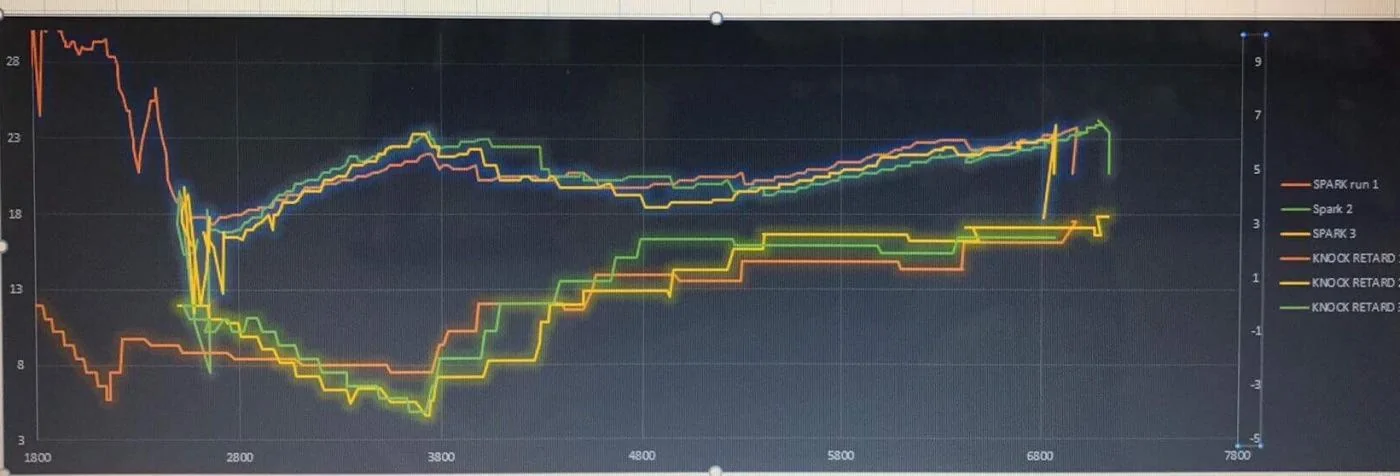

What timing at WOT you making?
Anything touching the headers even slightly will cause false knock! Did you also turn the AC bolt around as it tends to touch the headers as well.
Most base tunes make 24-26 WOT timing, then depending on fuel quality on Octane 93 GAS (98-99 RON) you can make as high as 31 WOT timing on best quality guess which in the UK is Shell Vpower Nitro+99
From what I can see in the logs, 23 degrees at the bottom and 24-25 at the top.
How much better would you expect it to go with the extra timing?

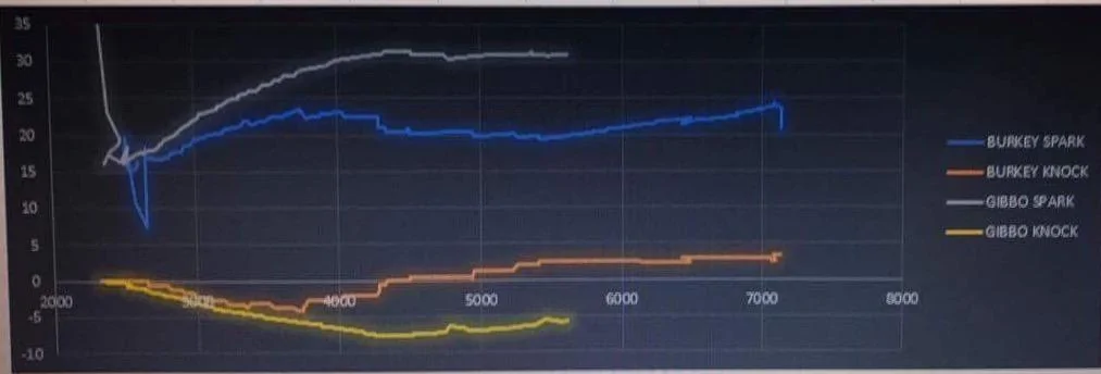

Man you have like another 20-30HP to go yet, a lot more timing to make unless your fuel is really poor there. As it really should not be knocking with just 23-24 degrees timing at WOT, so hope it is something touching the headers causing that.
Sort that, get it upto 26-27 it will pull harder, if your fuel is good and you get it around 29 it will feel like the map all over again. :)

Sweet!
For reference, here's yours vs mine

Sweet!
What is your maf flow lb rate? Mine is 48-49lb per min. Stock car is around 42 if I remember. :)
Mine and yours look identical, or near enough to it.
Not sure how that works. It's beyond my level of understanding at this point.
