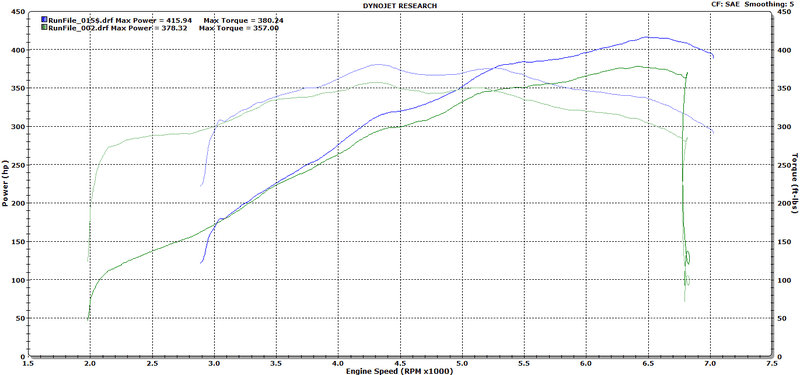

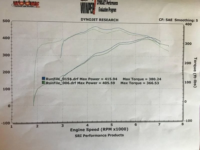

Here is baseline and then Lund Flex fuel tune on E85.
