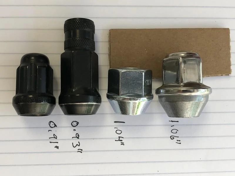

As another "over 50" guy, I definitely miss the 80 lb-ft torque from my old Mopars - and my previous daily Honda Fit... My torque wenches both go to 150, but that's it. I need to get wenches with longer levers...
As data points, here's a photo of the OEM lug nut on the right, with some others I'm dealing with. You can clearly see the stainless cap on the end of the OEM lug nut. That's the part that starts the problems. I just bought the open-end lug nuts second from right to use with my original EBPP wheels. The second from left is a Gorilla unit that I got to replace the spline drive lug nuts that came with the SVE GT-7 wheels. The Gorillas are the biggest base I can get that fits the cone seat in the wheels. I could go larger, but there wouldn't be contact in the seat, so I thought that would be kind of pointless. FYI, the dimensions shown below are measured at the shoulder of the cone, not the hex.
Lug nuts by clair_davis, on Flickr

Small diameter are required for many aftermarket wheels. If you are using stock wheels or wheels that accept stock size lugs, do that.
This - I would say run the widest base lug nut you can, as long as it fits the seat in the wheel. Spreads the load over a larger area, so it's potentially safer in an impact or heavy cornering loads. Plus, at 150 lb-ft of torque, the wider seats probably deform the wheels less. That was my real discomfort over the small spline-drive lug nuts that came with the GT-7 wheels, and even 0.020" wider was worth it. Plus I didn't want to keep up with the spline drive socket forever.
