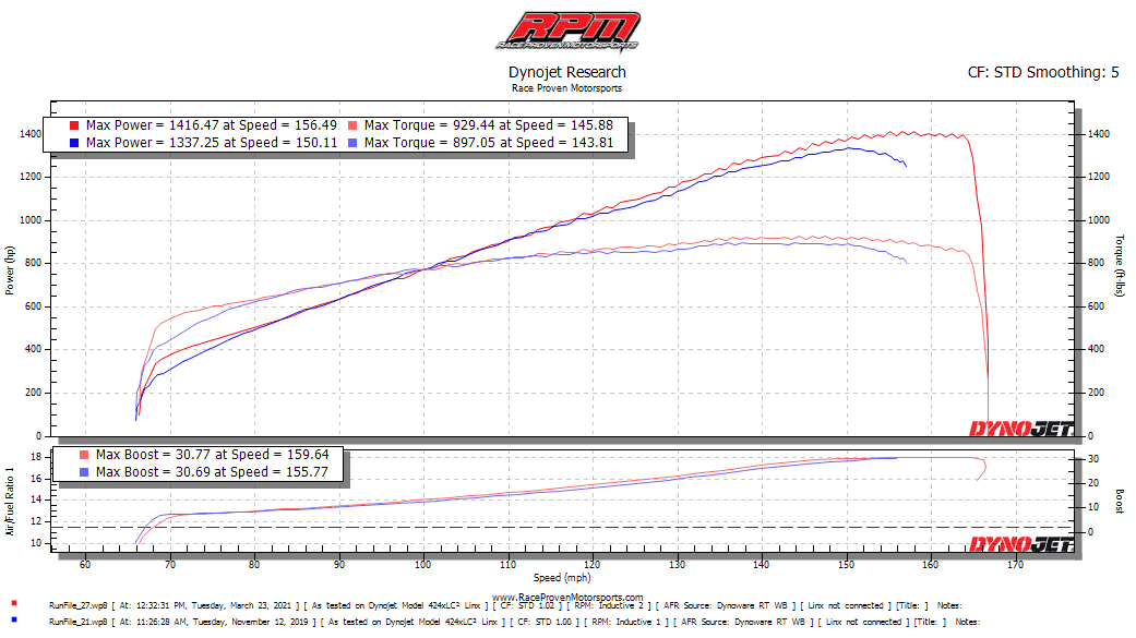

This was my results with increasing exhaust flow on a built coyote.
I had,
1 7/8" long tubes, 3" x-pipe, and a 3" MBRP cat back.
I installed,
2" long tubes, 3.5" x-pipe, 3.5" bullet mufflers dumped.
I did swap intake manifolds from the Boss to the Holley Race manifold but I highly doubt there was any gains. The gains above 150mph on the graph are from having the proper fueling.
I had,
I installed,
I'm intrigued..... would you care to share a little bit about the build (clearly non turbo) that made that kind of power?
