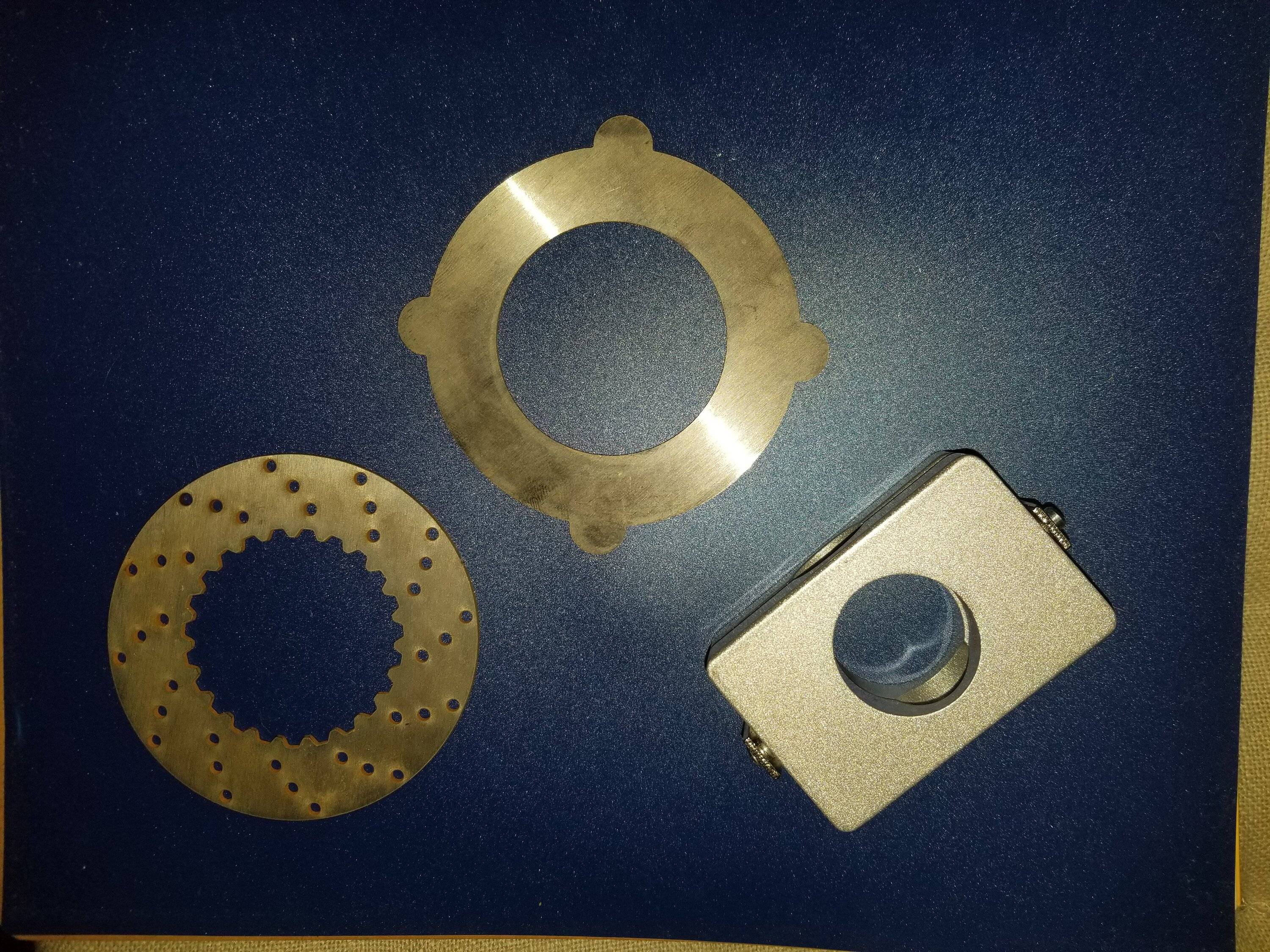

Ford Performance makes some Trac-Loc plates with carbon fiber friction surfaces that could be a advantage compared to stock. We already get the heavy-duty preload spring. I've got a differential plate package I've made for the Trac-Loc which gives it significant more locking capacity, but this is unusual.

What I'm doing, it lets you get 5 plates per side and they're made of hardened tool steel, so wear shouldn't be an issue. They'll likely be a little noisy in parking lots. The block piece was my first attempt at something to add preload, but it didn't work. I've got a different idea, now, but the stock heavy-duty S-spring is a good enough option to start.
