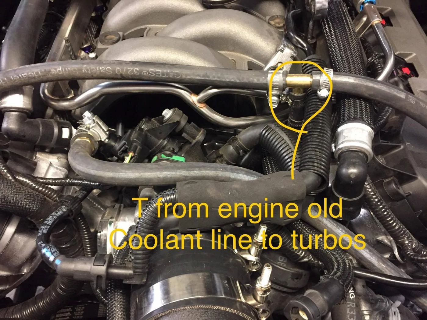

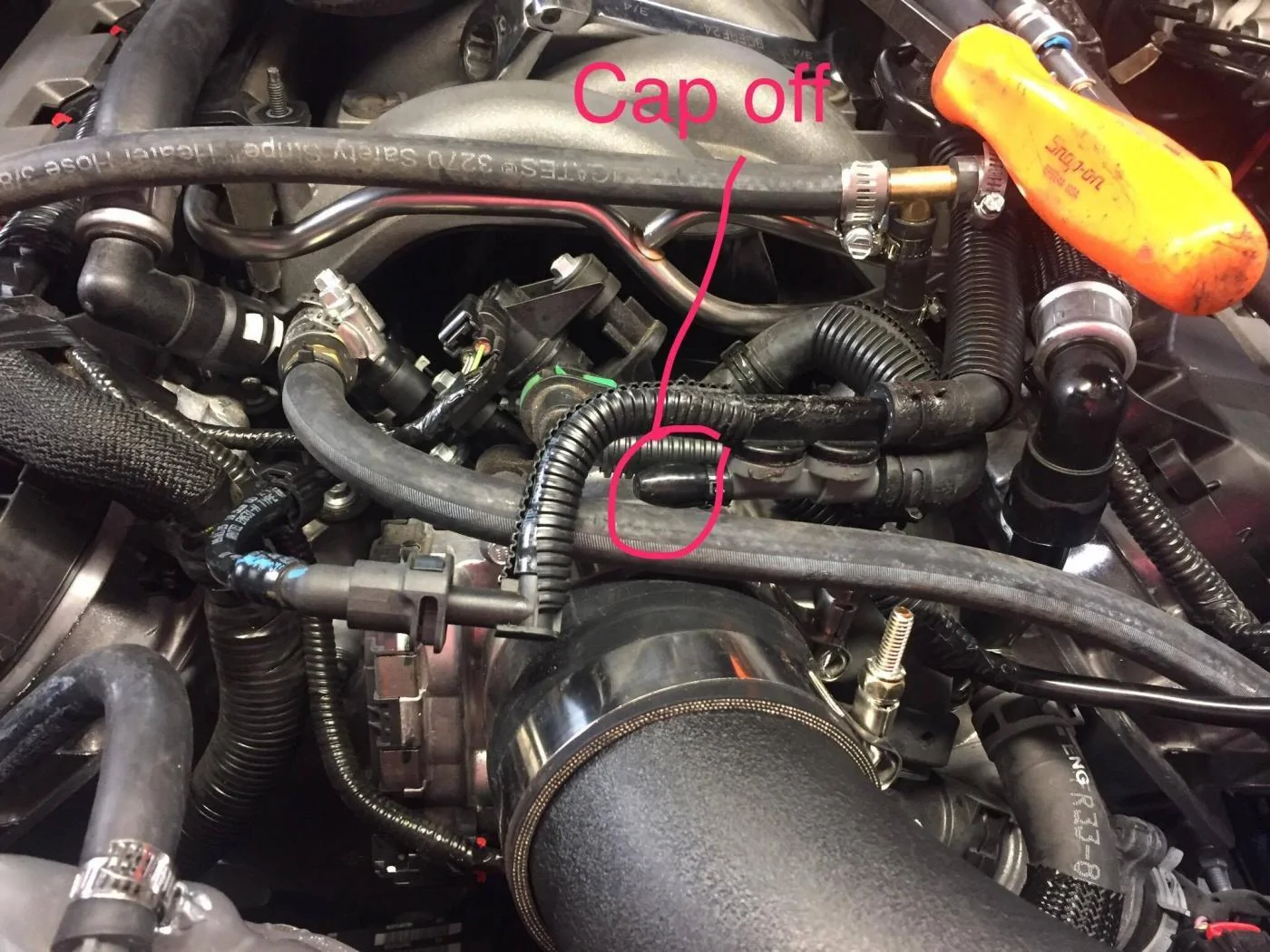

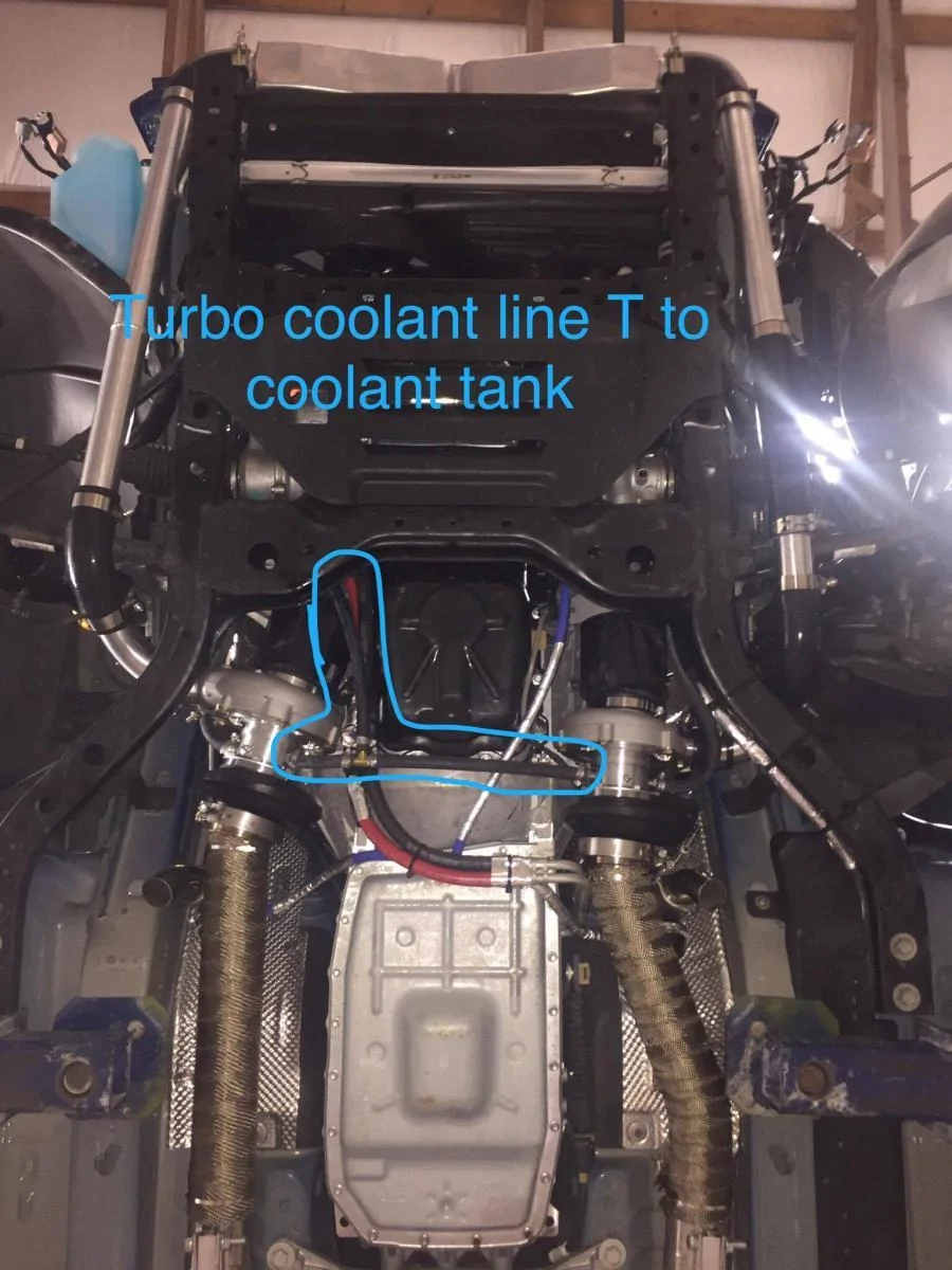

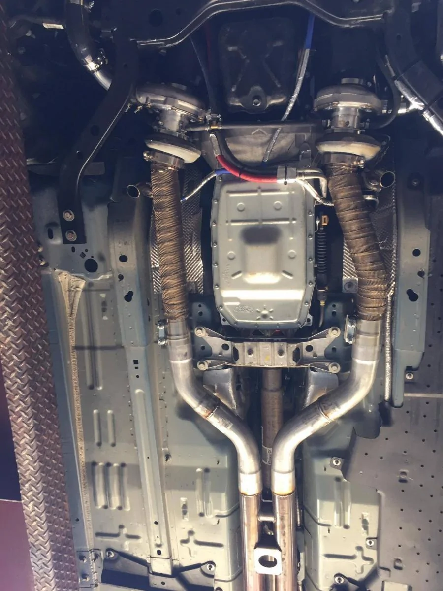

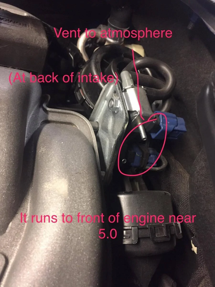

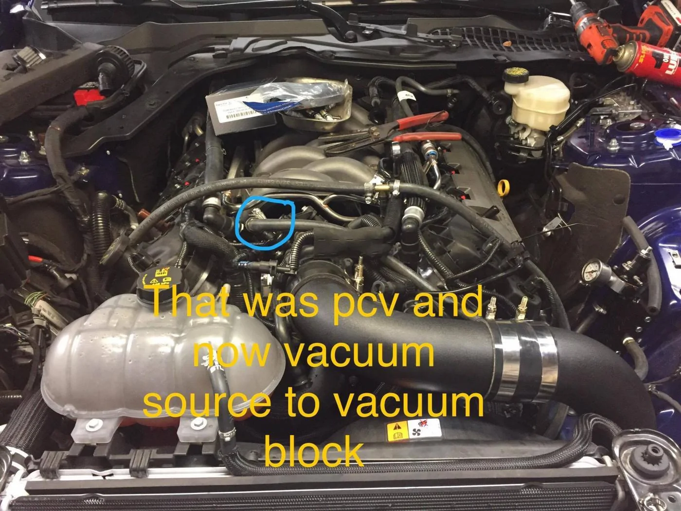

Hi guys, figured I would document my LPF TT build since there's none on the site or any information on it for those who are interested.
Currently i have no suspension installed besides gtrac brace but will be soon putting in ISC n1 coilovers and my BMR cradle lockout.
Order was placed for cybermonday and will be here in about a month. I am currently looking for a tuner and also deciding on injectors, looks like im going with ken from palm beach though.
