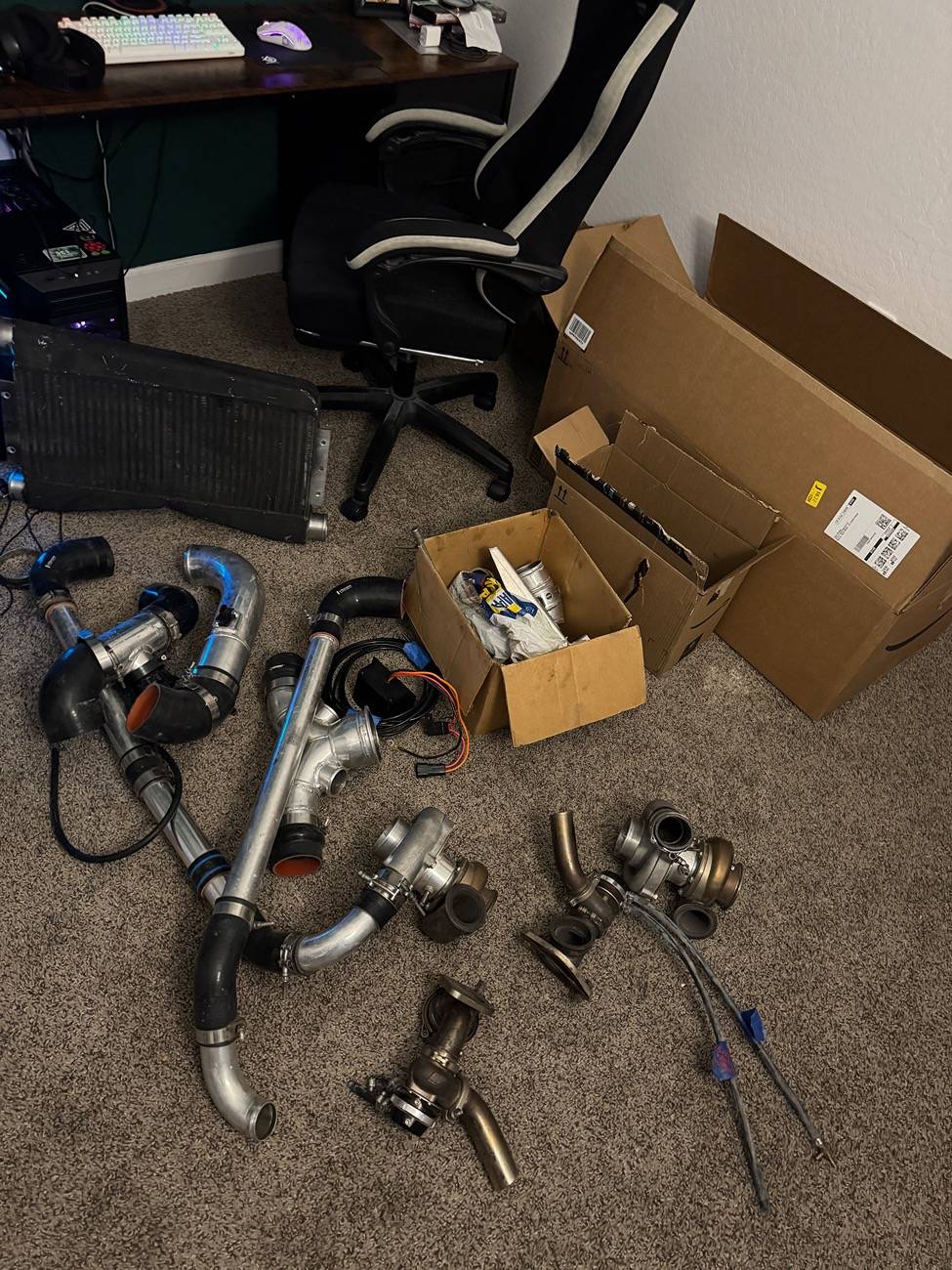

Picked up a used lpf turbo kit. Does anyone have the install instructions? I know a few members on here picked up the kit several years ago but none seem to be active anymore. For those that don't know lpf went out of buissness so I don't think I can contact them to get it.
Thanks!

Nice find. what kit is it. ? Pics ? Is it the bottom twin turbo kit ?

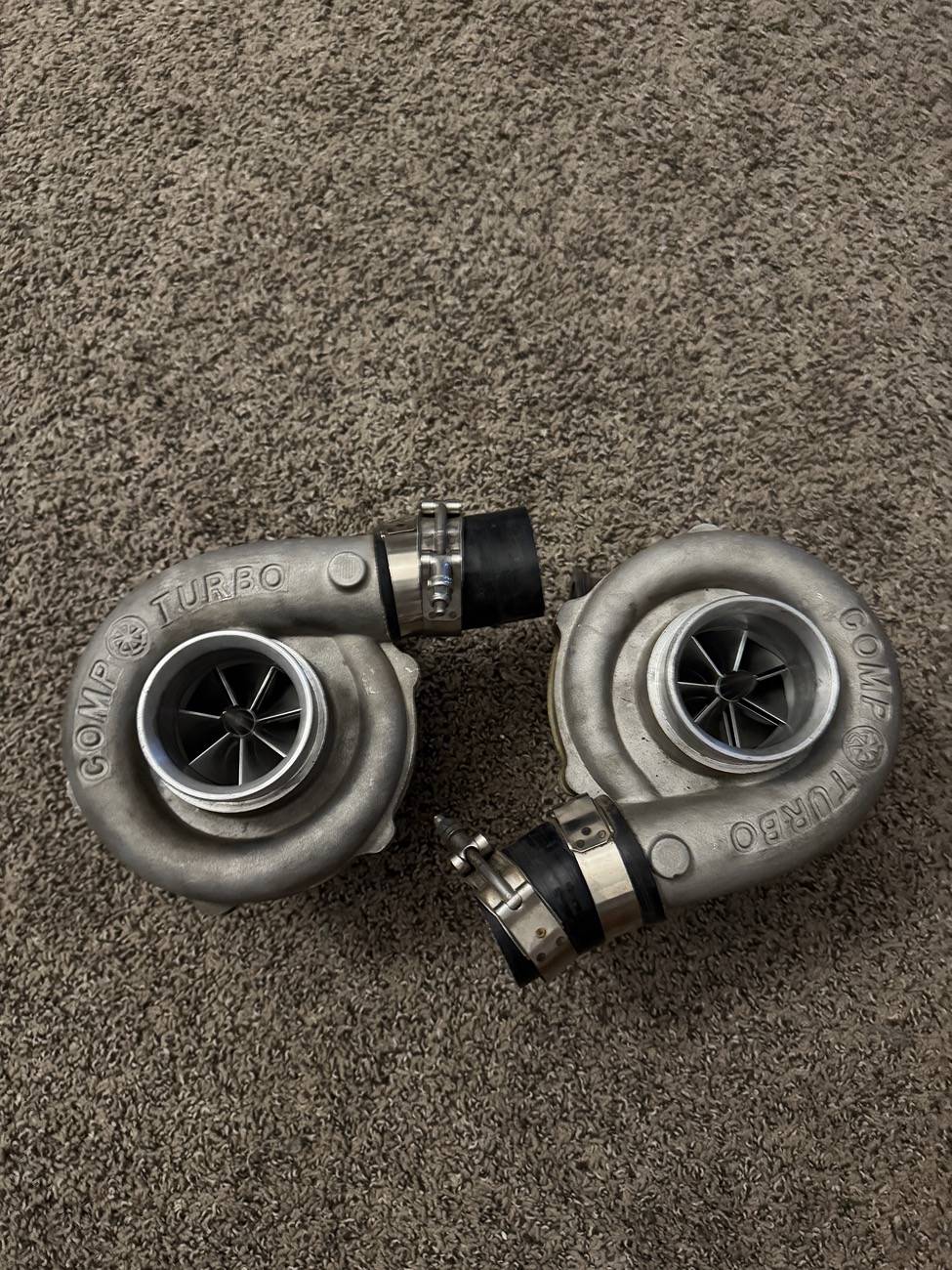

Yes it’s their bottom mount kit! Here is some photos of it in some boxes

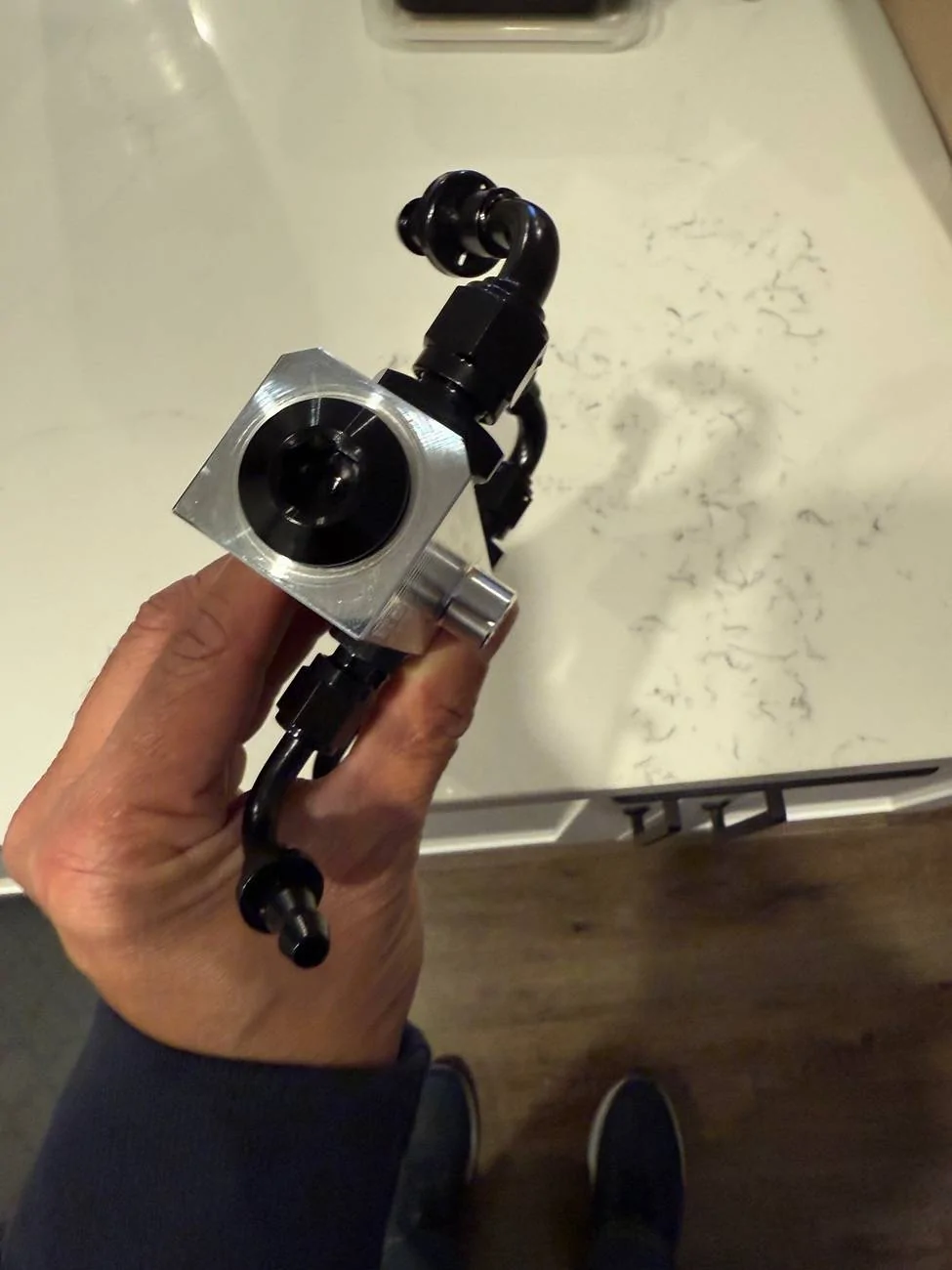

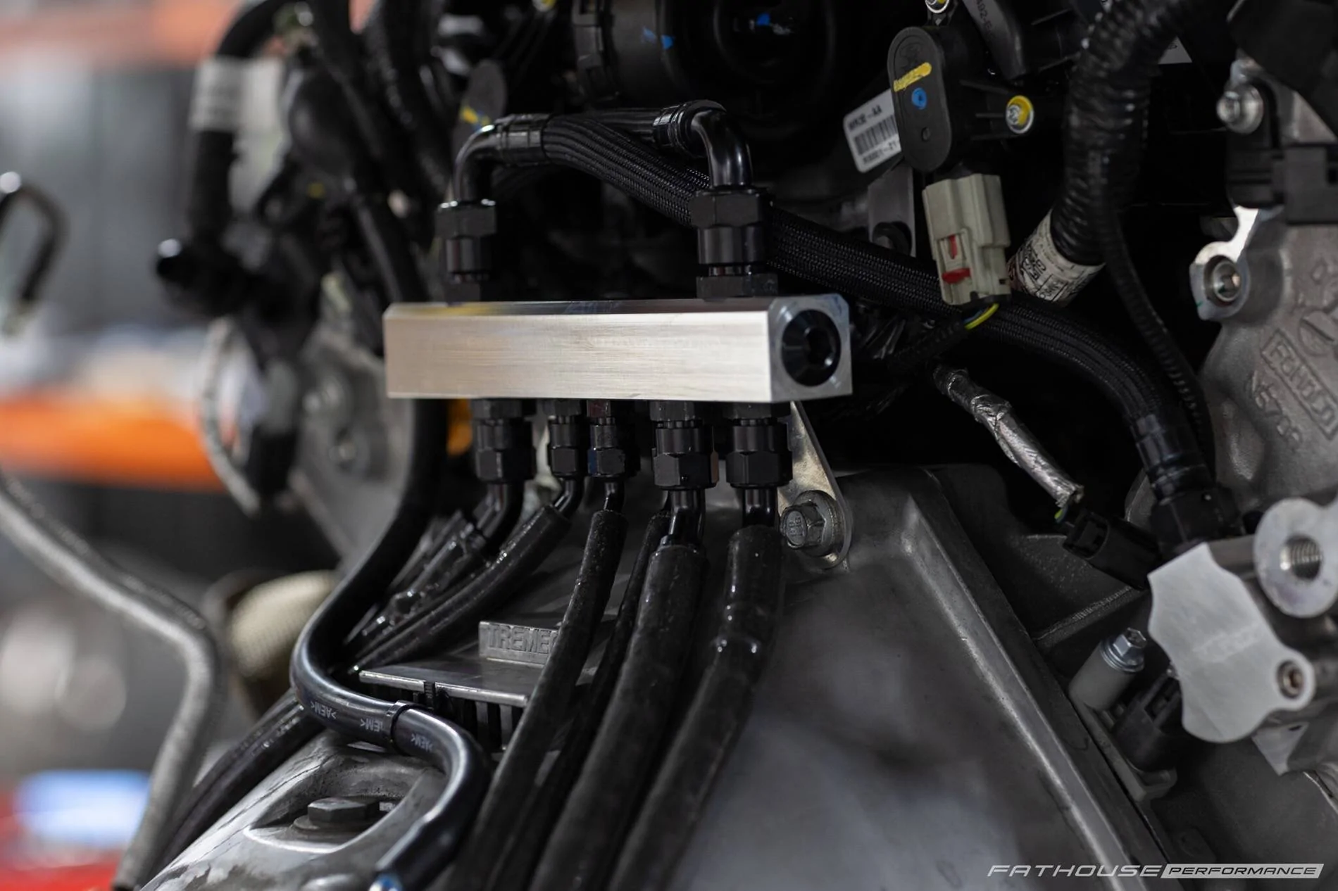

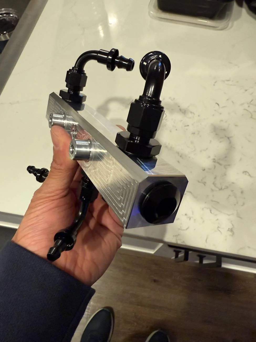

Copy that. Have you seen the FatHouse Fab coolant distribution block? They should make your coolant routing go much more smoothly. I bought one for mine to cool my wastegates which have coolant ports on them. See pics.
That looks really good will have to check that out!

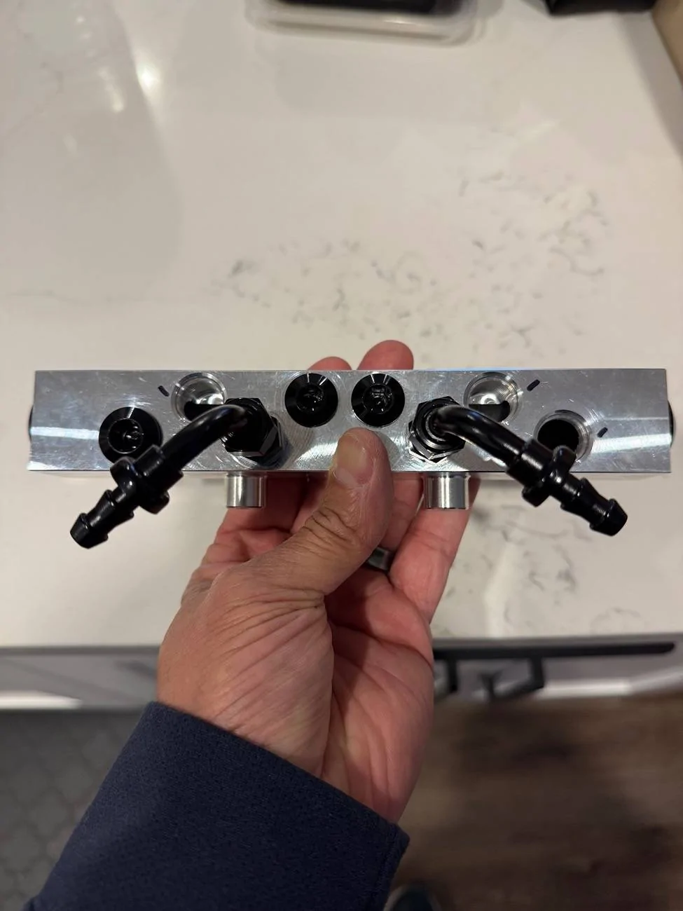

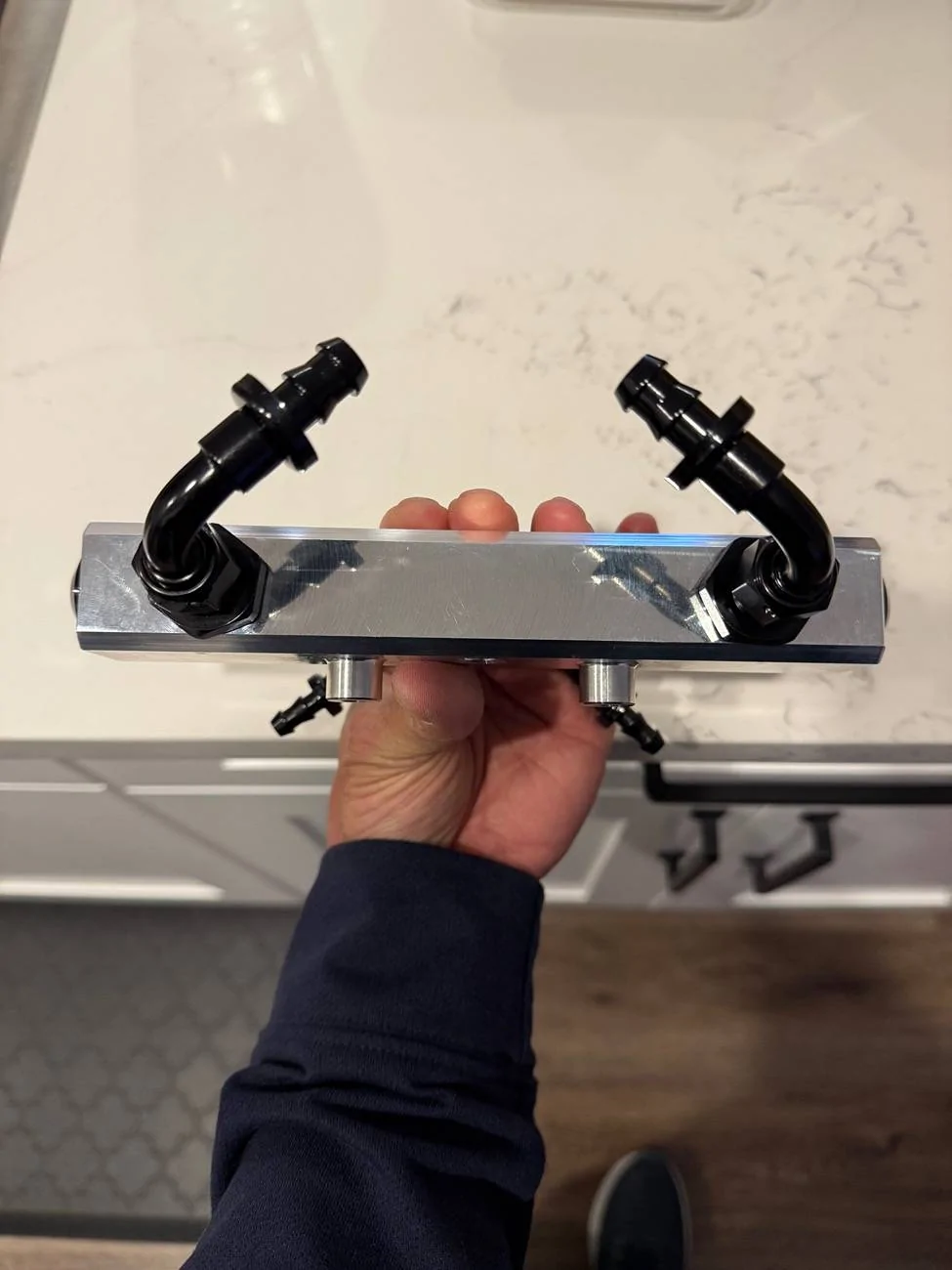

They’re only $100.

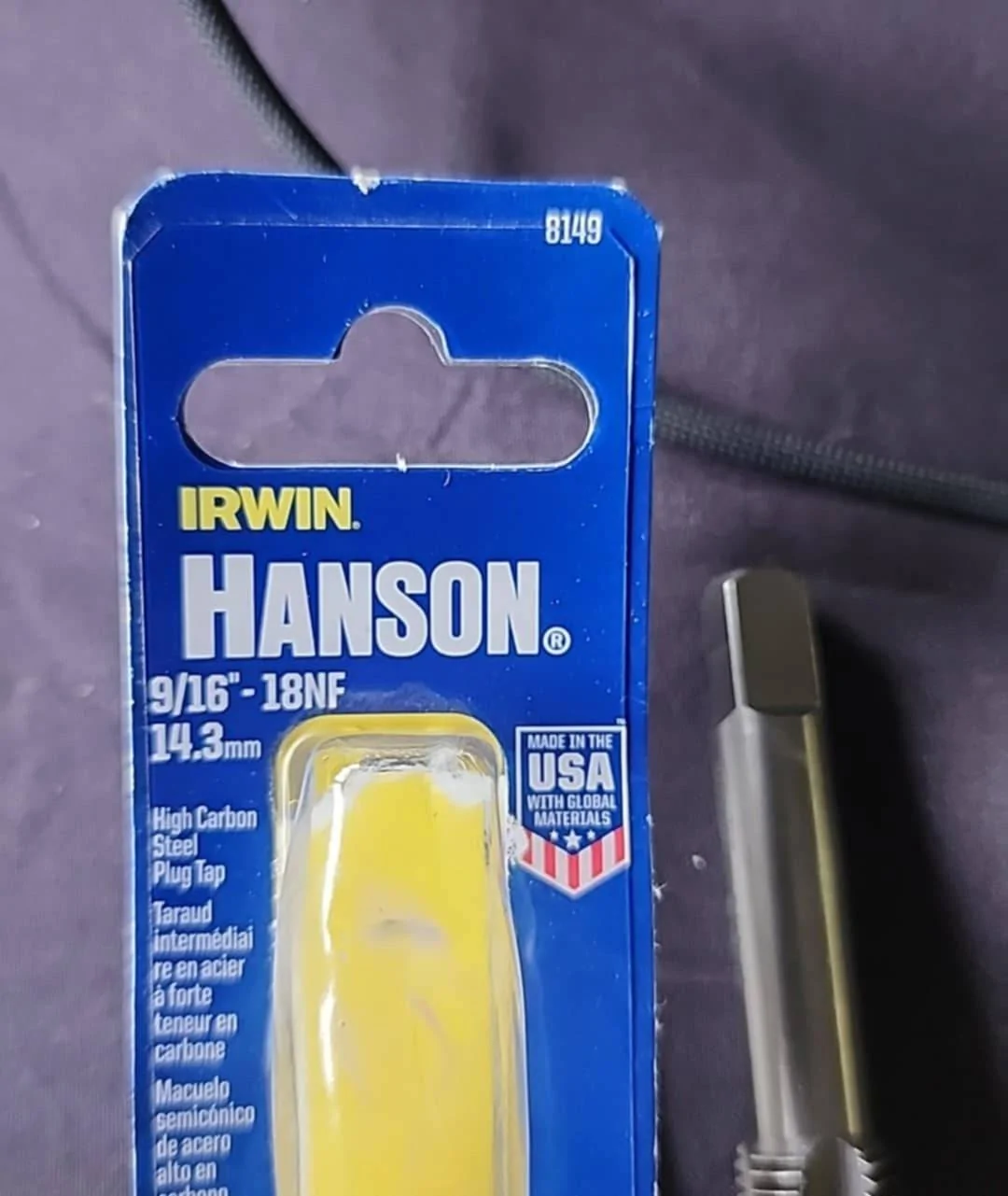

Note: If you look at mine you’ll see three black sharpie marks next to empty ports. The threads need to be chased in those. My buddy also bought one and the threads in those same three ports had to be chased. It’s an easy fix, but just wanted you to be aware that this may be a possibility if you buy one. FatHouse was notified of this too. I haven’t chased mine yet, but my buddy has and he’s already installed his. Here’s a pic of the tap that he used.
Did you use special lines for the coolant lines since they go so close to the exhaust and turbo?
I haven’t begun my install yet. I will use silicone or coolant rates hoses with heat sleeves on mine though. That first pic was a screen grab from FatHouse’s website.
