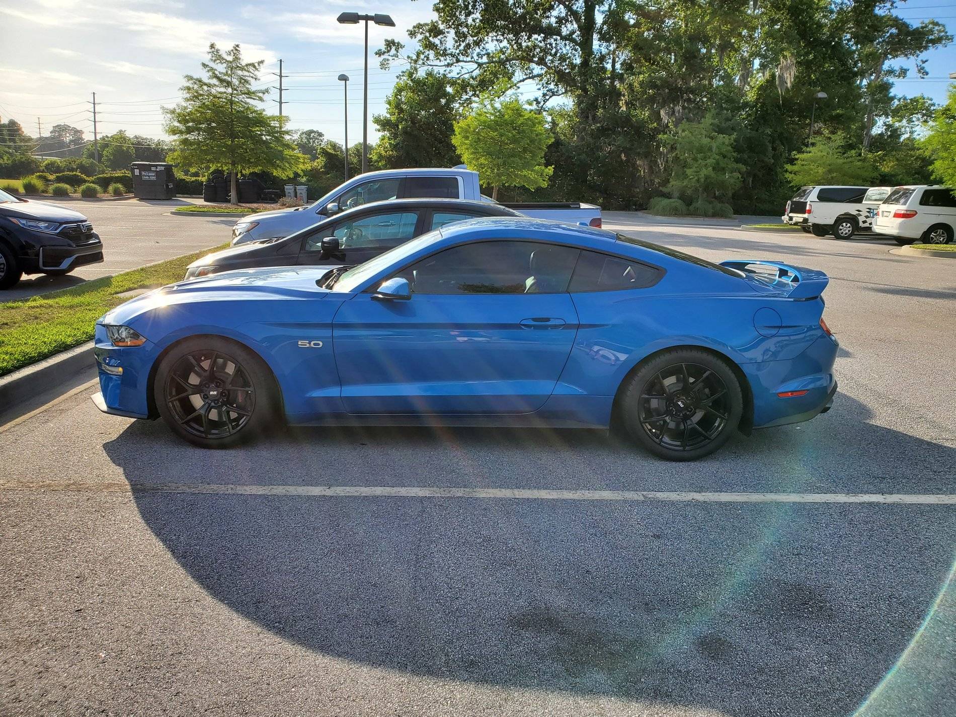

Well was getting car ready to go for this trip, i had decided to load up the new wheels and do everything when i got down south. Unfortunately I couldn't tetris my way into getting all 4 wheels into the car. So, decided to mount up the wheels for the trip. Quick test drive and they ride and feel like stock, obviously a uptick in tire noise due massive upsizing lol. Stay tuned for before and after pictures.

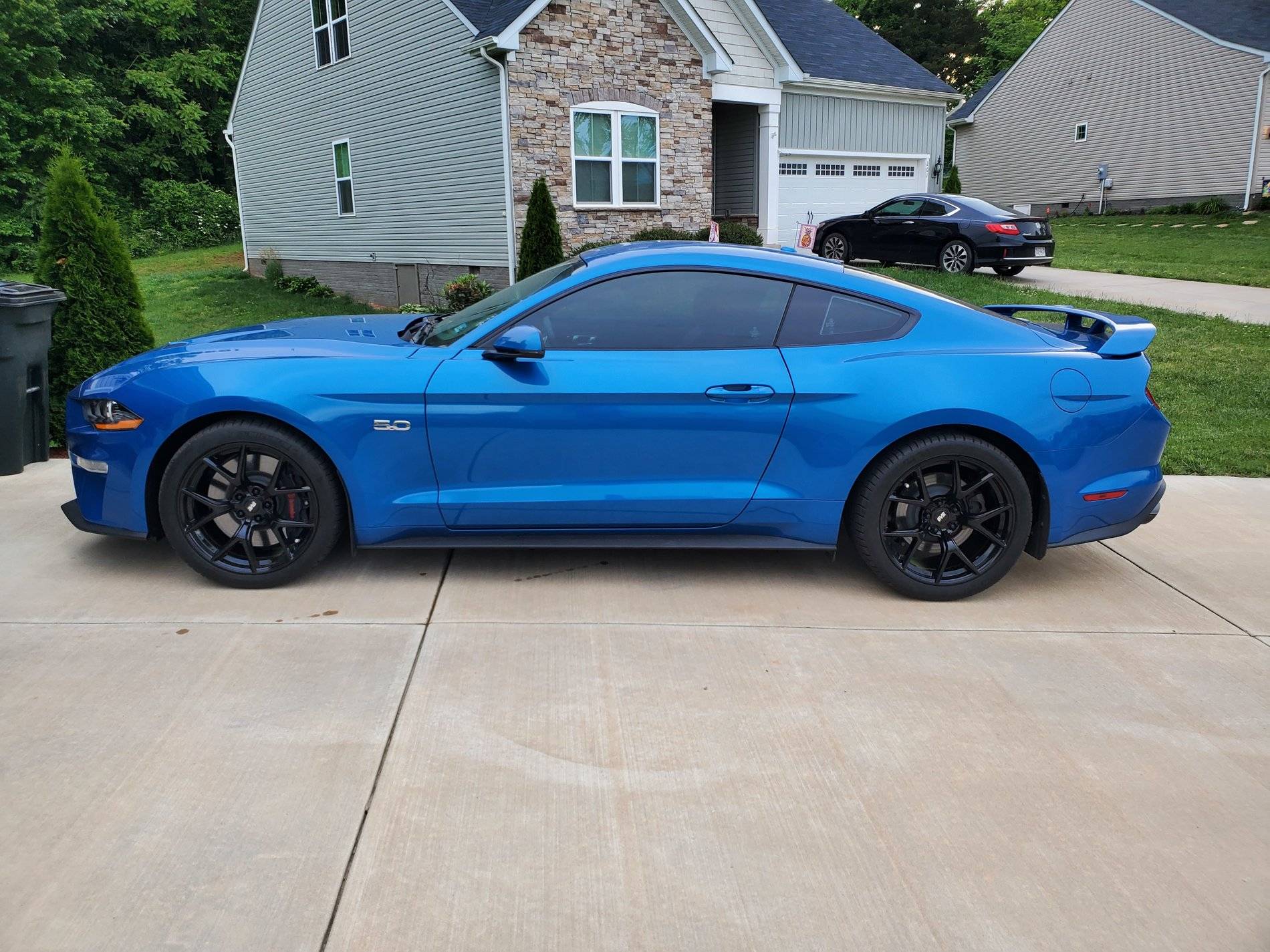

Alrighty, here are the before anf after of the install. Super happy with the end result.
