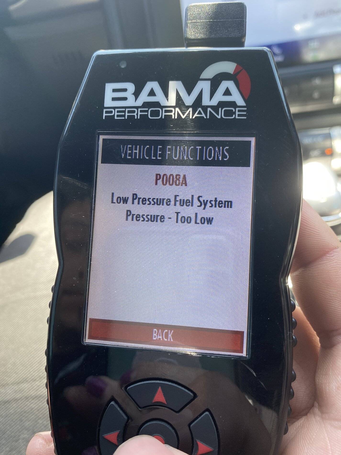

You had low fuel pressure and lean codes. Replace the fuel pump.

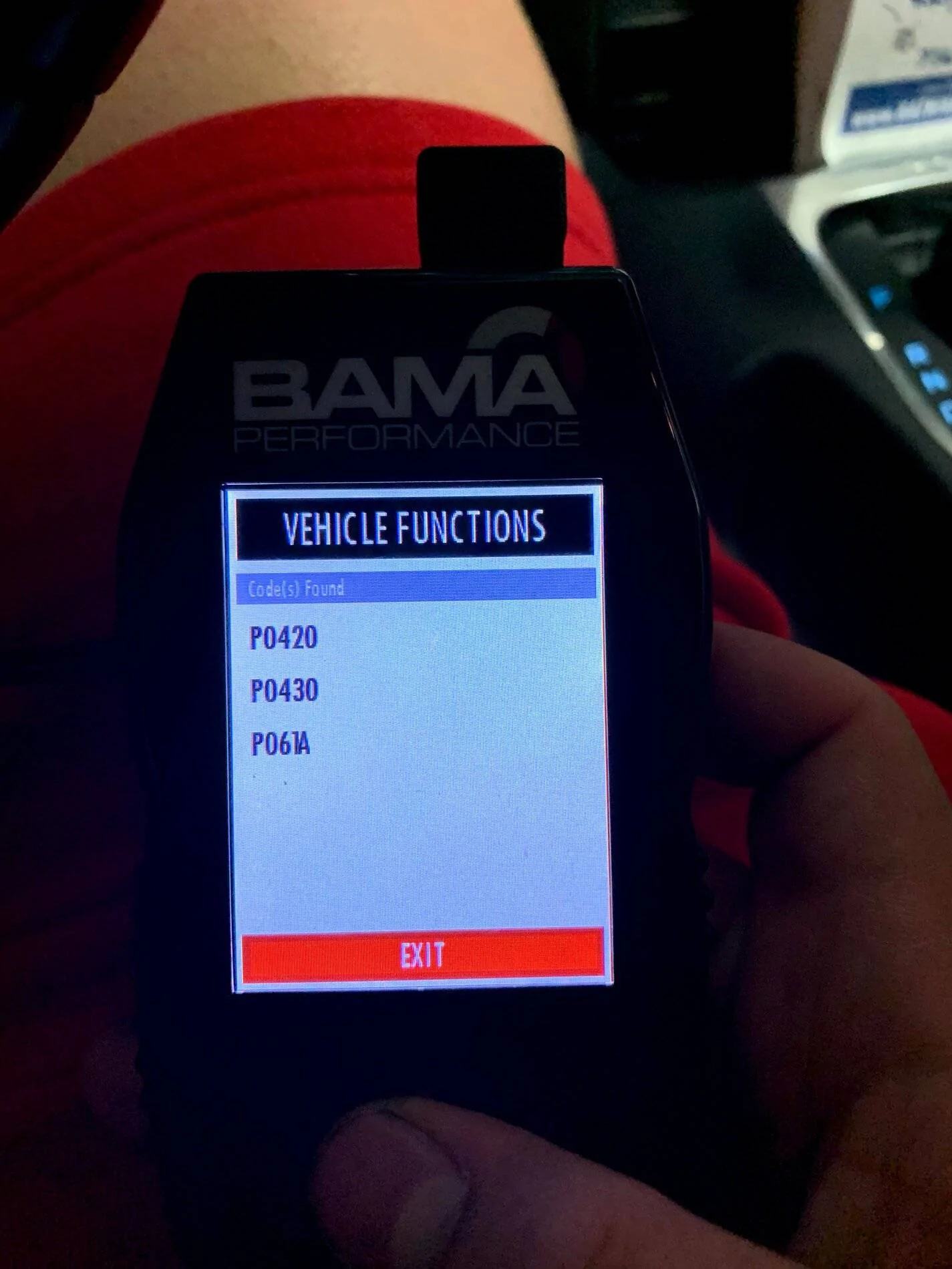

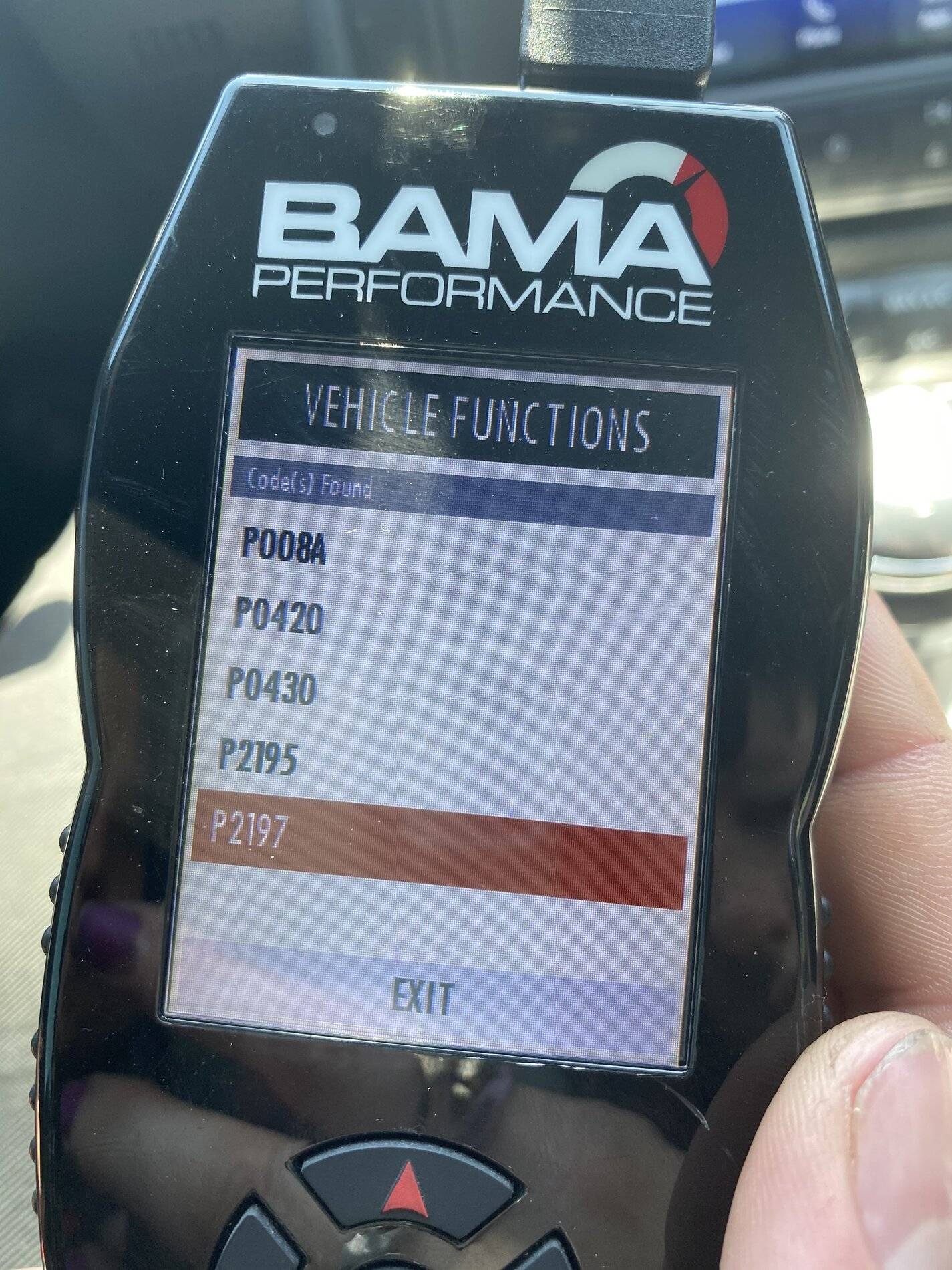

I did get code P061A back in July of last year related to torque converter performance and I never got that code again so you might be right I do have an extended power train warranty but I don’t know how to explain this to the service advisor

But than how would the low fuel pressure code have to do with any of this

P061A is a torque calculation error, not a torque converter error.
Fuel pumps last around 100K using gas. You have e85 so it is working harder.

Does the P061A code set again after you clear it?

E85 and fuel pump wear, I seem to remember something about that. Dan could be on to something.

The thing is with the issue I have no lasting check engine code they all go away and it’s sucks cause it doesn’t leave me with much
