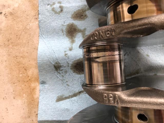

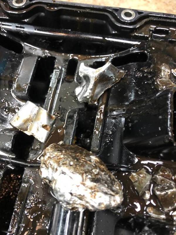

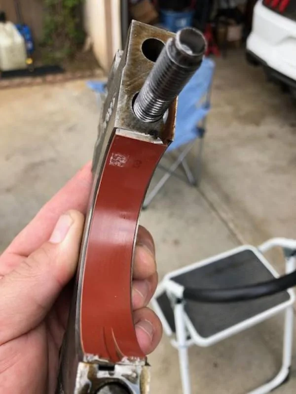

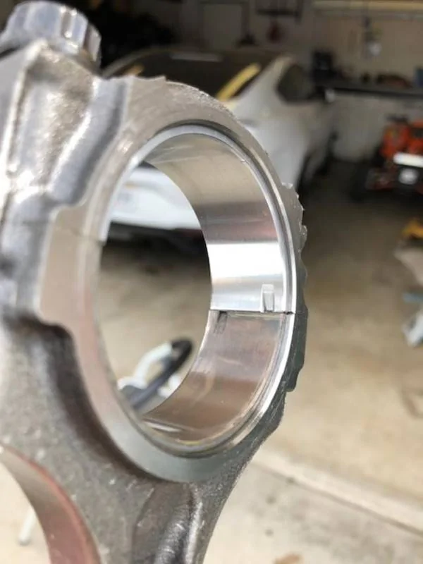

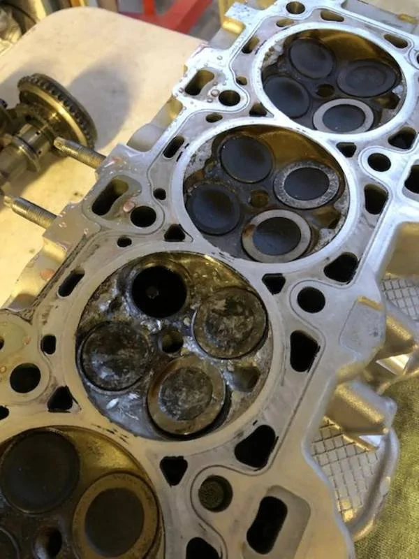

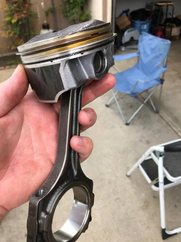

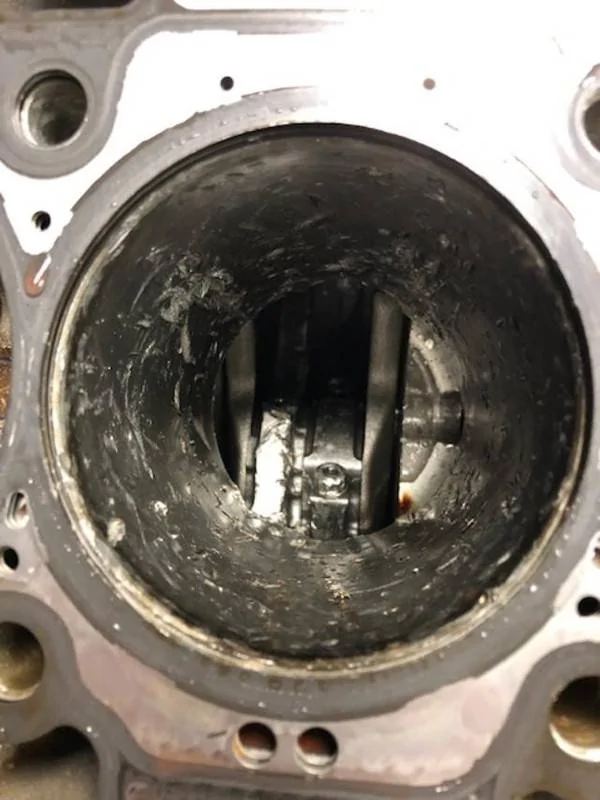

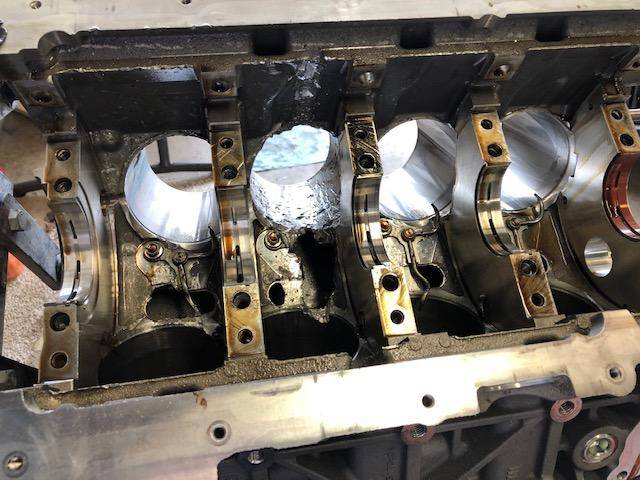

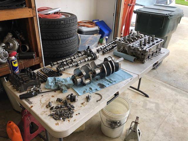

That looks beautiful and rods/pistons look familiar LOL. I finally a got around to tearing my motor down and she's blown up GOOD lol. Number 3 piston failed and took out just about everything with it.
Looks like i have more money to spend (heads and crank).

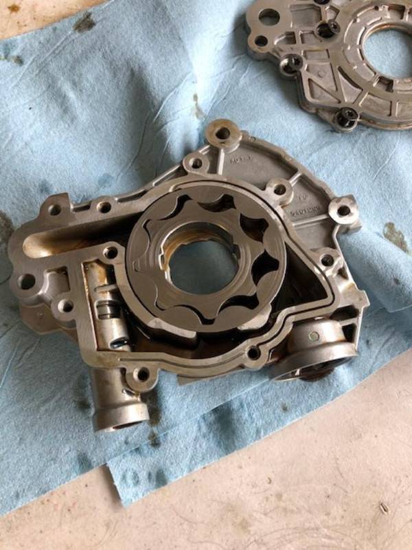

But can anyone guess what survived unscathed?? That's right......... the dreaded, "weak junk, crappy" oil pump gears! Hahahaha... i wish the stock pistons were nearly as resilient as the OPGs...........

It sure as hell was doing both when it let go lmaooooooooooooooooo. Spy hunter smoke screen for about a mile on the highway at 100+. Good times.
No... motor was healthy prior. I was running below 1/4 tank fuel and took a buddy for a ride and turned up the boost... bad idea. Appears piston failed taking out everything around it.
Funny because the remaining rods/pistons looked really really good... almost no wear on bearings at all.

Yes, im kind of shocked how cheap heads are.. i should have a set on the way soon. Despite how trashed my old motor is, im surprised the cylinder walls held as well as they did. I was expecting to see broken block at the top of cylinders at the head gasket area in the water jackets. IMO, thats the weak area of the Gen 3, but mine held in that area which gives me confidence on the new gen 3 i have.
