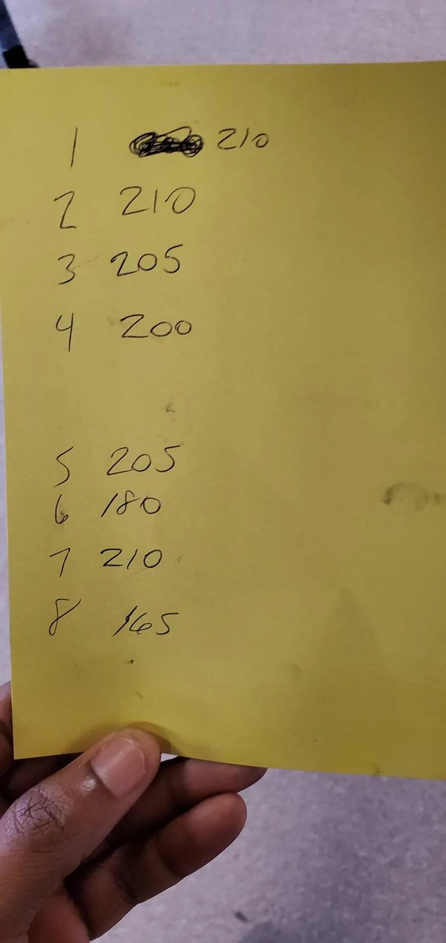

Noticed oil spitting out of my oil separator breather under boost figured I get a compression test. Car runs normal, no smoke still has plenty of power but the compression test says other wise. Going to build the motor. Tuner said I can drive the car but make sure I stay out of boost.
Here are the results

Looks like #6 was going too...
Was it misfiring too or just the oil spitting out??

Lol exactly. I figured it was coming. Not even mad. Just have to build it stronger.

I plan on building it but not right now. I'm thinking if I stay out of boost I should be fine. I'm hoping anyways.
