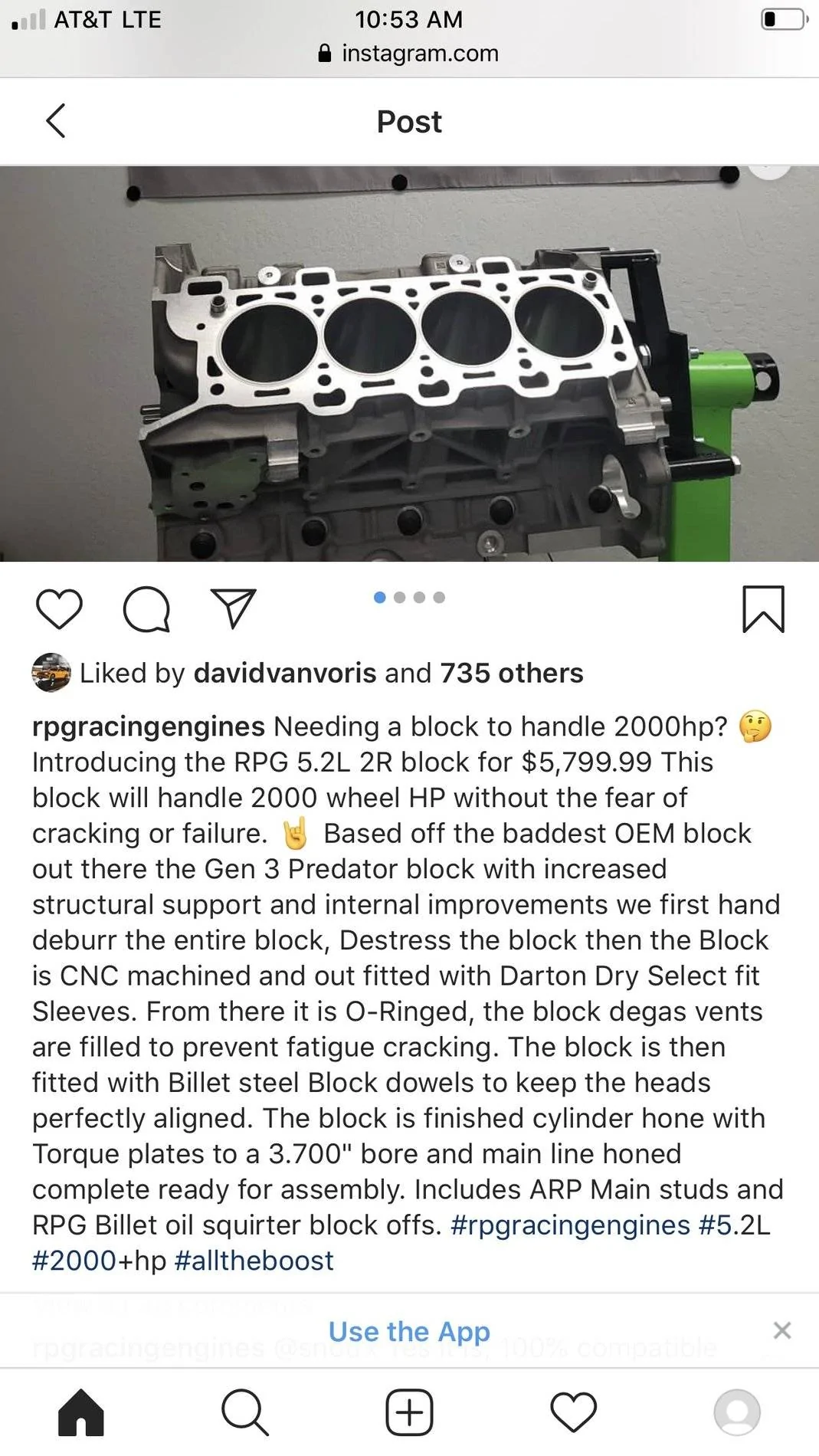

I decided on doing the 5.2 , he said something about it coming from the new GT500 blocks. I will post more details when he sends me all the specs.
$5,800 is that just for the block? No internals?
olaosunt
Jan 10, 2015
72
4,291
1,575
Indiana
Guard,base,M6,KB-2.DIB,auto,Hellion TT,2016 GT 350/Gen 3 Whipple ,2018 Mustang GT/Gen 5 Whipple
I am afraid so . The bare block before additional upgrades retails for about $2500 shipped .
Sleeving a block runs up to $3K .
yes sounds right and I'm upgrading internals as well =( going to cost me close to 10k maybe more
