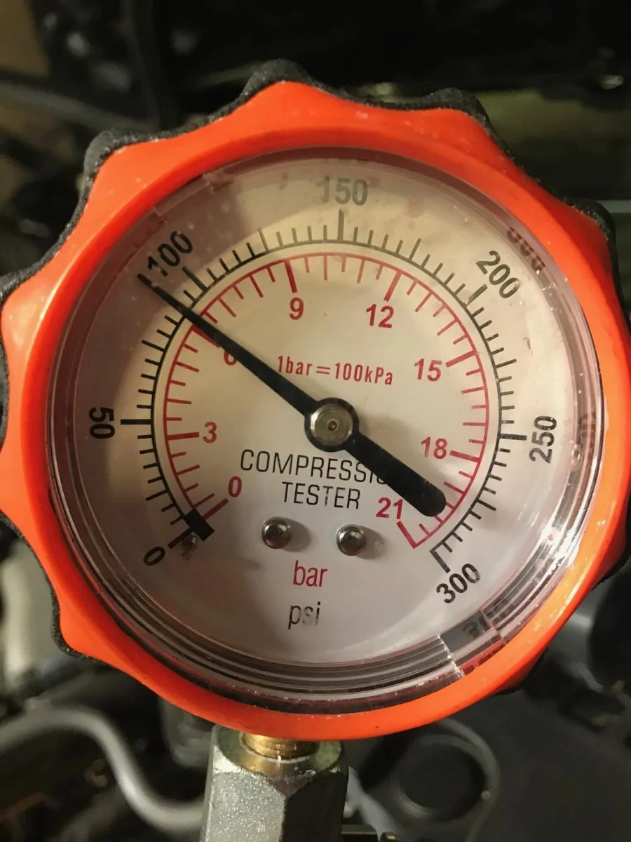

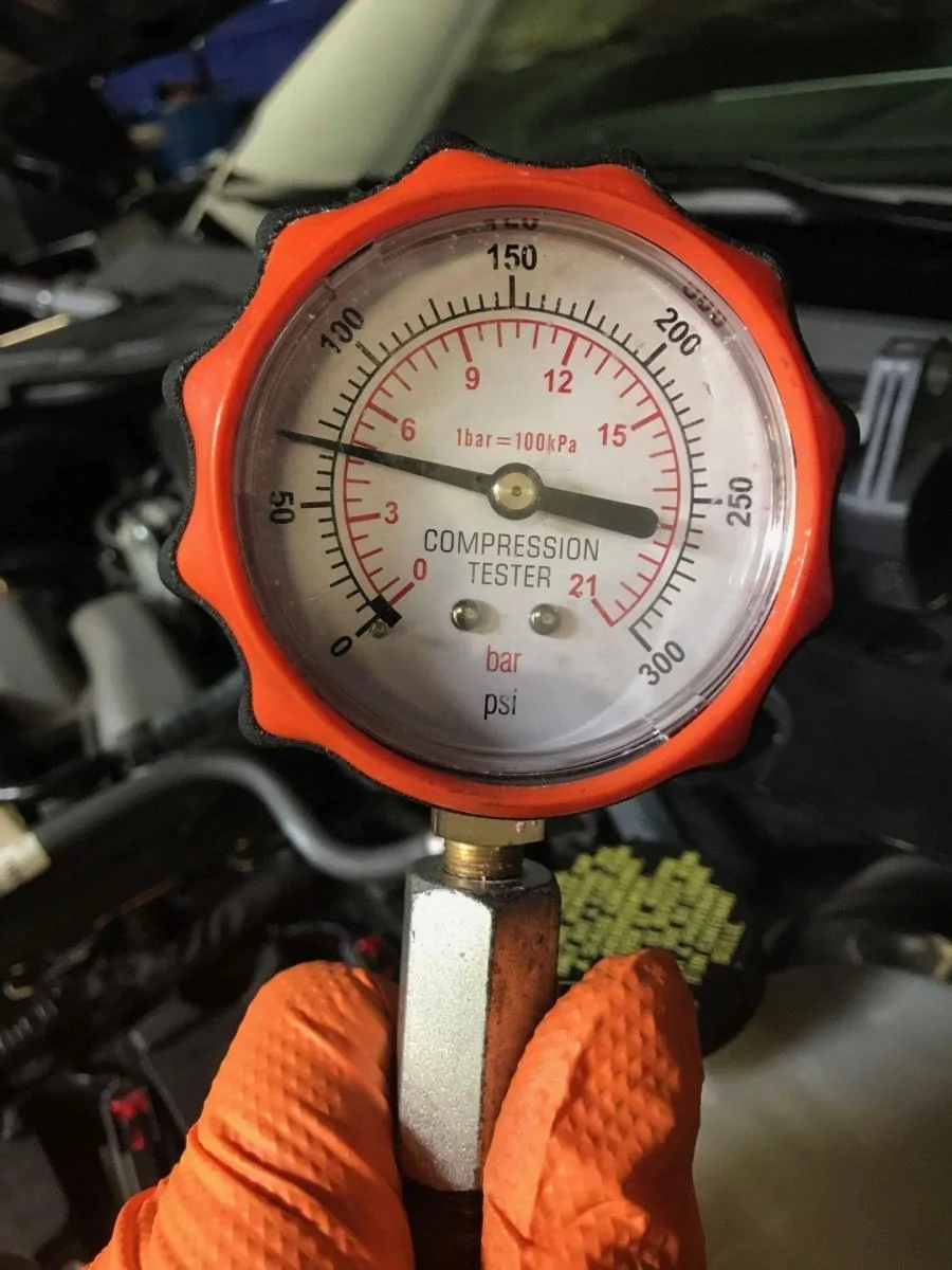

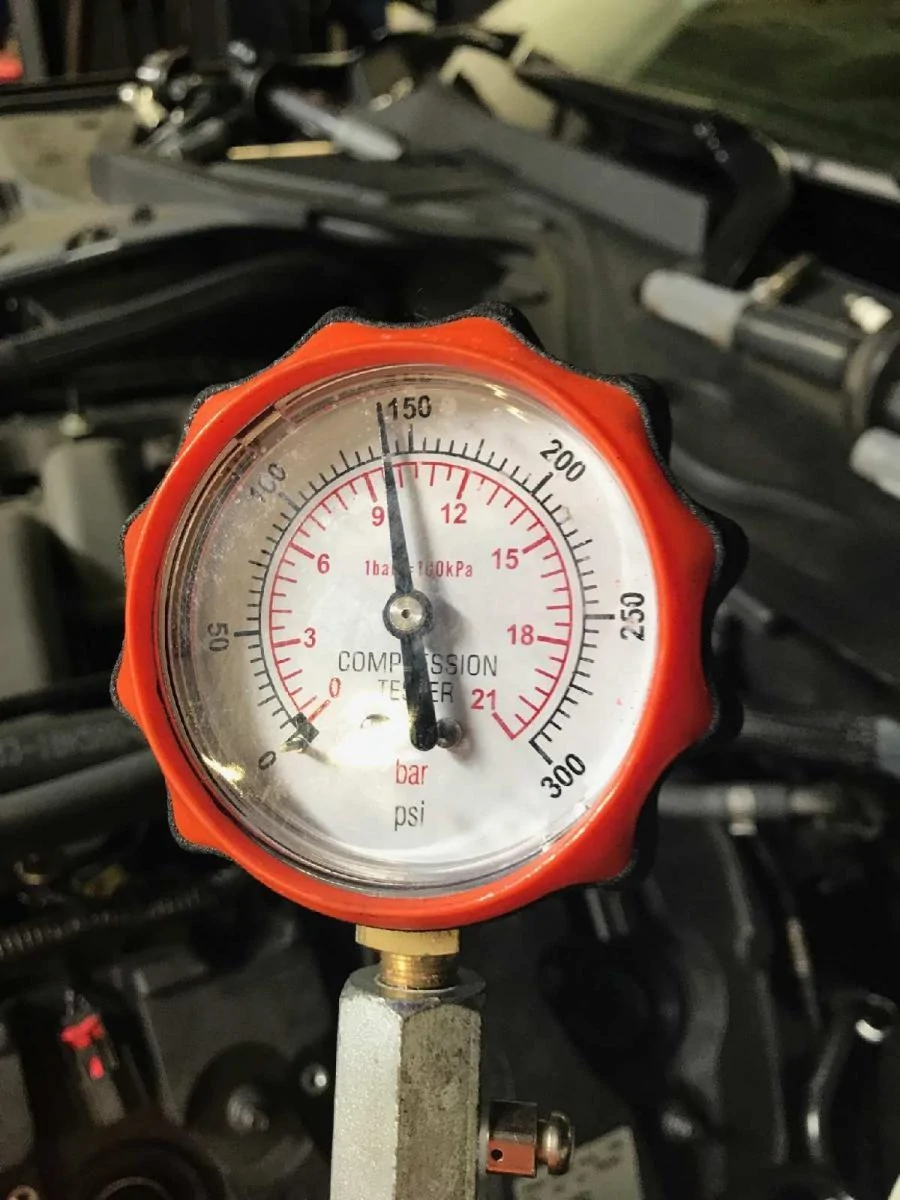

Just an update the ringlands on both cylinders were intact, but as soon as the piston came out, they just crumbled. No cylinder scoring. Anyway I had a new short block installed for free. Don't ask.
Crazy! Guess the cast pistons had enough.
