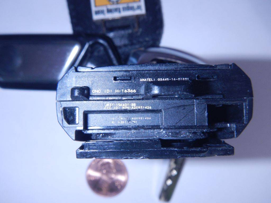

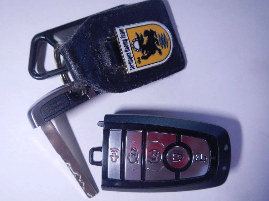

No and you have to pull the key out of the Fob by pressing the release, lift the back cover off, replace battery of the CR2450 type. On my 2019 anyway.

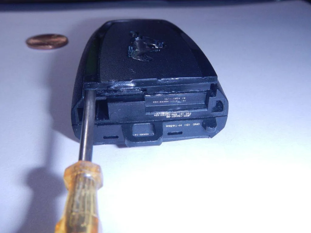

"Lift the back cover off" sounds a good deal simpler than my process: I had to use a teeny-tiny screwdriver to get the back to release. Not the craftsman I used to be, I guess.

Both my keyfobs gave me a low battery message within months of each other. The fobs for 2015-2017 mustangs take two CR2025 batteries. It's fairly simple to do, and the only tool you really need to do is a coin or something to pry the shell apart. There's a couple of youtube videos that'll show it. Pretty simple.
