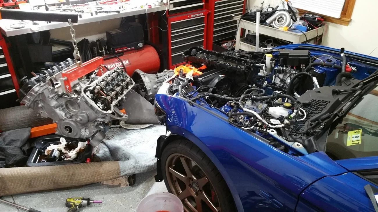

Well, It's been a while since I lost compression in cylinders 7 & 8. The car has been sitting for months waiting on the new shortblock, parts, etc. I finally got the energy to start taking it all apart. It's a lot of work by yourself. lol
(for those who don't know, 13k miles on the car, 9k of which procharged. I did not baby it. Lots of roll races to near 160mph.)
Here are the results of the teardown...

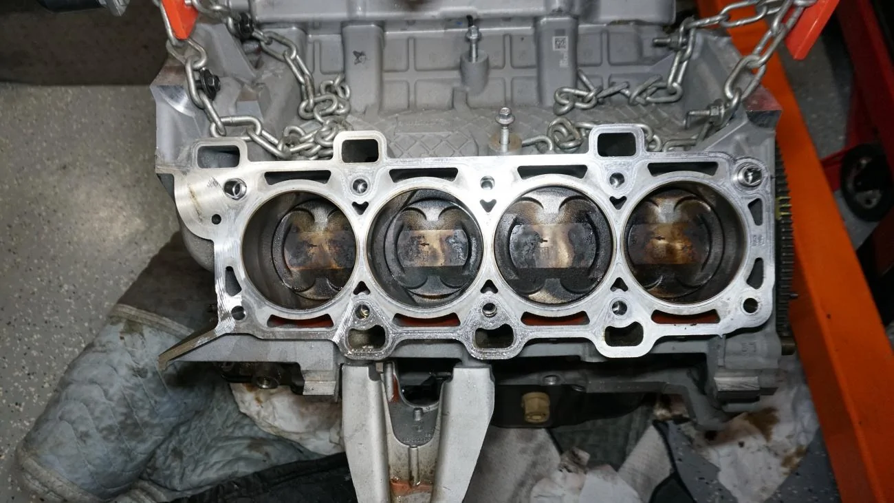

Cylinders 7 & 8 on the right, which is drivers side near firewall.
And the answer is... When I first pulled the piston out, I could barely see the cracks, then I pried the broken pieces out.
Both pistons broke in the same exact spot. And that side is at the top of the motor. All the rings are intact and solid.

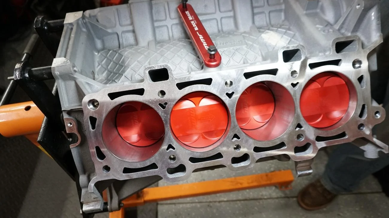

New Shortblock going in. Brand new block, Manley I beams, Manley forged pistons, Boss 302 Crank, ARP everything.

Ahhh...Those Coated Manley pistons look sick!

How did the cylinder bores, cyl head chambers, crank journals, rods and bearings look on those two holes? Damn that almost looks like you were throwing nitrous at it - those pistons saw some detnation/rattled in those holes. New shortblock setup for boost I'm sure. Nice work.

Piston rings butted from getting hot. They are pretty tight from the factory, along with the bearing clearances. Detonation didn't do that.

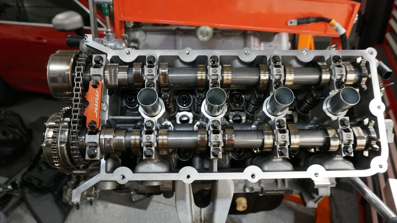

Are your cam lobes blue or is that an illusion?

Great choice on the setup. Who built the shortblock?

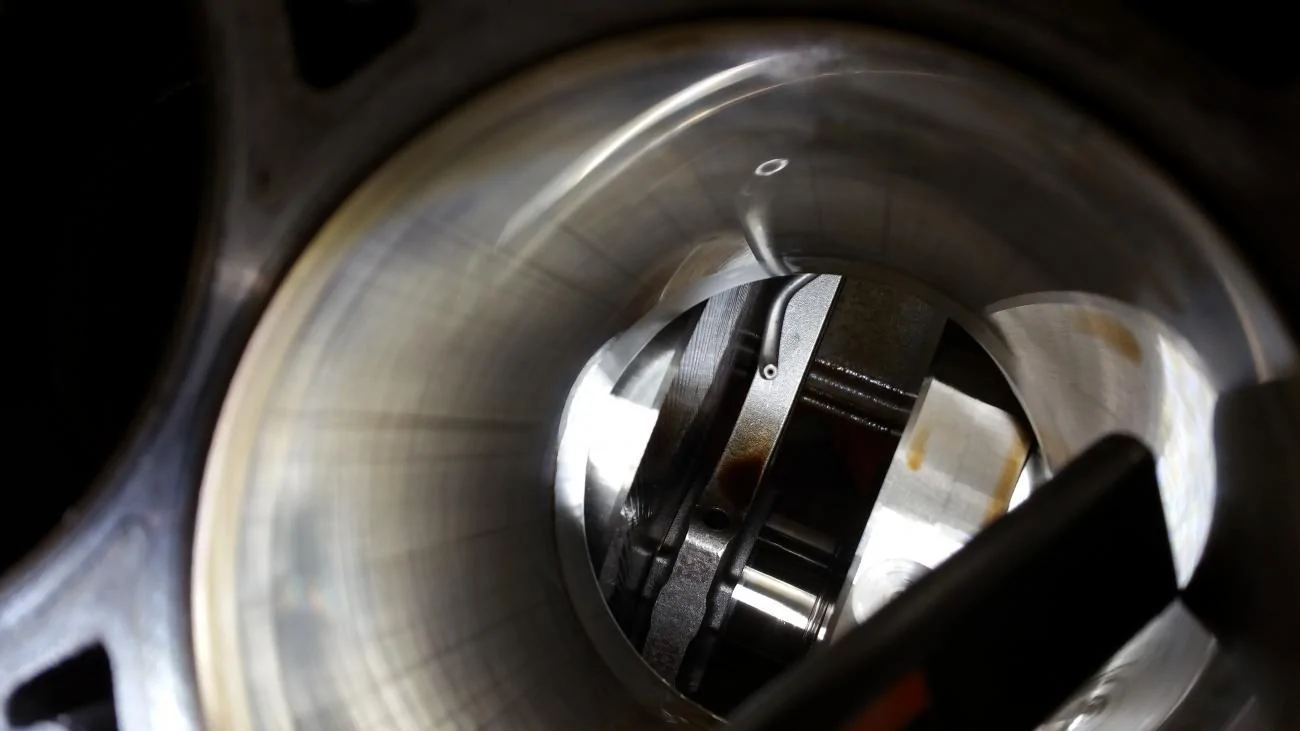

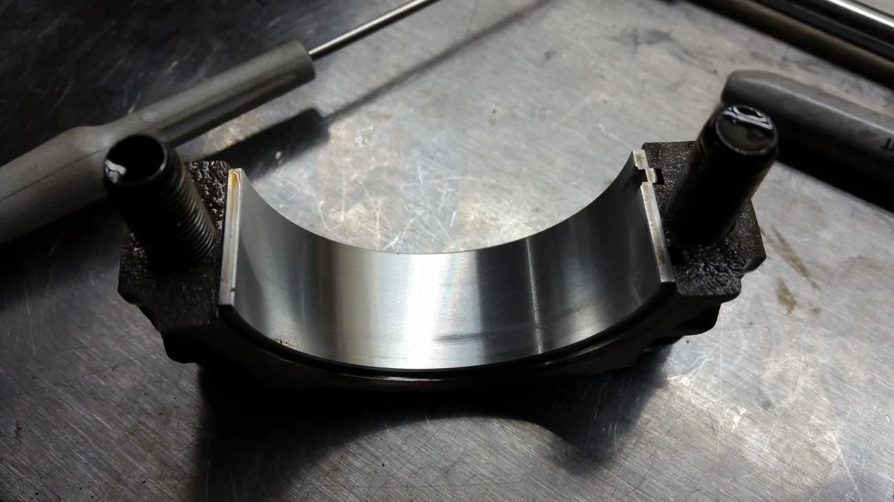

The crank and rod bearings look perfect. They are super smooth. That little mark in this bearing picture is a light scuff mark and you cannot feel it. All the cylinders have those vertical scratch marks, you can't feel them. I'll have to take some pictures of the cylinder heads, but they look perfect too. I had to pry those pieces out of the pistons. Engine ran fine and was very smooth, but had a lot of blowby and compression was down.

It was lund tuned, logs were perfect, 93 octane. Hitting up to 11-13 psi at 7500 rpm. Most time though it was 10-11 psi.

Must be an illusion. Cam lobes have regular wear. Super smooth.
