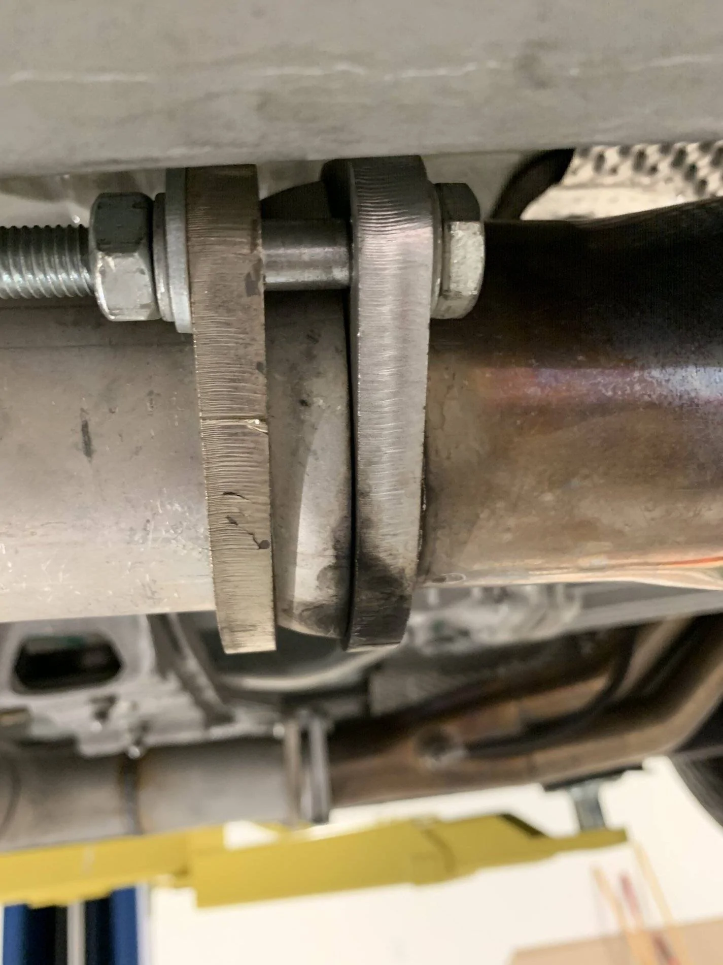

Are you guys making a gasket where the long tubes connect to the mid pipe or just bolting it together? I bolted mine together and I have a small leak that I can't get to go away no matter how I position the clamp. Curious if I could use high temp rtv to seal it.

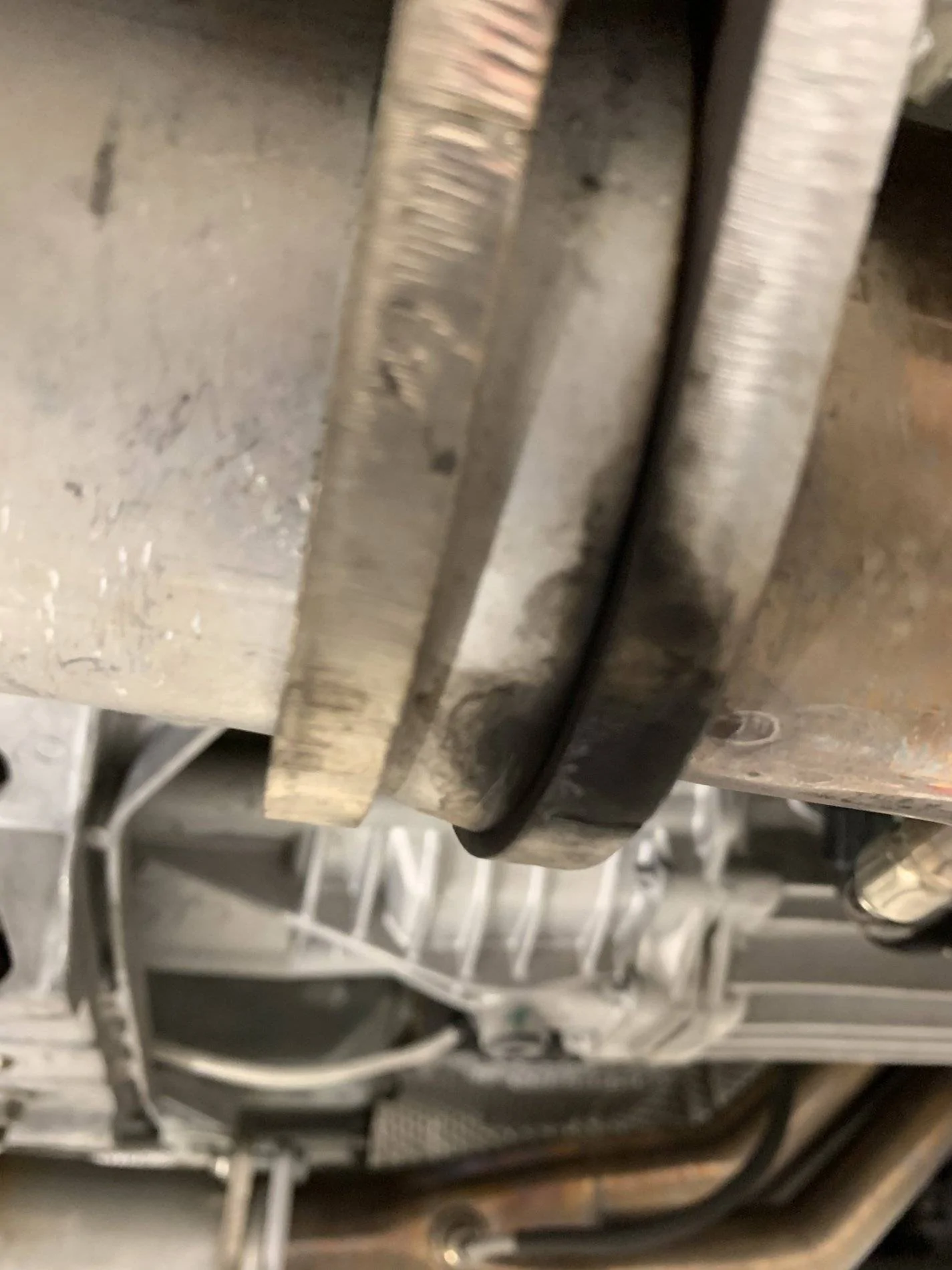

It looks as if your mid pipe is bottoming out on your long tube side bracket.
It does bottom out on it. I tightened the shit out of it to try to seal it up and it still leaks. I even put washers in to try to take up some of the slack on the bolts and it leaked worse.

The more you tighten it now the more its going to spread your socket flange side, the more it will leak. That bracket on the ball (long tube) side needs moving back about a 1/2 inch. Is it tack welded in place?

Imho that looks like it is not formed right. I think you are fighting a bad part.
