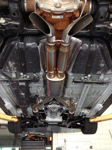

103db is a fairly liberal level and unless the car is without cats and has long tubes you will likely pass. Using a phone app will give you a good idea of what to expect and knowing the process they will use to measure is going to be helpful. If they say they are measuring at 50ft, I would make all my measurements at 40ft to give myself some wiggle room. Also temperature, humidity and all kinds of environmental conditions factor into the reading so it may be a good idea to do more than one test if your first test results come back close to the limit. Also sound is an accumulative thing, so while your car alone my be within limits you running close to another loud car may put you over the edge so its best to have a 2-3db safety margin. Some tracks will give you a warning if you exceed the limit and give you a chance to solve the problem others will tell you that you are done for the day until you make a significant change. The local communities are driving this issue and some have imposed fines and other punitive actions on the tracks for exceeding the noise limits.
My car is flat out loud, it is headers, no cats, simple single 2 in 2 out muffler and dumps just past the axle. My car measured 98db at NCM on a 75* day. I had to rework my exhaust several times to get it below 100db as that was my target. I had to add the 2 additional resonators to get it under 100db as I would consistently hit 101db without them. Dumping the exhaust under the car instead of out the back made the largest difference when measuring from further away from the car. Hope you do not have to change anything but if you do this works and was simple to build. As easy as it is to change the exhaust you may want to consider a loud and louder setup and change it when needed.
Here is an my exhaust layout
