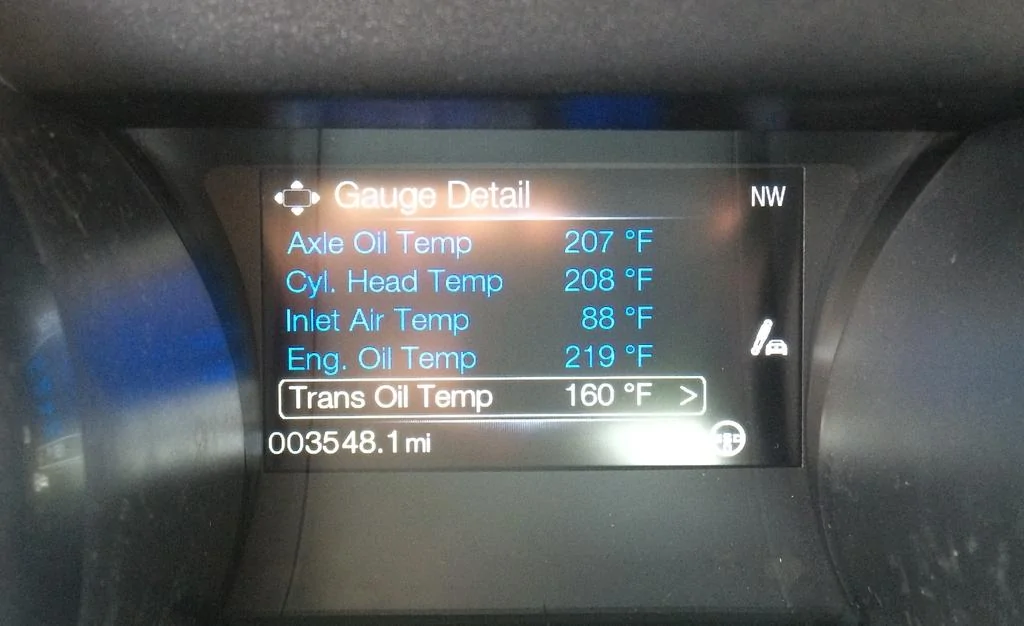

Just did a track day at Laguna Seca which I will add to my "Trackaholic's GT350 Experience" thread.
Somewhat pertinent to this conversation are two points. First, there was a second GT350 at the event (a tech pack car), and the driver went into limp mode on his first session. I don't know how hard he was driving, but he implied that he wasn't pushing very hard.
I have a track pack car, and the temps were fine. However, I was way over the sound limit and was keeping off the throttle (I was the first GT350 to go out, and asked for a sound check, and failed spectacularly, so I had to be very careful from that point on, which meant I wasn't on the gas hard at all for the rest of the day).
Also, it was relatively cool @ 64 degrees.
Anyhow, attached is a picture of my temps after a half a lap of cooldown.
-T

Thanks for that pic. It's starting to look like "the most track worthy Mustang ever built" is going to be a failure no matter what package you have. The tech pack cars go into limp mode after 10 min. and the track pack cars can't be pushed because they are to loud.
Track packs/R!s can surely be pushed. On straights at Homestead, Sebring and PBIR I floor mine like Fred Flintstone. I shift at 8000-8100 rpm (I have my shift lights set at Track and rpm points set at 8k). You can see in my vids I wind it up... no issues. Highest trans temp I have seen is 168*... heck my Z06 hits 210+ trans temp and that doesn't go into limp mode at those digits. I WOT that up too! :D
Ask the OP.... when I took him for like 4 laps at PBiR, I was moving pretty quick and revving high. With this car the monicker- "don't lift, don't shift" is bang on! :thumbsup:
