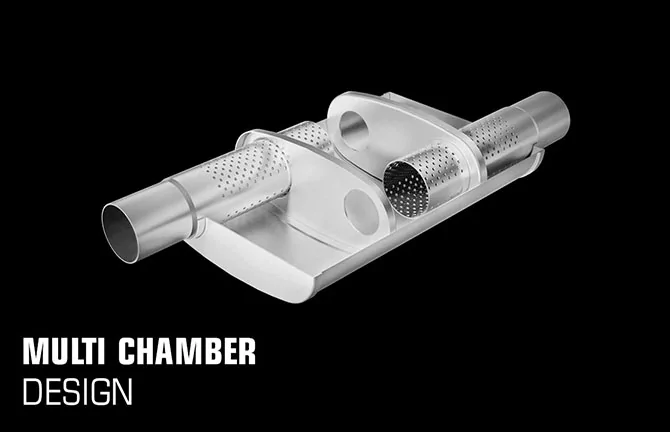

I did some search and couldn't find any EBs running Magnaflow XL mufflers. Diagram for the XL shows that it's a three-chambered design, similar to GT ones but with perforated inner pipes for better flow. Anyone here has experience with this or similar mufflers?

Thanks for posting but I've seen that one before. He's running a Magnaflow 12268 which is basically a Y-pipe in a muffler, similar to the Borla Pro XS that I'm running. So my setup minus the GT mufflers should sound close to his, maybe a little louder due to 3" DP and hi-flow cat.
I'm hoping that the chambered design of 13288 will be a little quieter since it's not a straight through like 12268.
