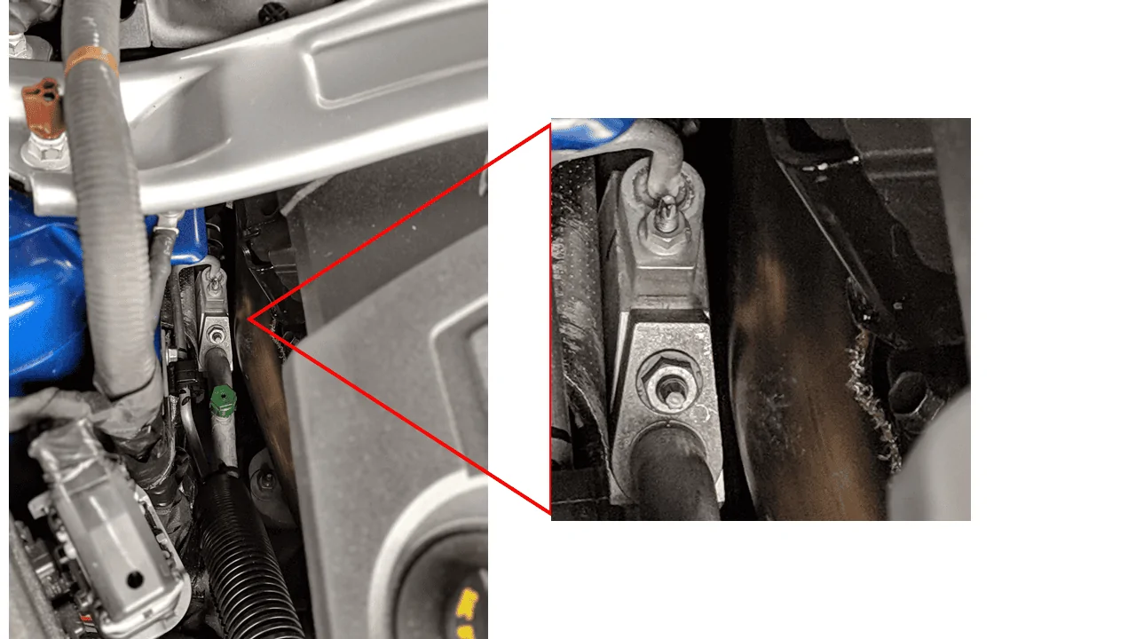

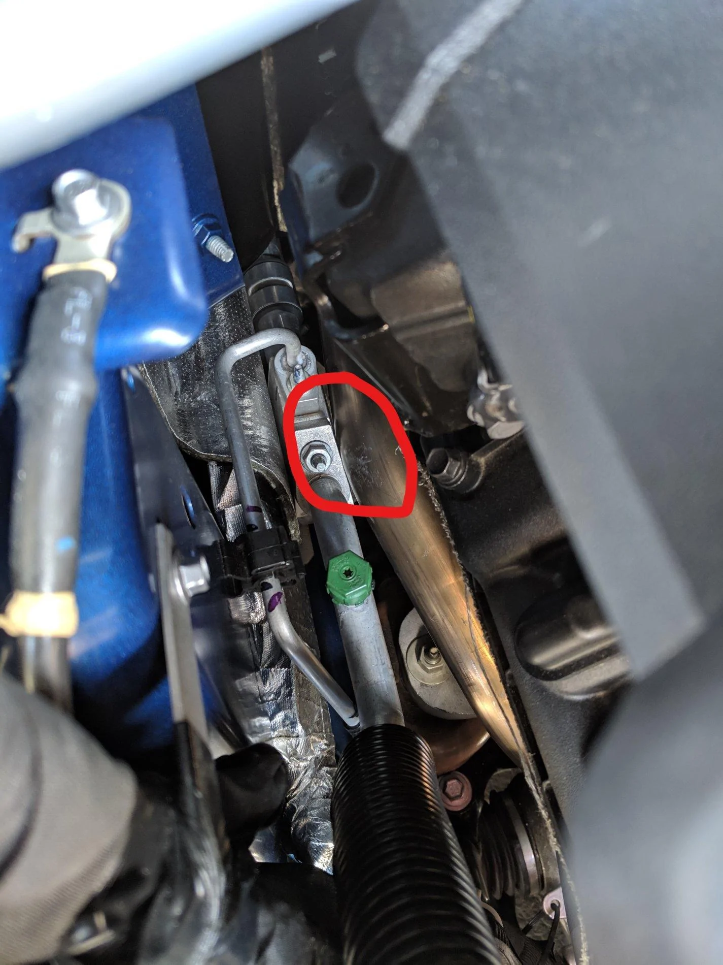

Hoping to get the car up on a lift this week to double check the entire installation. However, there is contact here:
As I've mentioned, I'm know enough to be stupid about cars--particularly a problem like this. However, I'm wondering if 1) that line can be relocated/reconfigured/replaced or 2) can I shim/shift the motor over to create enough clearance between the pipe and that line or 3) lower the engine enough to sink the pipe just below that line.
That is definitely going to create the thunk sounds - more so on acceleration and even when the engine is sitting at idle (metal rapping against metal).
That’s contact on the A/C line going to the HVAC system.
You might be able to tweak that line over so it creates a small space between it and the header. I’ve had to do similar tweaks in older 5.0’s when installing LT headers and needing clearances based on engine bay design and/or header manufacturer design.
The last thing you want to have to do is simple the header tube to make clearance (although may be last resort). I had to dimple the passenger side of a set of Ford Racing headers for my prior 94 Bronco - only PIA way to get the needed clearance on passenger side but it worked.
You can try to loosen up the engine mounts and ever so slightly move the engine to the side just a tad so it gives you the space, but be careful not to move too far as you could create an imbalance with the angles of the trans flange to driveshaft. You could also try shimming the engine upward which may give you the clearance too (hard to tell from your pics if side to side or up/down would do it).
Again very hard to tell from the pics, but is there any room to tweak or drop the pipe or exhaust down a little lower, which might move it away from the A/C line?
I'll have it on the lift tomorrow...apologize for that pic--it is hard to tell w/o looking from underneath, but it appears dropping the motor down roughly 1/2" might clear that A/C line. Otherwise, I'm wondering about somehow tweaking the line a bit...not sure how, yet, but I would think even a 1/4" would be enough space. I already had BMR motor mounts on my list...maybe it's time to put them on.

We went over the entire installation and found no other points of contact other than that described in the posts above. Not sure it was the wisest fix, but we simply pushed the A/C line away from that top pipe, which was the source of the dull, metallic clatter I was hearing in the cabin.

So glad I found this thread. I just installed the TSP Headers on my 18 and noticed after the idle came down I was getting a crazy tick metallic ping noise on the passenger side that I hadnt had before and I thought the worst. I did notice the primary was extremely close in the exact same spot pictured. I will give it a shot moving that ac line out of the way.
