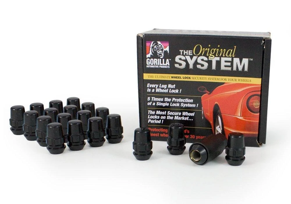

The new lug nuts are here !! The new lug nuts are here !!
Imagine how I'll be when the car arrives - LOL.
As promised the # 96643BDX version does completely cover the exposed "silver ring" around the opening, taper seems perfect !

You'll be happy, the BDX ones are just like stock.
Yep, the BDX ones cost a few $ more but fit exactly like the OE lugs (i.e. they have a wider "lip" where the nut meets the wheel & thus cover the "silver ring" that surrounds the opening).

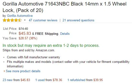

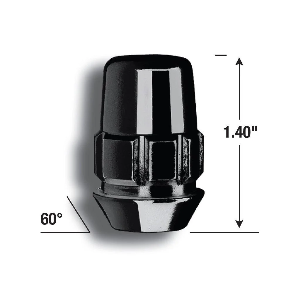

The Gorilla Automotive 71643NBC are NOT the ones you want. The Conical Seat contact area is smaller than the original lugs, NOT good for aluminum wheels tighting down @ 150ft-lbs! I bought these based on this thread and returned them to Amazon.
Gorilla Wheel Locks 96643BDX ARE the ones you want.
Key phrase here is: Conical Seat Type = Bulge
With these you will not see the "Silver Ring" of aluminum wheel showing around the smaller 71642NBC lugs, meaning you do have the design full Conical Seat contact area !!!

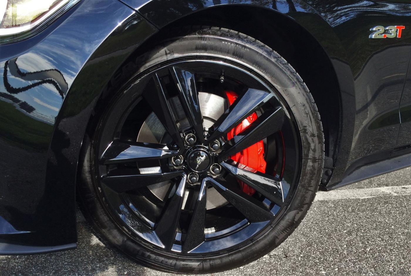

I just painted the lug nut recesses on my wheels, for the life of me I couldn't find black lugs, at the time, to cover that silver ring. I had my wheels off for winter so just taped them off and sprayed the recesses. 6 monhts later it's still good to go. Painted the center cap horsies, too.
