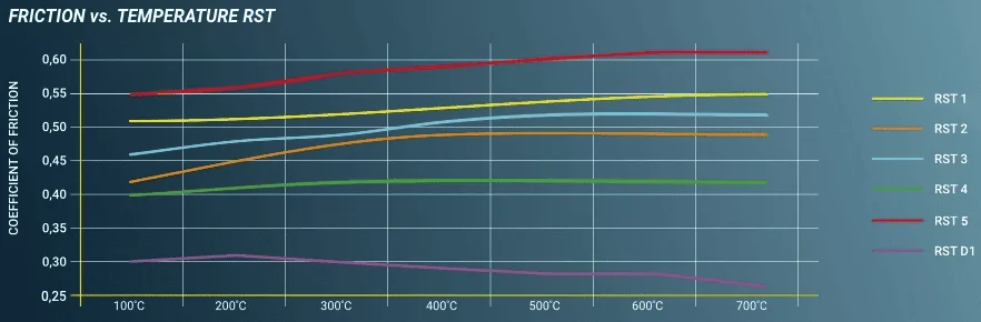

This is the Pagid pad options:
It's not uncommon to run any version of RST 1-5 on the front of a car with the RST D1 on the rear.
