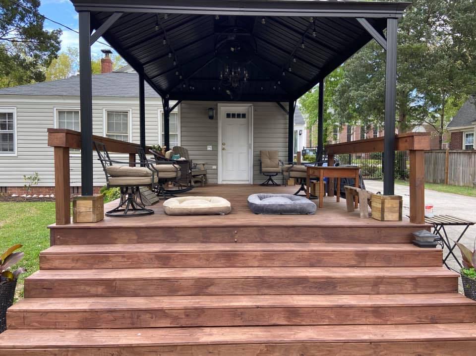

As the owner of a 12x20 treated yellow pine deck, we waited about 6 months to treat the deck (also have a 12x20 gazebo on the deck...so deck is more like 12.5x20.5).
We went through the oil vs water based and settled on water based. Then it was Valspar, Behr, Sherwin Williams, etc debate.
We settled on Benjamin Moore semi transparent called 'Fresh Brew" and it worked out great. Semi transparent allows some wood grain to show through Solid is like paint and will basically look like you painted the deck,
Has only been about 2 months so far so not sure how durable it will be but it looks nice. With water based you have to get everything on the wood quickly and the amount you want done quickly as going back over areas causes streaks. I believe oil you can put multiple coats over each other with no issues....but it is messy and smelly and harder to clean up.
Wife and I did this in about 3 hours on a Saturday including the rails and steps.

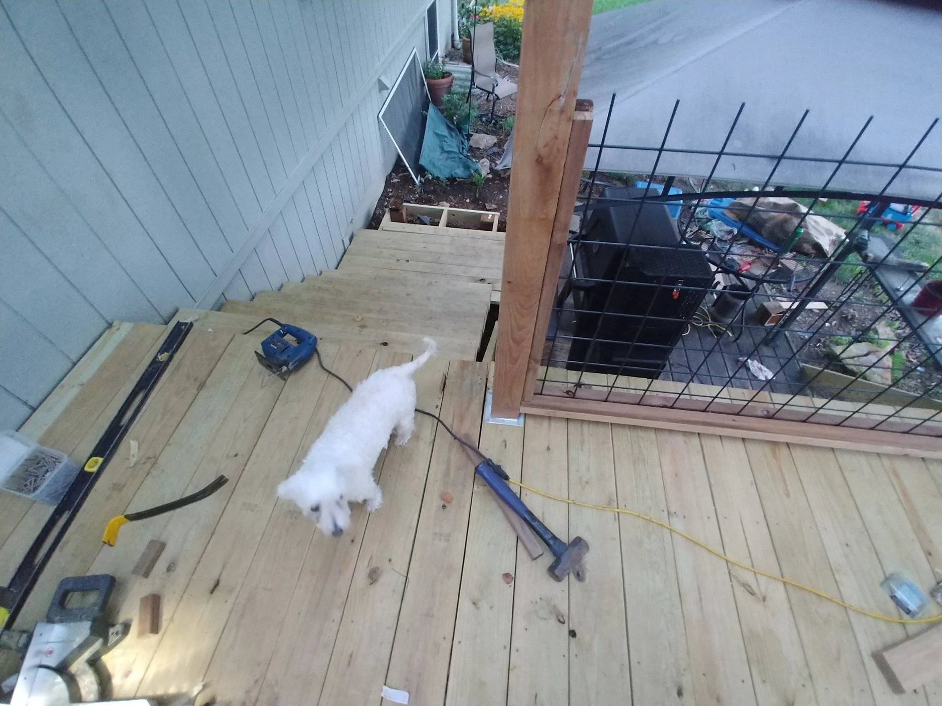

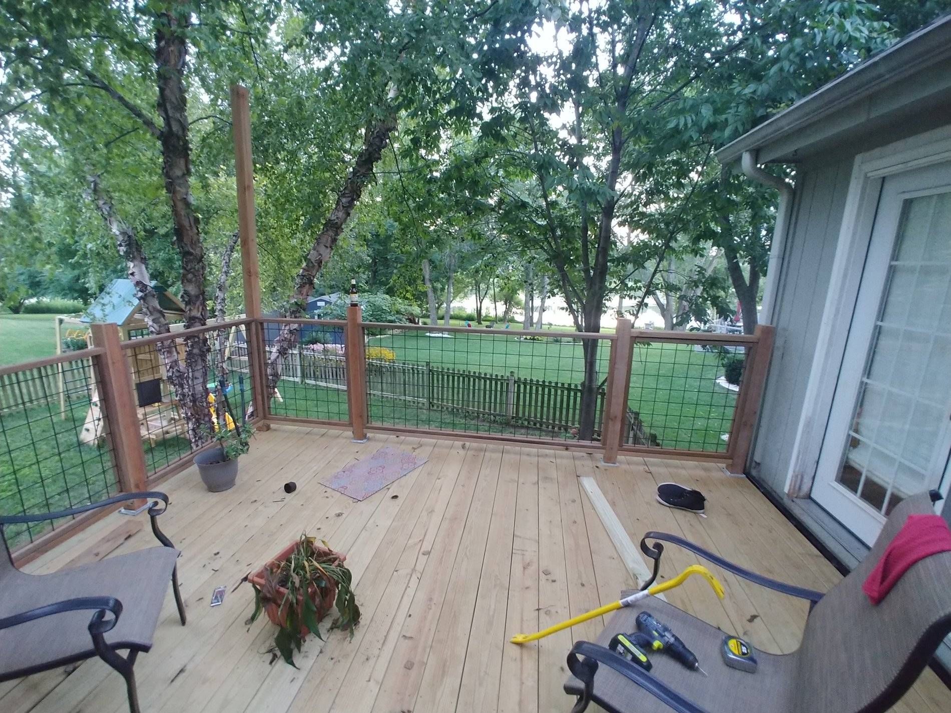

Deck progress.
Notice the improper tool in picture 1 vs the proper tool in pic 4. Just need to lay the last board against the house, add the drink rail amd lighting, and the last 3 boards for the landing at the bottom of the stairs. And 8 weeks later... the deck is done!!
Now I know why people pay other people to do this. But no way am I paying what deck builders want. $250 and up per square foot.
Ah well, ot ain't perfect, but I did it and bought stang parts with some of the savings. So win-win all around.

Looks good, looks like you might be using that yellow crowbar for an improvised cane. Cause I imagine you are feeling like that poor plant is looking.
samd1351
Sep 17, 2018
107
838
1,489
Olathe, KS
Sam
2017 Mustang GT, 1999 Ranger
Pretty close. Although the hard back breaking stuff is all over with. That lily is from my mother-in-laws funeral last month. My wife has had inside, outside, in the shade, in the sun, watered, not watered. It's just a happy plant. And the dogs pee on it. But if I set anything down on the deck and turn around, one will come pe on one side, and the other will come pee on the other side. I hate those damn dogs.
