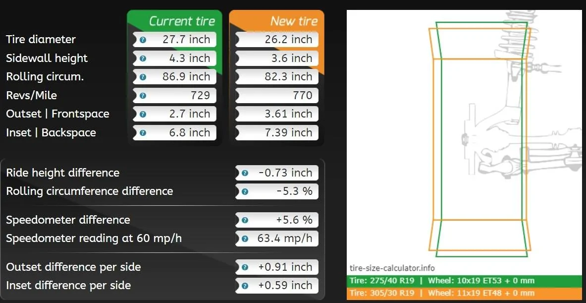

I never said they wouldn't fit. I did say that they would affect wheel track width and possibly handling. I entered the OEM PP1(green) and PP2(orange) into a tire calculator to show and calculate the differences in placement of a PP1 vs a PP2 rear wheel.
I entered
PP1: 275/40R19 19x9.5 +52.5
PP2: 305/30R19 19x11 +48
A picture is worth a thousand words.... They show that the PP2 wheel will have a wider track width with OEM vs PP1 wheels. the outset and inset differences show that the centerline will be displaced from PP2 stock.
I found a good thread that someone discusses the affects or changing wheel track width(https://www.pro-touring.com/threads/104856-Any-drawbacks-to-widening-track-width).
The next question is if the changes the PP1 make vs the PP2 will change the wheel track width as well and by how much and if the differential is maintained or changed. I suspect, the differential from front to back is different on PP1 vs PP2 when a PP2 wears PP1 wheels.

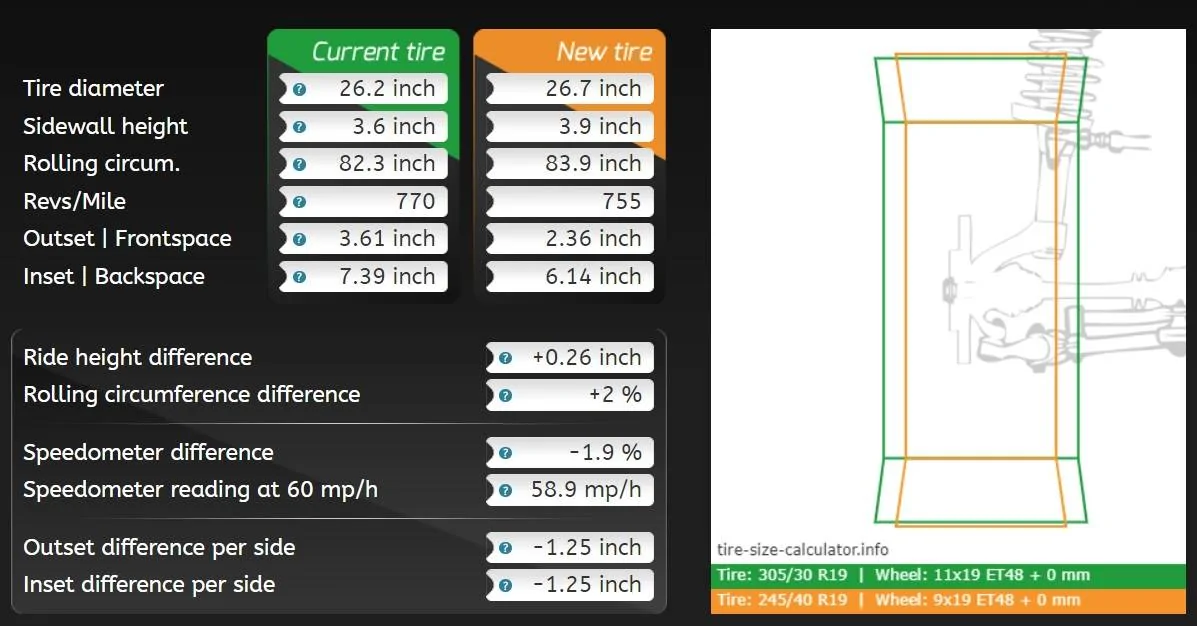

I entered a 245/40R19 tire on 19x8.5 rims to compare to the stock tire into the tire calculator.
Now, if you keep the same 48mm offset in the rear, using a 19x8.5 +48, these tires will sit 1.25" into the wheel well. The track width would remain unchanged (outset and inset are equal).
The same would be true if you got a 19x8.5 +24mm for the front.
Also, going with a 40 series tire(245/40R19) instead of the suggested 45 series (245/45R19) would keep the circumference difference under the desired 3% so that the speedometer is minimally affected (60mph dash reading would actually be 58.9). Going to the 45 series on a PP2, would result in a 5.3% difference in speedometer. A reading of 60 mph would actually be 56.8mph.
Of course, you can always have your speedo adjusted.
For winter, sacrifice a little idealism on speedo for ground clearance. Kinda the whole point of putting on snow tires is to ensure capability in snow, no?
And you've got it backwards: with the 245/45R19 you'd actually be going 60 mph when it indicates 57.
