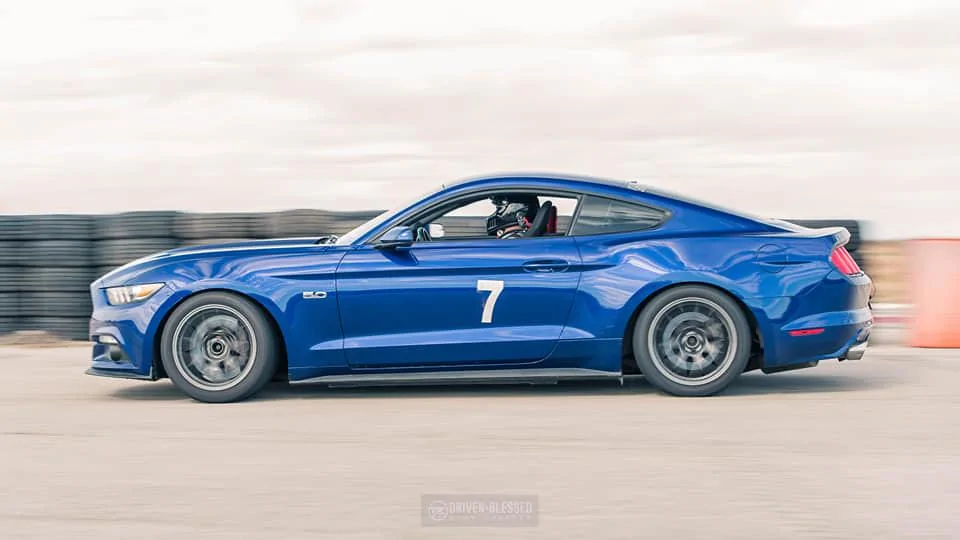

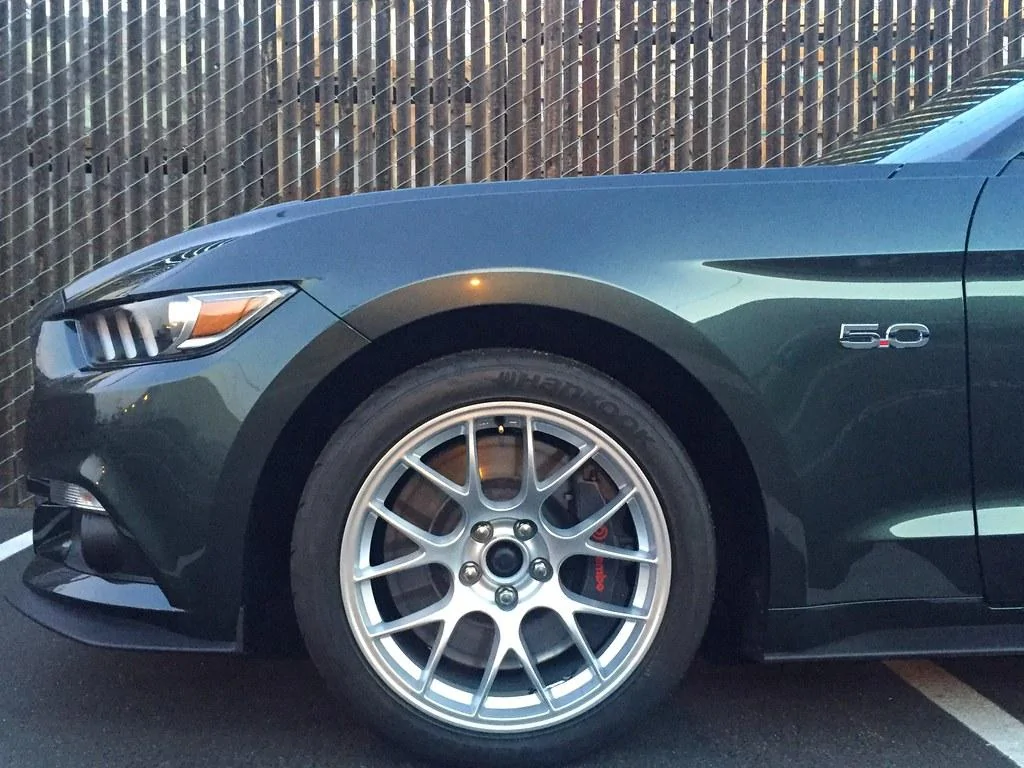

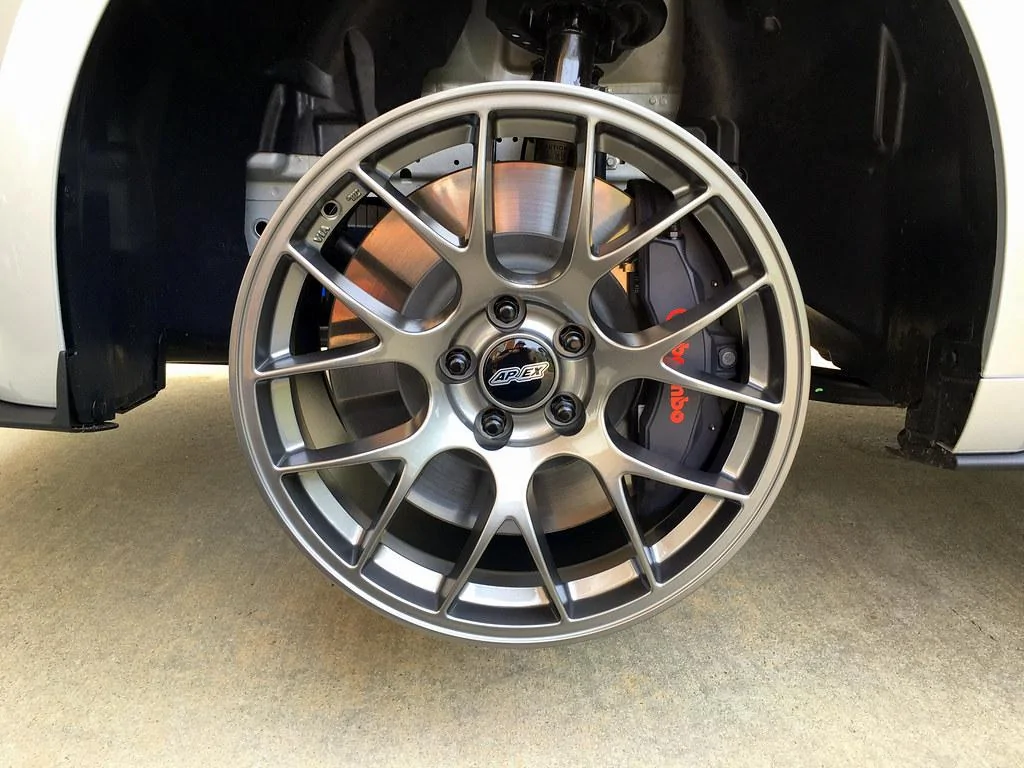

Our 18" EC-7 wheels do clear the S550 6 piston calipers without issue and open up a lot of great race tire options. Available in 18x9.5" ET35, 18x10" ET40, and 18x11" ET52. All of which can be ran in squared configurations.
