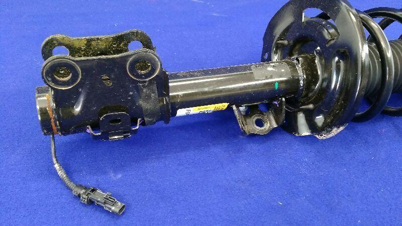

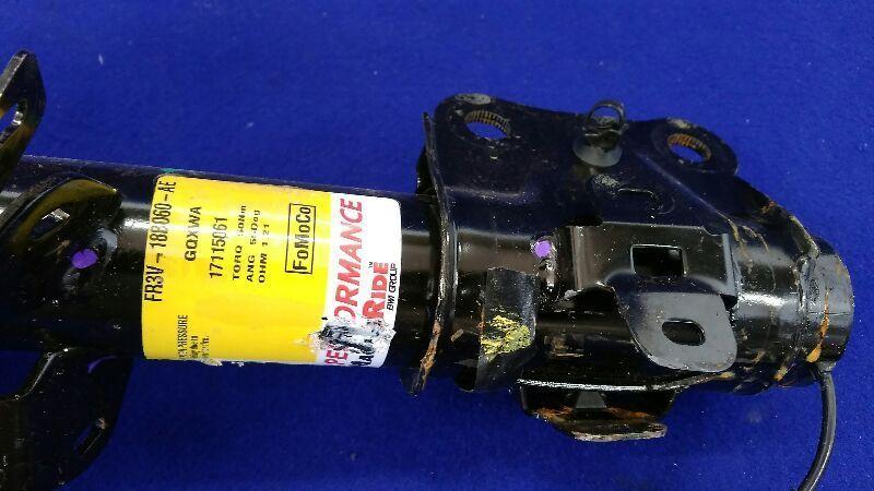

1. Magneride Cars:
Obviously, all PP2s are Mageneride-equipped In Magneride cars, the strut body appears to be a monotube design. (I can confirm this after switching wheels on my own PP2.)
These are from a salvaged GT350:

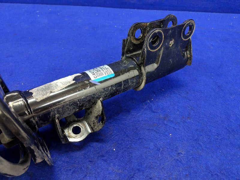

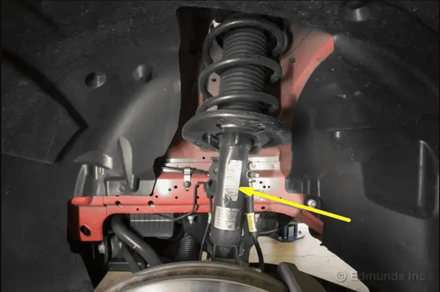

2. Non-Magneride PP1 cars: Appear to have a twin-tube strut body, evidenced by the the crushed portion, to allow for clearance of the wheel/tire. (Notice the Reflections/highlights on the tube body, and how they bend, indicating a non-perfectly round body).
First Pic from Edmunds.
Second pic is a Ford Performance Track Handling Pack strut.

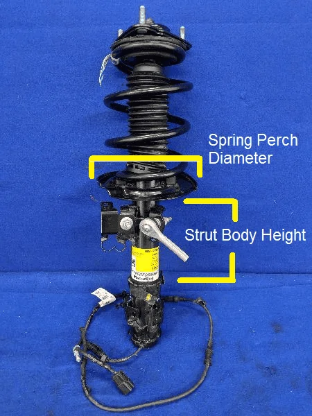

Strut tube height & spring perch size/diameter:
These two dimensions affect how close the tire will come to the strut body.
If the strut body doesn't have enough height, the tire hits the spring perch.
If the spring perch has too large a diameter, it can also contact the tire.
