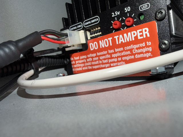

Just measured the pump on boost and it gives 18v, so thats off the list too.
It gives 12.28 (battery power) when in stand by, it gives the 18v when I connect the grey wire with earth (thats the proper way to test it according to the manual from jms) i think it is a jms p2020

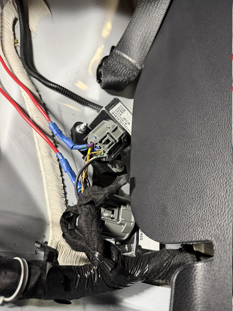

I have double fuel pumps and just measured and found that 1 is being boosted, the other isnt…that might be a thing…i measure at the same point in both of the connectors and 1 is getting 12v and the other gets the boosted 18v.
Still doesnt say why its lean on idle as I dont think it does boost on idle.

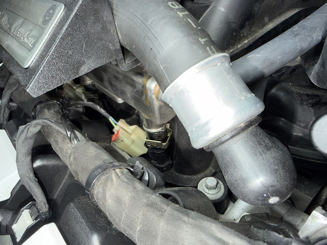

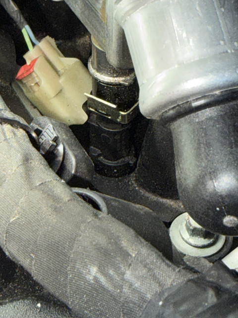

This gets better and better…when looking at these injectors I think these are just oem parts. On the invoice it said 1050x but no mention of a bap…think they changed their minds and just added a booster.
But that just boosts one pump it seems.
i read the bosch code 0280 158, so that should be the oem injectors (ev14)
wtf. Think I need to wire the booster correctly and ask for a tune without bap, but with oem injectors.
any way to confirm from the pic it is oem injector? Id1050 look to have more steel in sight where these seek all plasticy

Ok checked how the booster pump from jms should work, it is normal for the primary fuel pump to be boosted and the other one just oem 12v power.
so i think all is good and I just ask lund for a new tune with bap but for oem injectors.
Right?
Right?
… If you can confirm which injectors they are.
