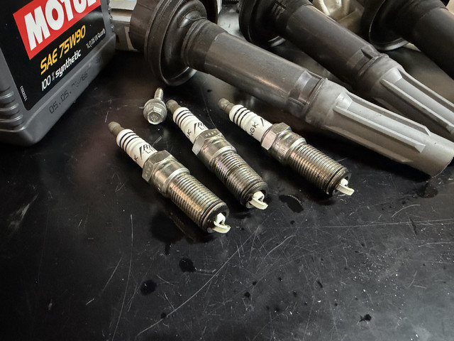

Picture of plugs?
This is a pic of 3 plugs after 40 miles, new ngk 6510’s gapped to 0,028.
The old ones where similar, hence the reason for changing and looking for a solution

You're lean. Really lean. Holy hell. Check fuel system. That's why you are +30 STFT...
