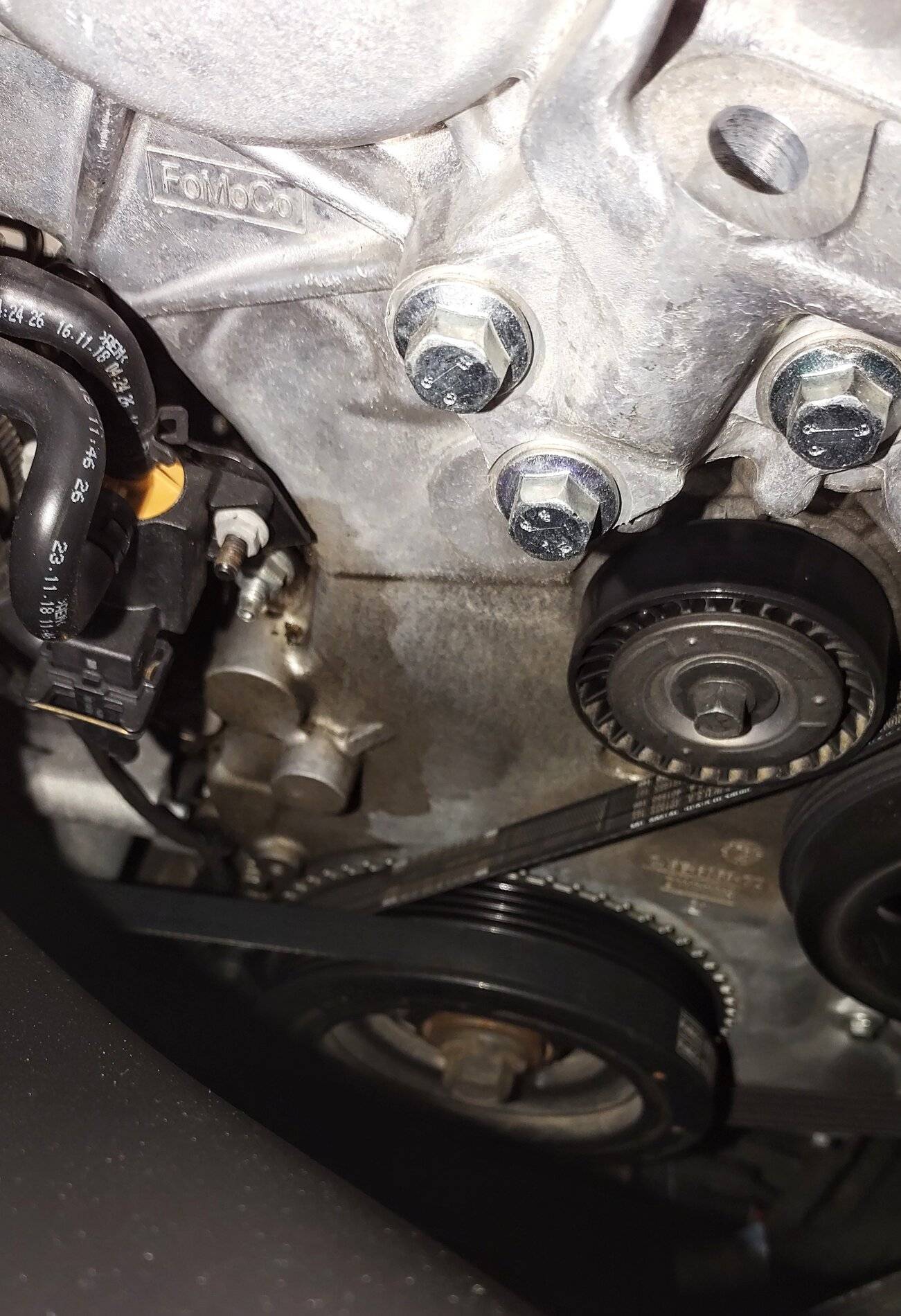

I just found this today. I couldn't see it in the garage so I'm not sure how long. I just happened to be looking at it with a friend outside today.
This is the turbo side of my 2020 Ecoboost. The oil cap and stick are on the other side. It appears to be all over that side. Nothing much heavier than a film. It doesn't appear I've lost much if any oil in 2.5k miles. I need to look a little closer at what I'm looking at. I'm not familiar with this block yet.
Anyone know about a known issue like this. Luckily I'm under warranty, but kind of surprised.

There was a similar leak on the early 2015-2016 EB's. IIRC, I think it's due to 1 or more of the bolts in your image that go through the front timing cover. There was a TSB for the 2015-2016's where the fix was to pull the bolts and apply thread sealer and re-torque to spec.
Take it back to Ford Service Center, it's under warranty and will be repaired free of charge.

Yeah ford is hit or miss with front timing cover sealing quality. Spans many models. Unfortunately more common than it should be.

Looks like you might need to make a trip to the dealer. Hopefully you're under warranty. I've seen this before on these cars so it's not abnormal.

My 16 had this same issue, took it to the dealership and they replaced the timing cover gasket and something else I forget but they forgot to readjust the timing correctly and so that ended up burning out my cats. In any case all replaced under warranty.

Ditto, it's not uncommon. I had the same leak on my 2016. Luckily, killed 2 birds with 1 stone as they ended up replacing the block due to another common issue: head gasket.
