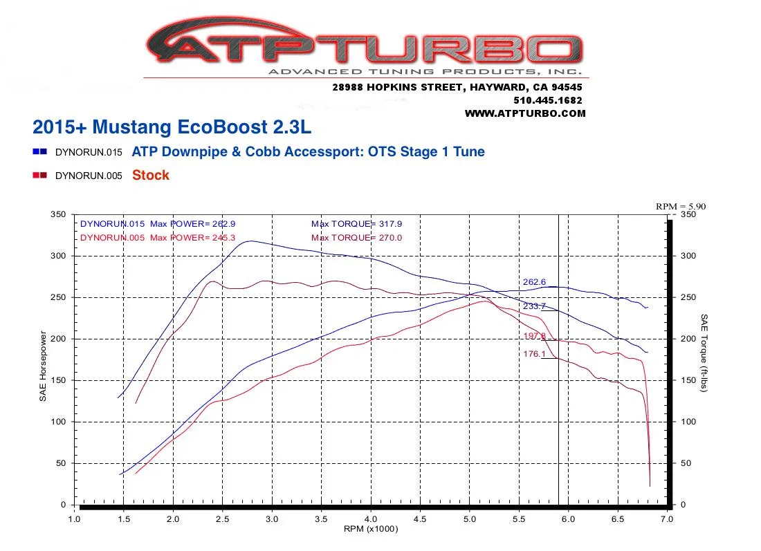

Does no one else not see a weird thing with 100 hp at 6000? How is it more than peak? lol, they are saying 420 hp at 6000 rpm? Makes no sense
I haven't looked at a stock EB dyno in a while, but it's because at 6k on the stock tune it's well past its power peak and power is dropping off a cliff. So it's easy to show a huge gain there. Peak to peak is where you can total power gains against each tune.
Yea but peak is the top or most correct? So if peak is 30/70 how can you get more? Isn't that what peak means? The most?

Again I ask not to patronize, but to actually understand
