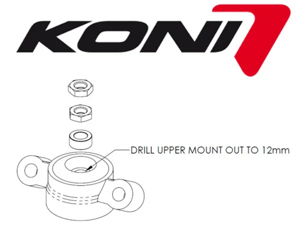

Thanks to the excellent support from Steeda, I got the correct installation information for the shocks. I for one, will be fixing my installation. :eek:
The correct assembly order is:
Damper body
Nylon washer
Bump stop
Dust boot
Rear damper mount
Koni provided spacer
Jam nut 1
Jam nut 2
I also got this pic:

I wonder if using a half inch bit gives too much slop (.7mm). I don't think I've ever seen a 12mm bit. I might have to special order one or check Grainger.
I used a 1/2" bit and not looking back. ;)

THANKS jbailer. I will be fixing my install as well. I might go ahead and add a washer on the bottom mount also, as a little extra precaution.

I don't think they will be messing with the shock any, however, they may include a modified upper mount in the kit or a 12mm drill bit. ;)

Which kinks are you waiting to get worked out? The only thing was the lack of instructions but we have those now. I'm sure modification of the upper mount will always be needed unless they start providing it. I'm sure if they provide the upper mount it will make the kit more expensive than if you bought the mounts from Ford and drilled them yourself or just drill your current mounts. I never plan to put the stock shocks back on the car. If I ever did, I would buy a new set of shock mounts as they are normal wear items anyways. Personally, I think we're all set.
edit: Plus it will always need to be modified because this is an adjustable shock so the rod needs to be thicker to get the adjustment rod inside.

They will not. Reason for that was clearly stated and the part you need to modify is an easily replaceable wear item.

Still cannot believe that Koni is asking their customers to modify the upper mount. Oh well it is what it is. You would think they would supply the upper mount to make this plug n play. I do have drill and the bits and I will drill if by the time I get these they have not supplied upper mount with their shocks.
The way I look at it, the upper mounts are cheap for us to buy. If they have to buy them and modify them for us, we pay them to do it, it will drive the cost up. My labor is MUCH cheaper and it's very easy to do.

Cost me like $17 each before shipping :shrug:

They mass produce these. Cost would be higher but not that much more. Some of us just want to open a box and install. I will call them next week. This is on my list but not within the next 2-3 months. I also want to give Bilstein a call to see if they plan on producing for us. For now the Ford racing is ok nothing special but much much better that the stock crap PP suspension I had.
