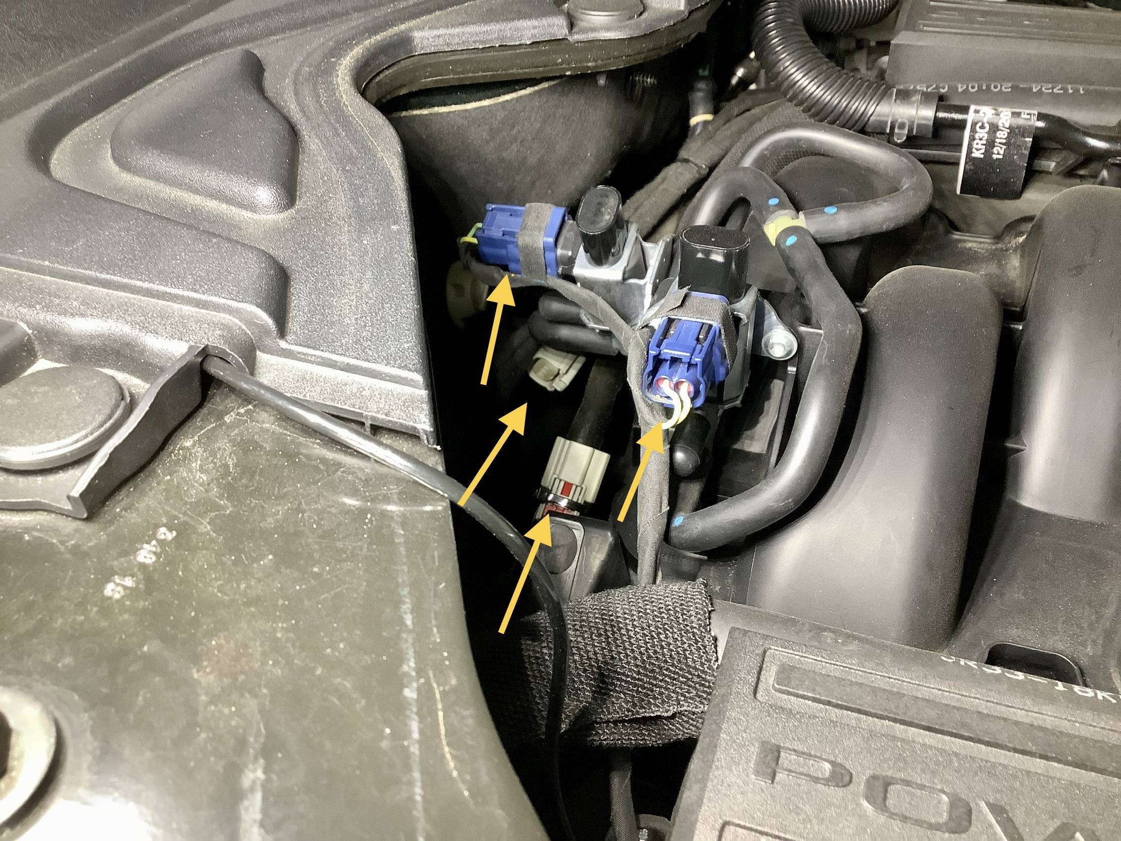

Are your IMRCs locked out? If so, did you secure your electrical connectors with zip ties, so they don’t rattle? They’re in close proximity to the knock sensors and could very well be the cause of false knock. I plugged up two of the connectors and zipped the other two to the clutch line and a wiring harness.

Yessir I actually did this because I found you providing this guidance in a previous thread (thank you!). I’ve got the sensors capped and zip tied to the wire loom against the firewall. Appreciate the suggestion though!!

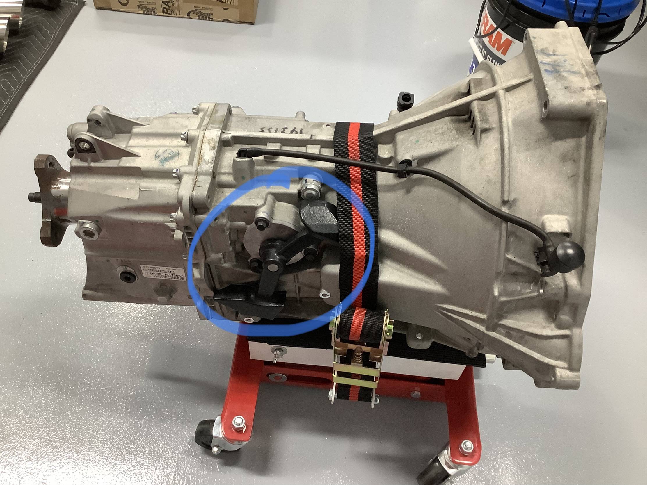

Another culprit could be the counterweight on the right side of the transmission. You said the knock occurs during shifts and that weight rattles like crazy.
If you can, slide up under the car and wiggle the weight and you’ll be able to hear how bad it is. Rattle on the tranny which is transferred to the engine where the knock sensors sit.
