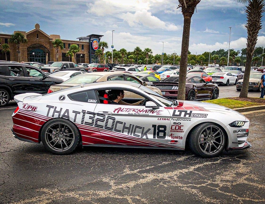

This is my wife’s car on 082 rears with 089 fronts after we added the whipple. We had the standard BMR drag springs and swapped them after the whipple because the front settled another 1” or so from the standard drags
